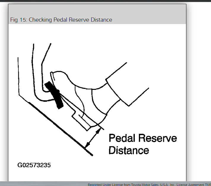

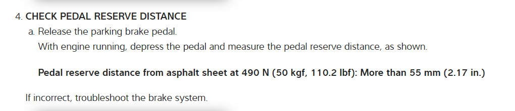

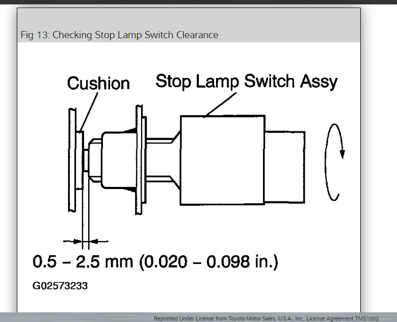

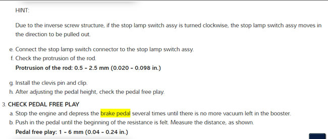

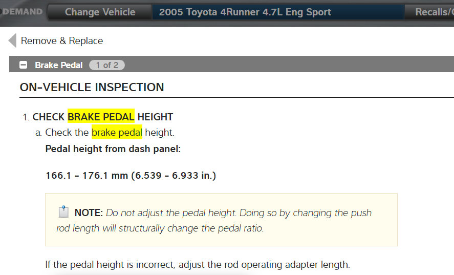

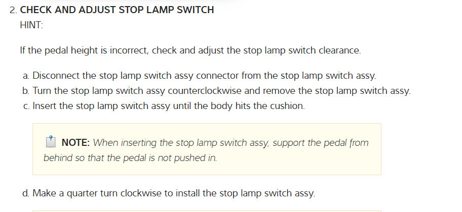

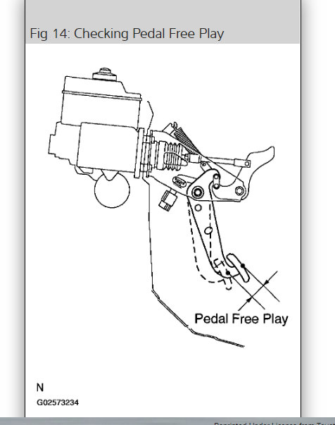

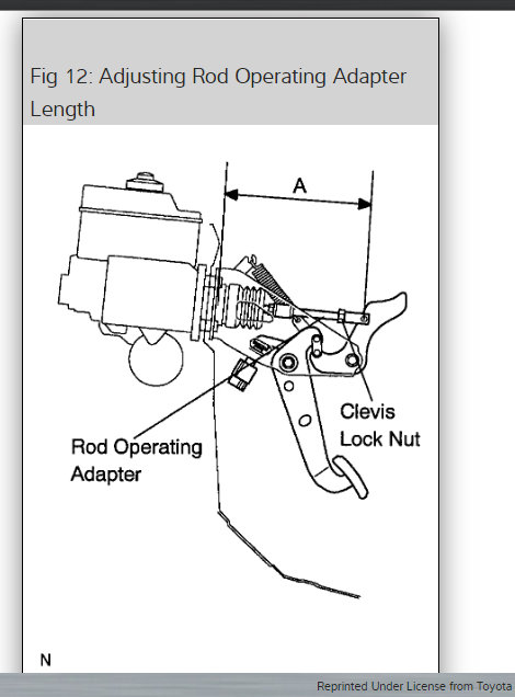

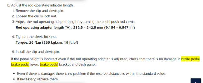

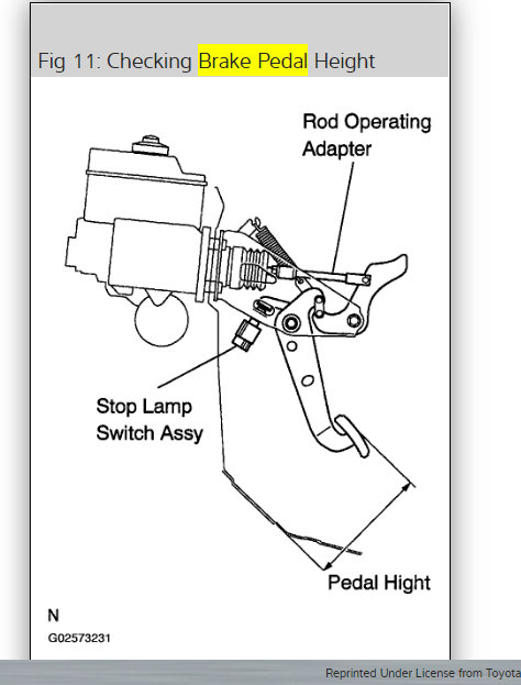

Hello again,
This could be a problem with the height adjustment on your brake pedal. In the diagrams down below I have included the directions on how to test and adjust the brake pedal on your vehicle. please go through the guides down below and get back to us with what you are able to find out.
Thanks,
Alex
2CarPros
