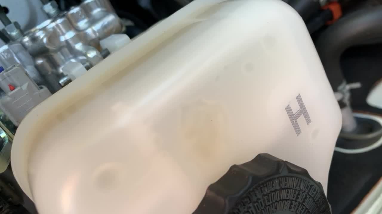

Had master brake cylinder assembly replaced, brakes work better but not as good as before master cylinder failed. I noticed that when the car is parked and engine is off the brake pedal never gets firm after pumping it down a few times, no gradual pressure from each pump instead after about 4 or 5 pumps the pedal gives in to the floor. Here is a little video of the reservoir while pumping the brakes when the engine is off not sure if the burps/gurgles are normal or not. Also the first few presses sound like a bike pump but when the pedal gives in to the floor the burps and bike pump noise stops as well...
Jul 26, 2019 at 6:11 PM
AKAI
Sorry, here is the video:
Jul 26, 2019 at 6:16 PM

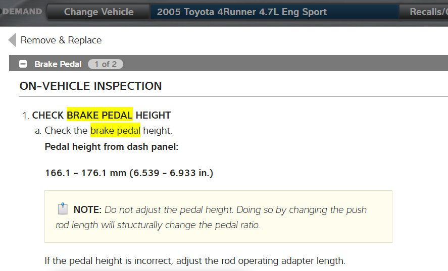

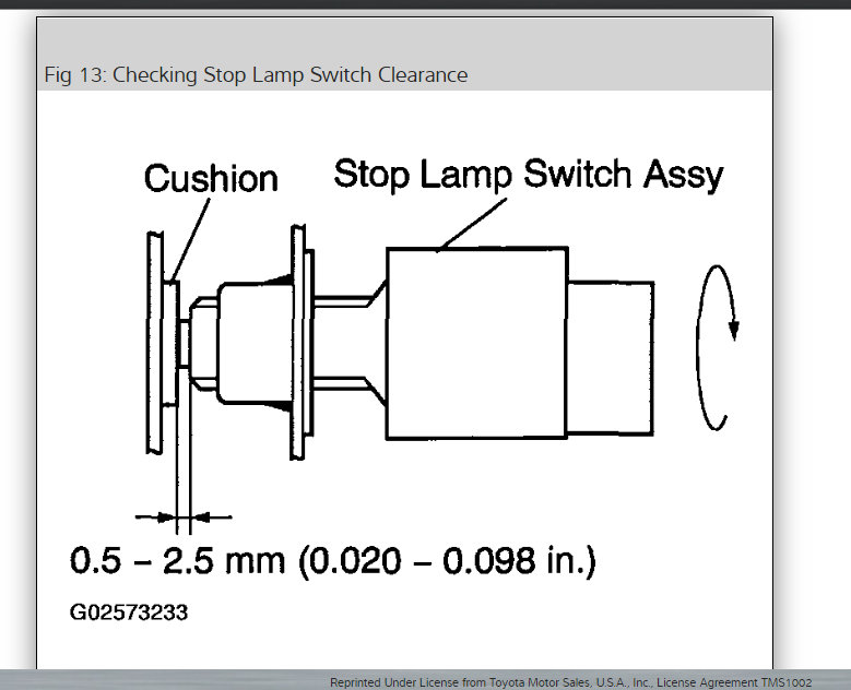

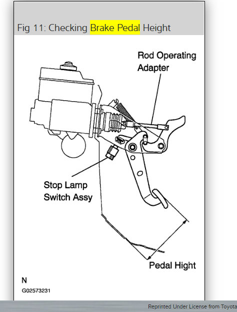

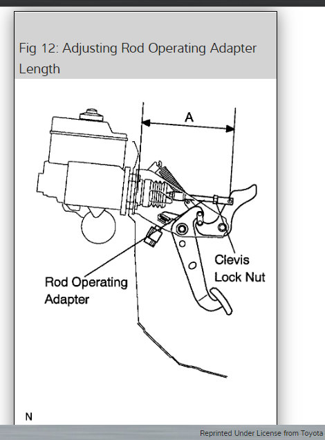

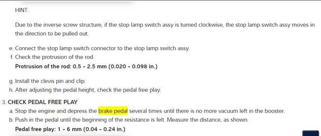

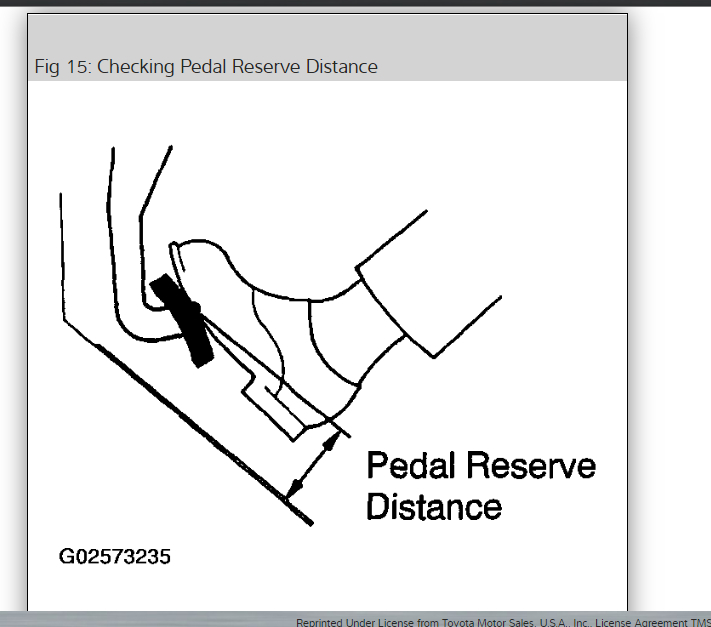

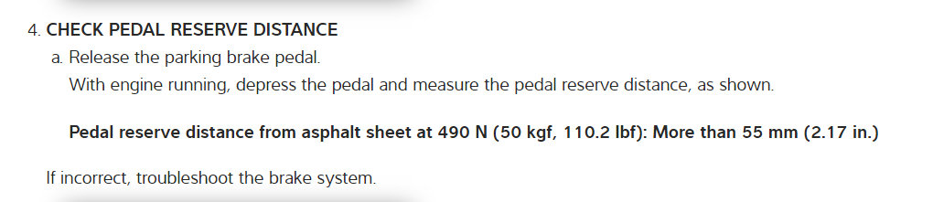

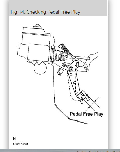

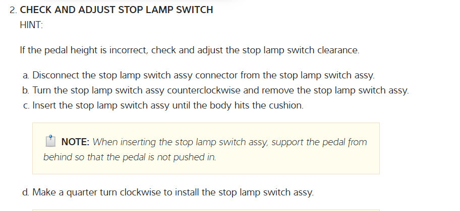

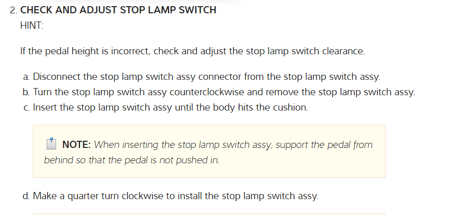

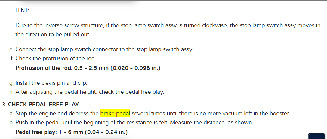

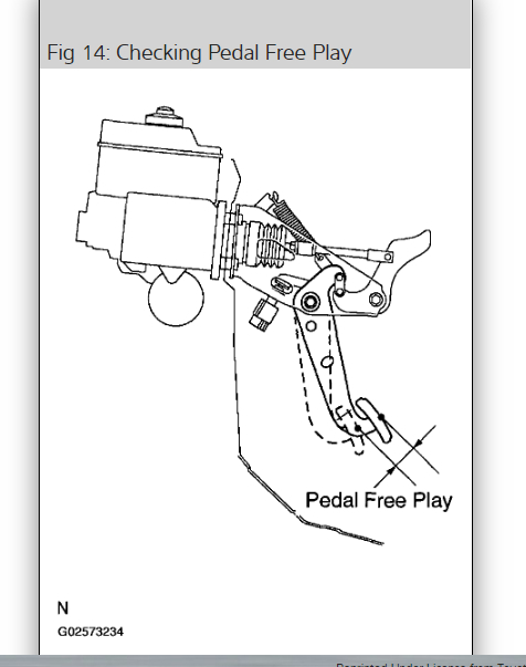

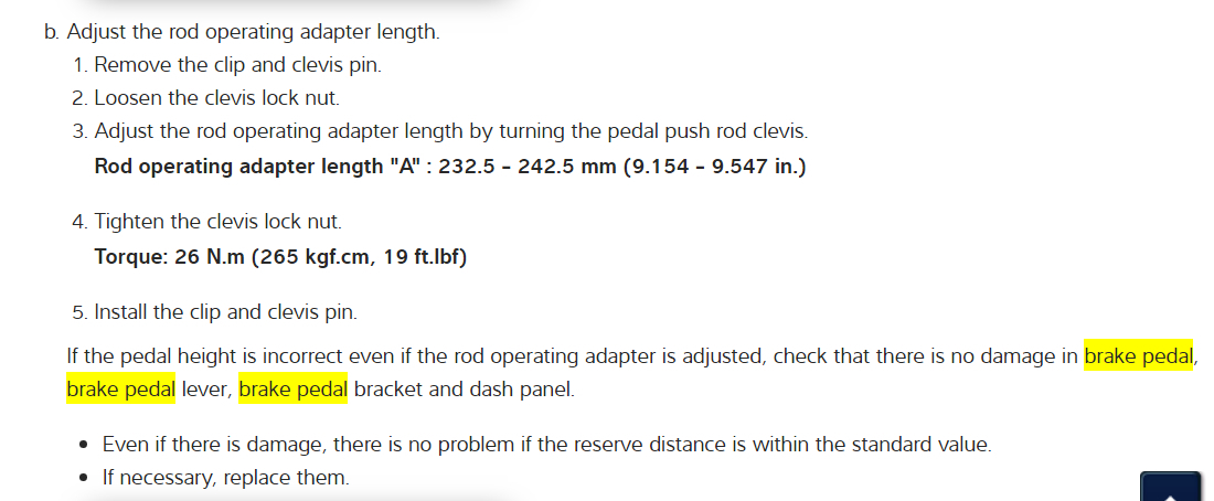

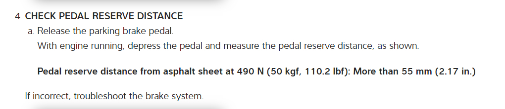

Hello again,
This could be a problem with the height adjustment on your brake pedal. In the diagrams down below I have included the directions on how to test and adjust the brake pedal on your vehicle. please go through the guides down below and get back to us with what you are able to find out.
Thanks,
Alex
2CarPros
