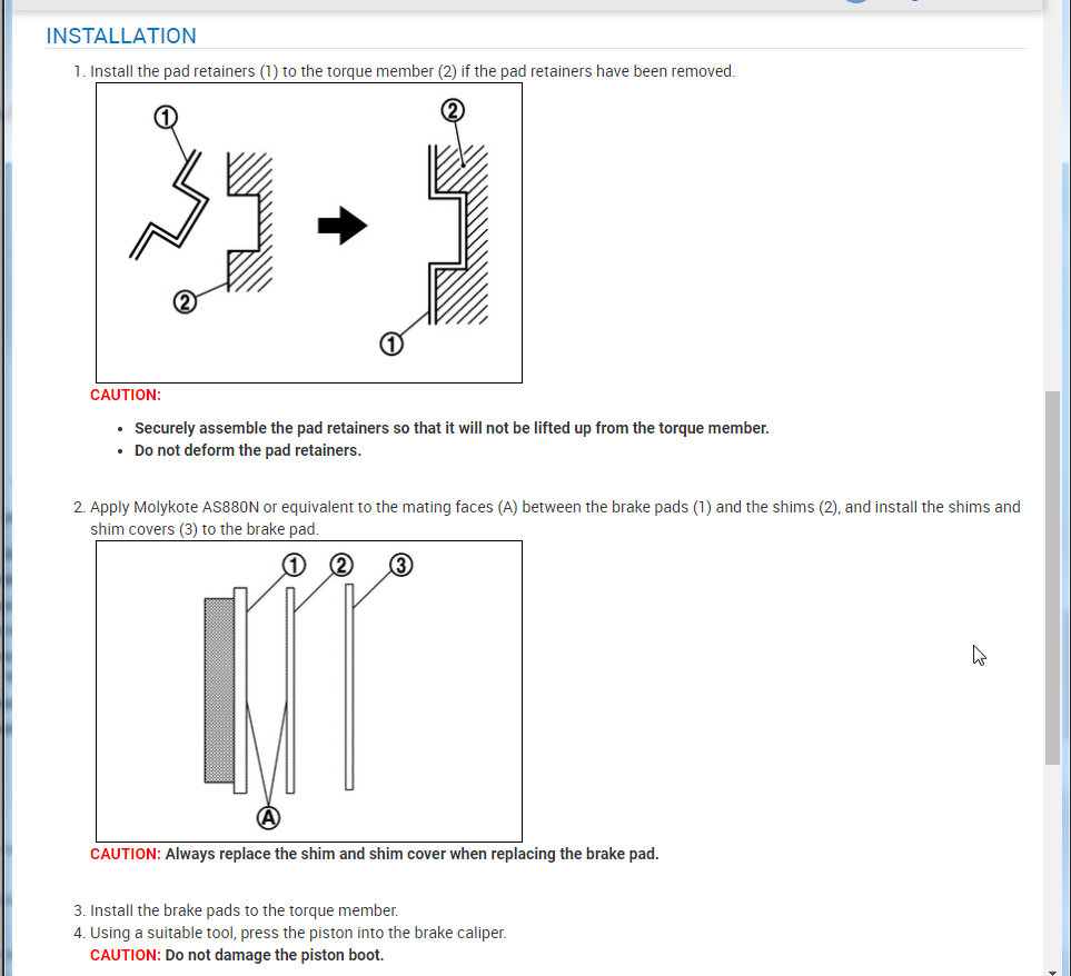

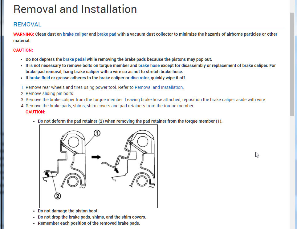

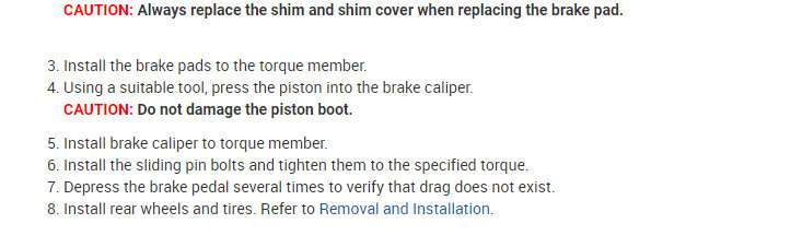

The brakes seem to work but you have to push the pedal just about to the floor in order for them to engage and start slowing the car down.
Jul 25, 2019 at 11:52 PM
No problem. Here is a guide that will help with this:
https://www.2carpros.com/articles/how-to-replace-rear-brake-pads-and-rotors
Below you will find the process from the manual that will help with getting the brakes finished. Let us know if you have questions. Thanks
