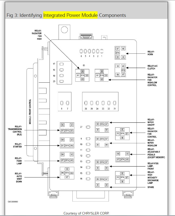

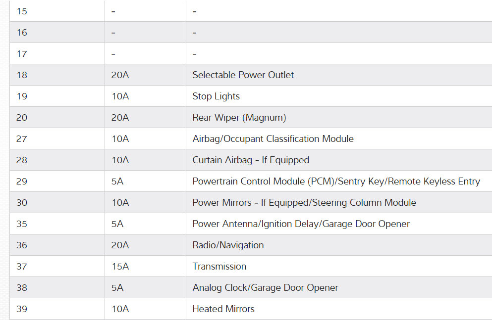

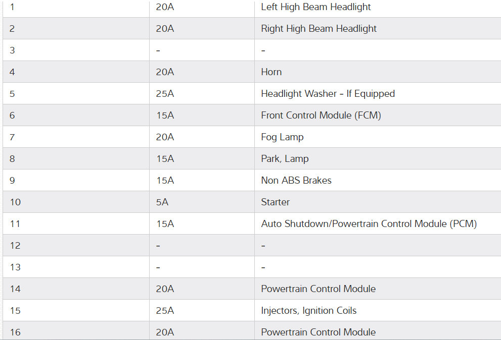

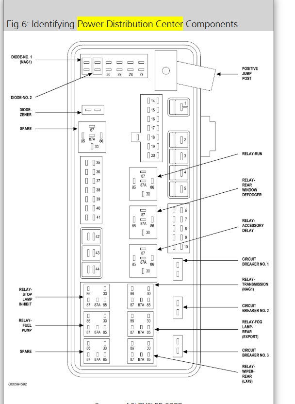

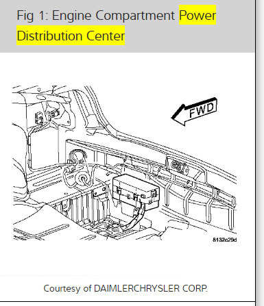

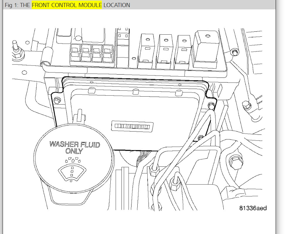

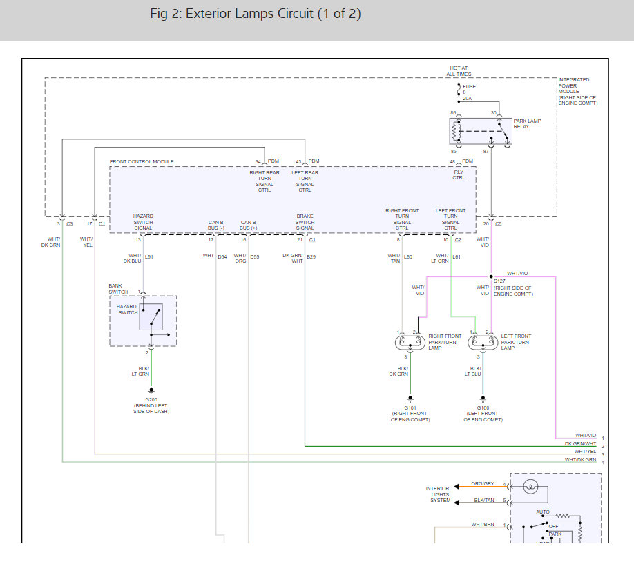

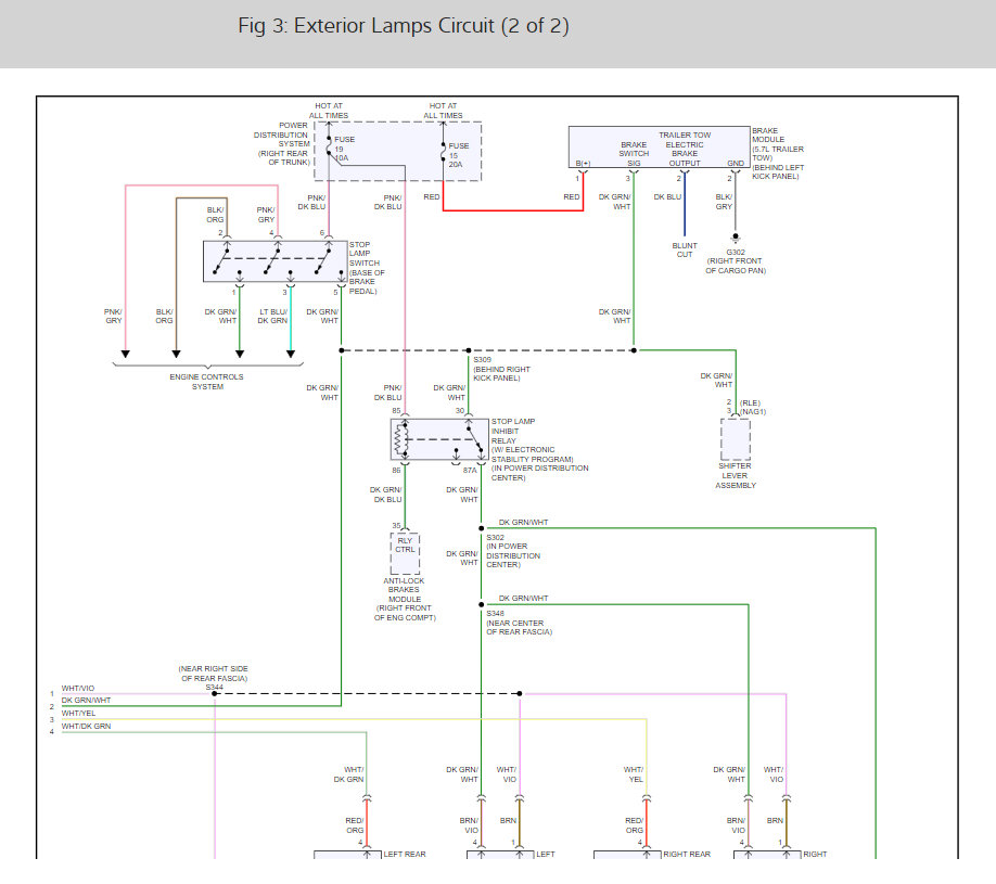

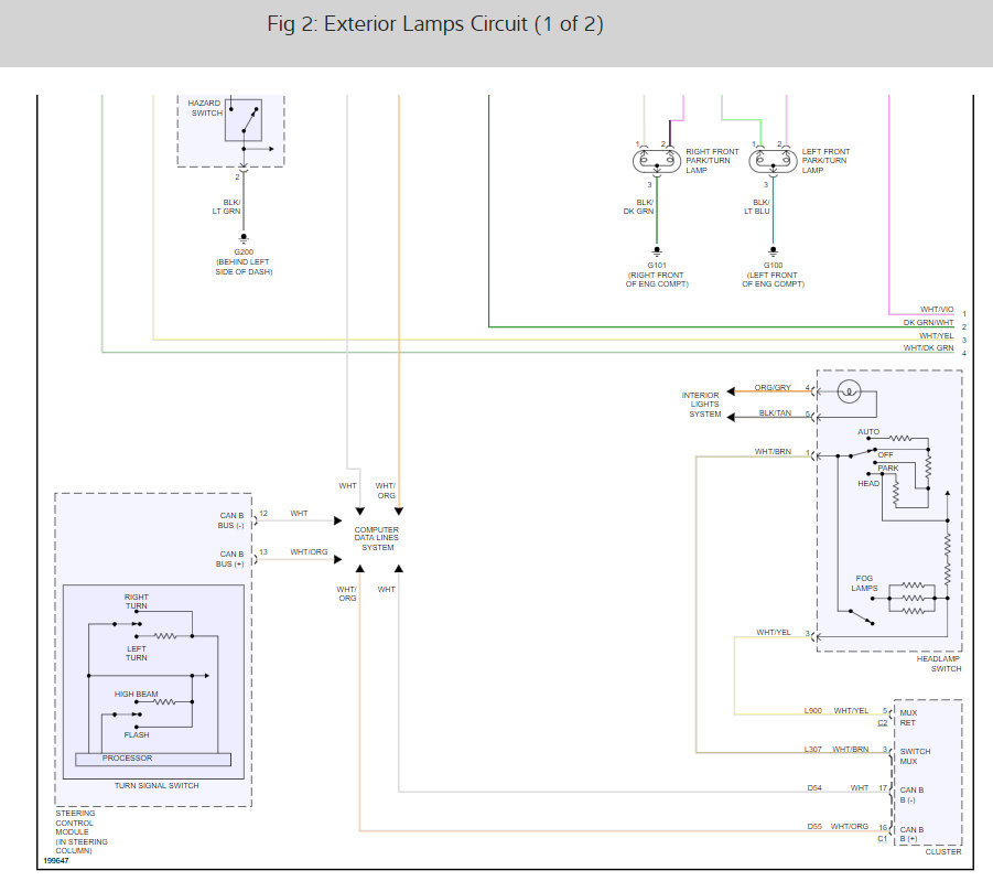

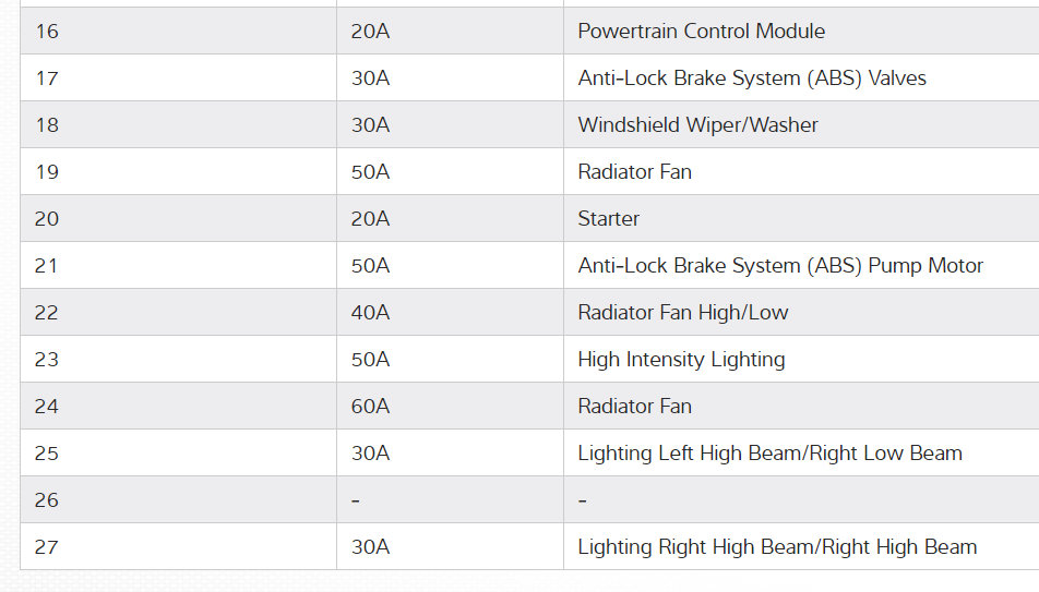

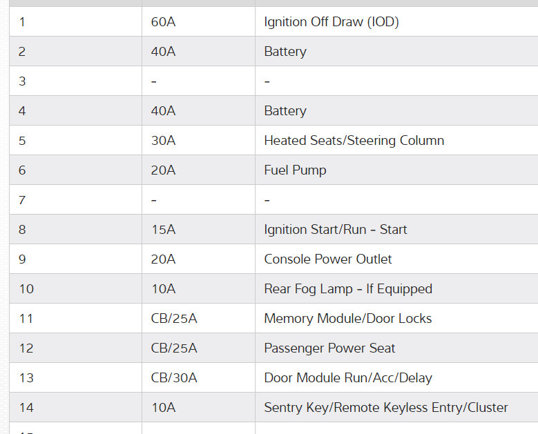

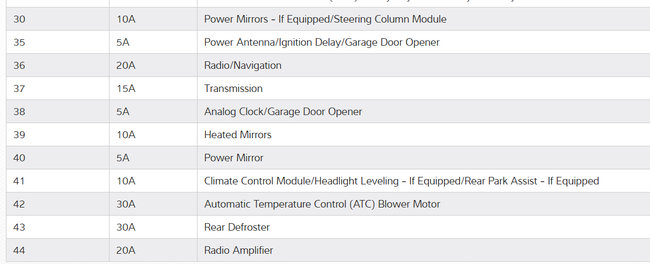

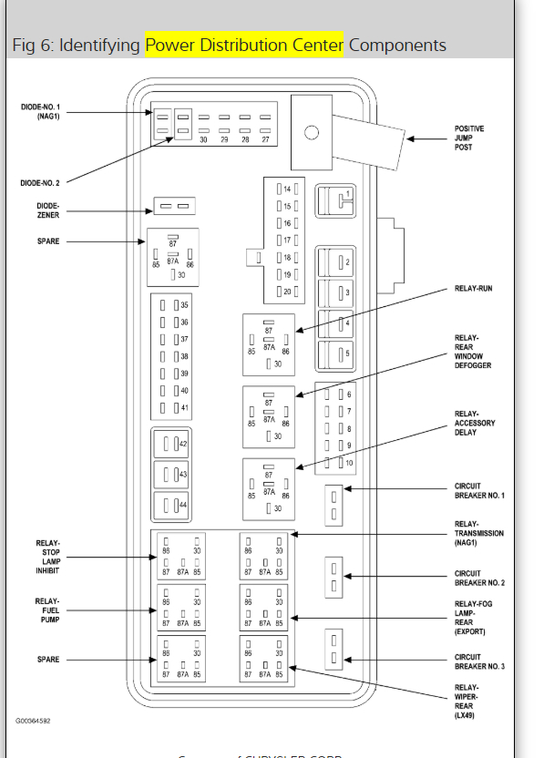

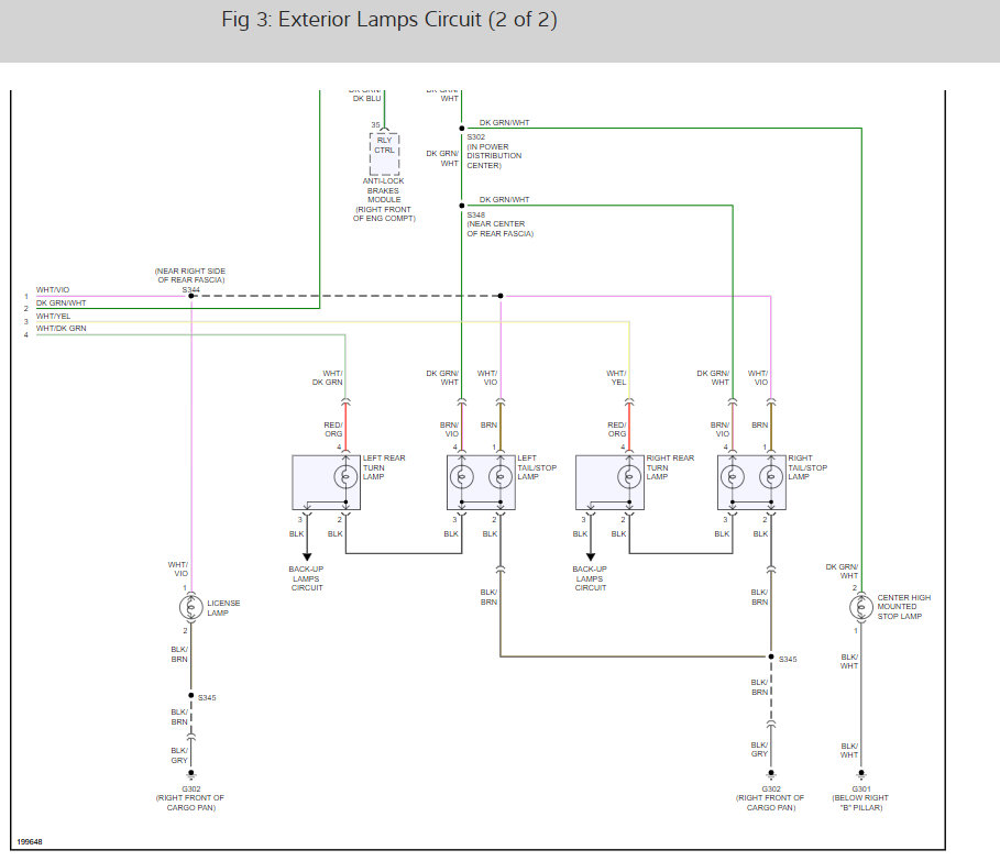

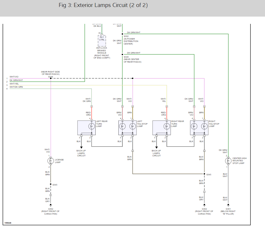

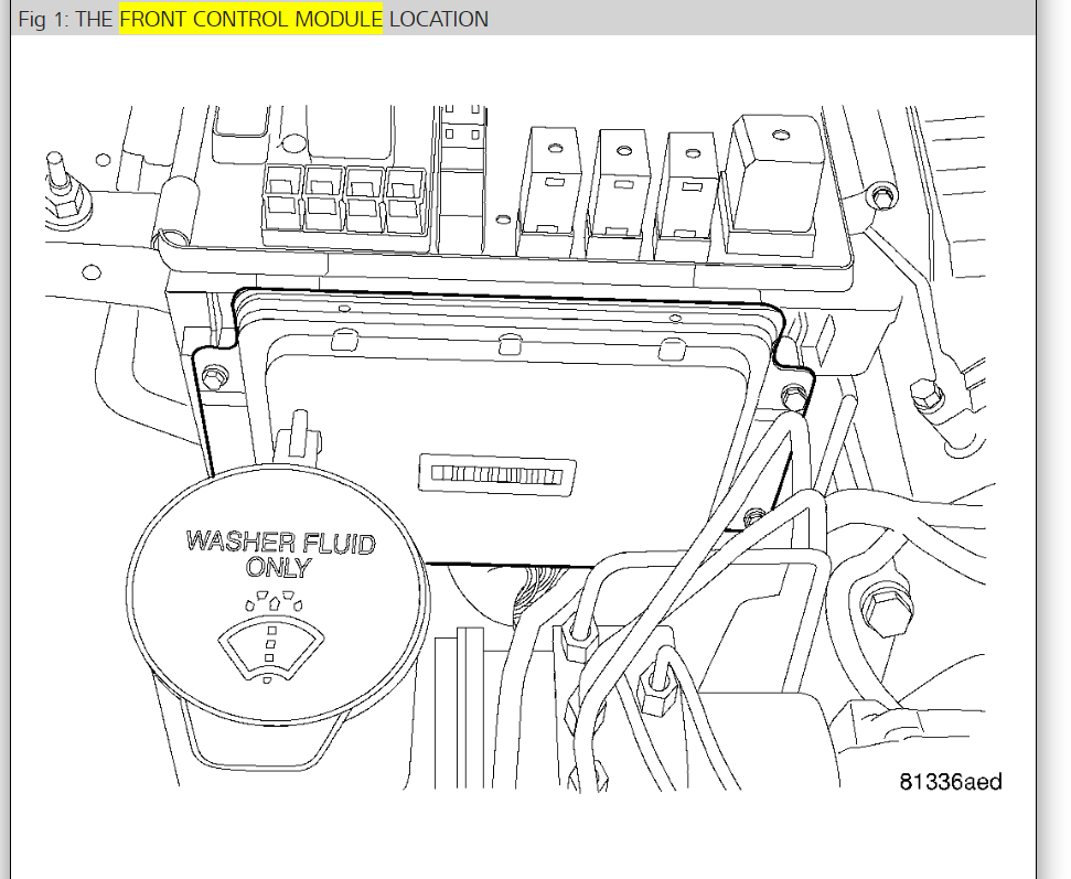

At first I had only the park light working, but no brake light, replaced the bulb. now no park/brake light on the driver side rear. The passenger side works fine. What could it be, wouldn’t a fuse operate both lights? I’m confused. also I’m not real good with electrical or diagrams. So explain it as if you were talking to student for the first time.
Jul 20, 2019 at 2:00 PM
  • 55,808 POSTS
It sounds like you have a front module that is out but to be sure here is a guide to help you test for power and the brake/running light wiring diagrams so you can see how it works and which fuses to test. I have also included the fuse locations as well.
