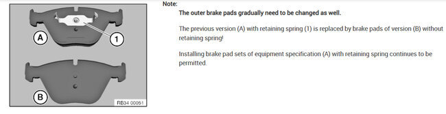

Textar, ATE, and Jurid are commonly used also Akebono Euro Ultra-Premium

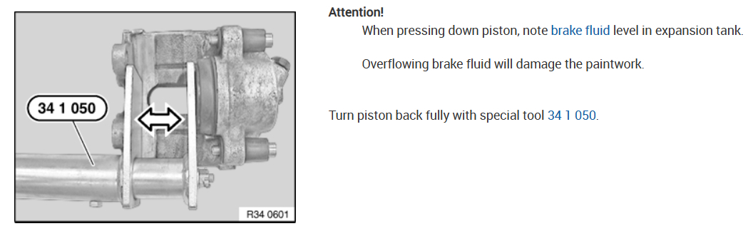

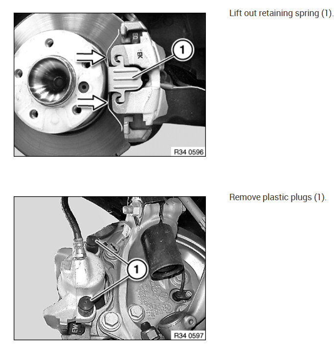

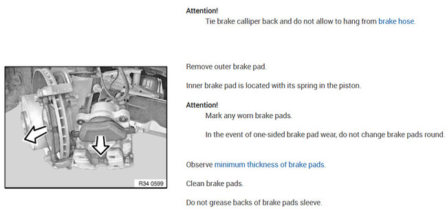

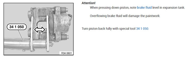

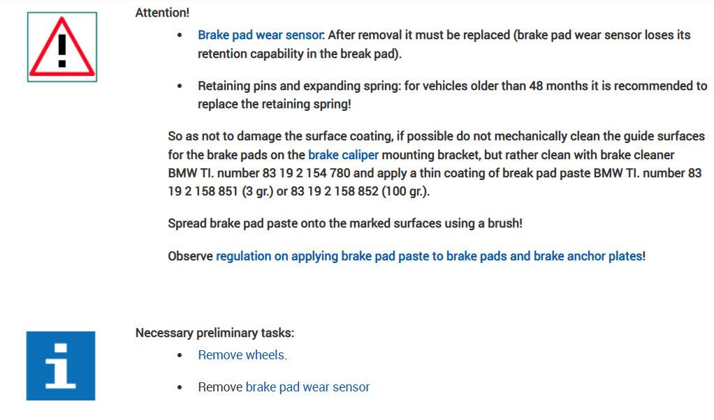

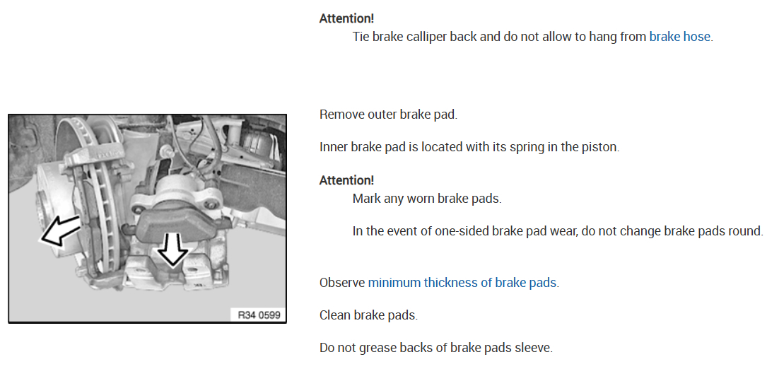

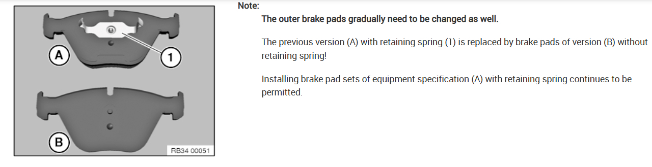

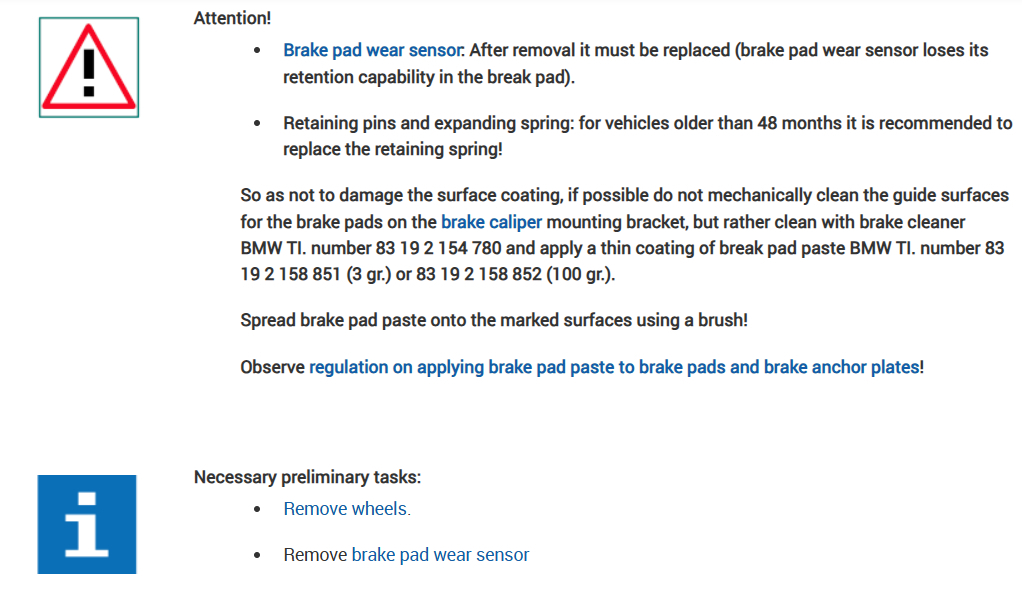

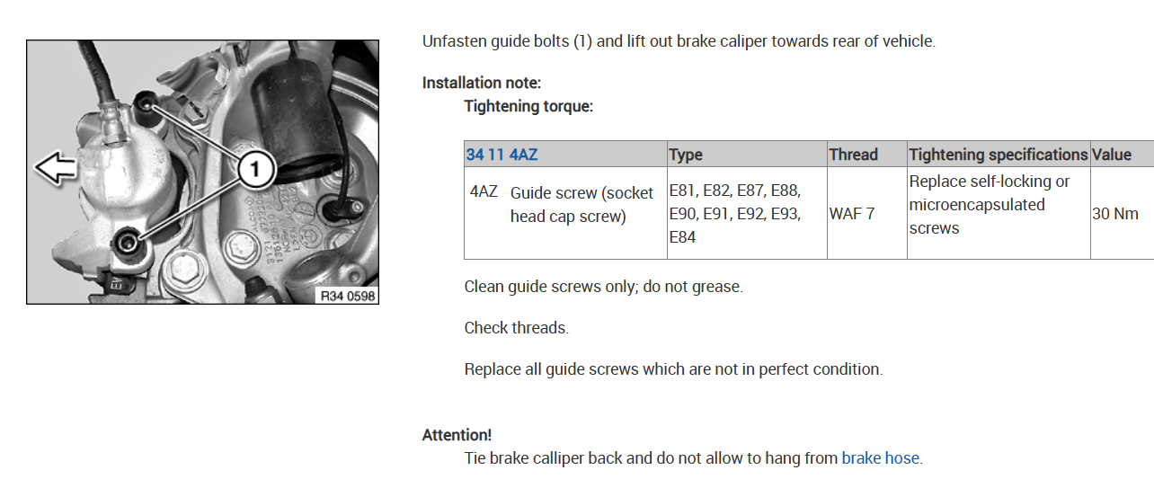

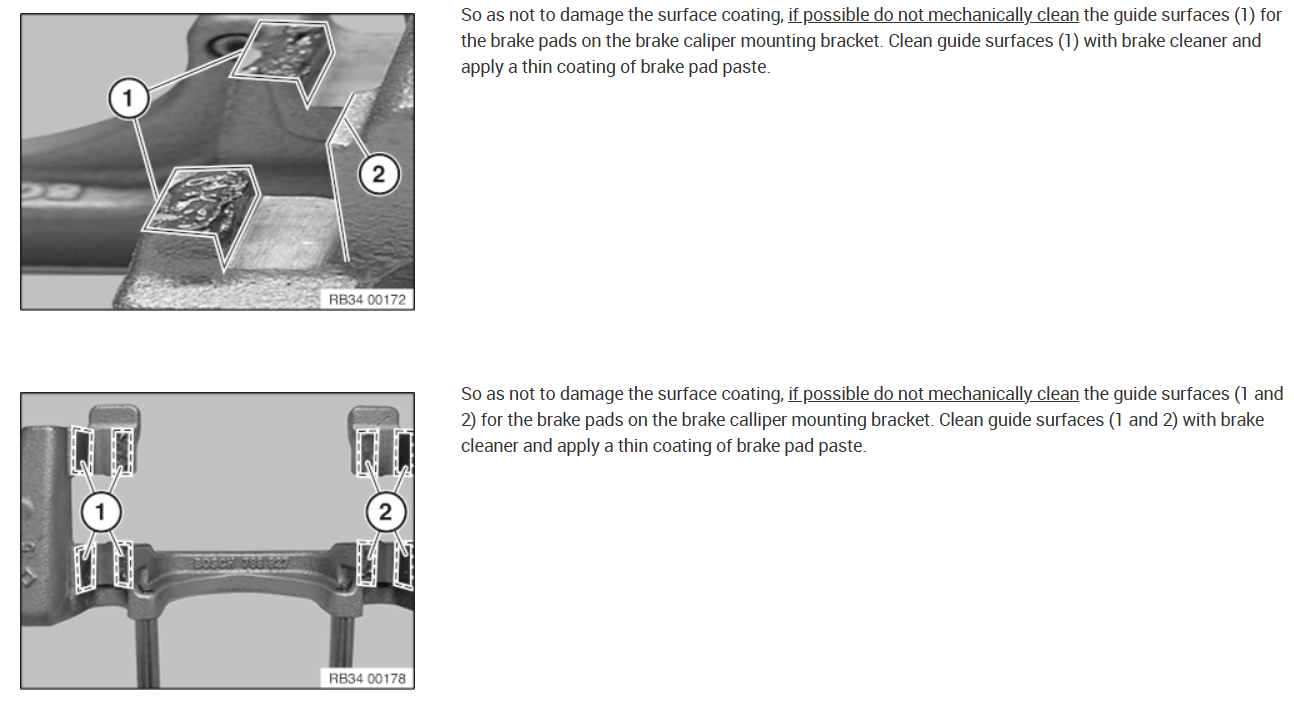

You will need to measure the brake discs to see which system you have if you don't know already. Here is how the brake job is done in the images below. Here is a video showing how to reset the brake calipers:
https://www.youtube.com/watch?v=FWmeHjodmx8
The front and rear brake job is super similar so if you can do one you can do the other.
Please only do one tire at a time so the brake caliper does not get blown out on the opposite side. Check out the images (below). Let us know if you need anything else.
