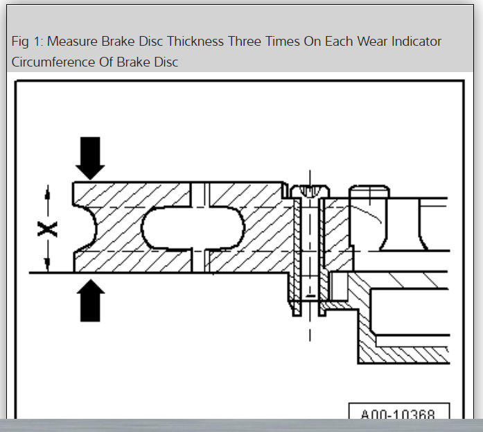

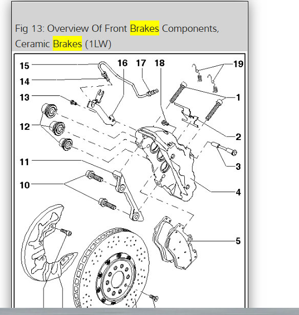

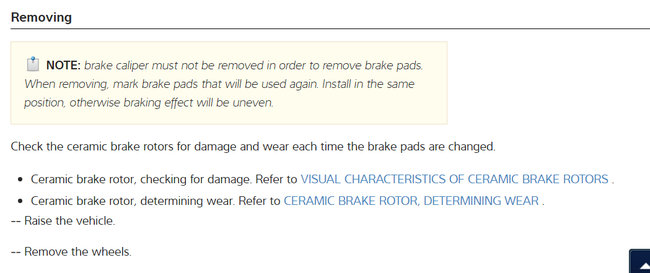

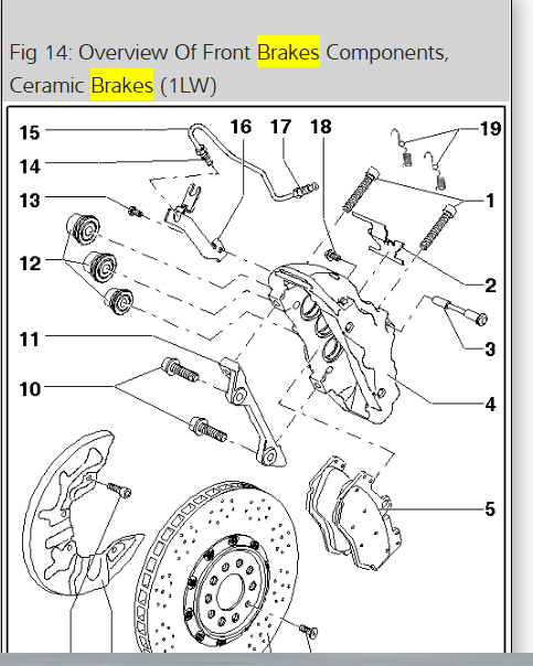

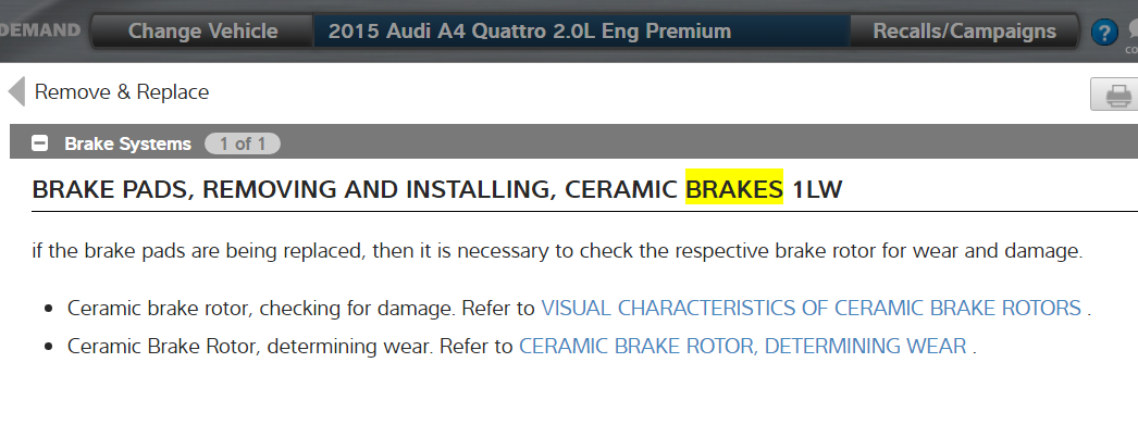

Can I change the brake pads myself or does it need a garage for the electric hand brake?

You can replace it yourself. We can even send you instructions to test and replace it if necessary, but is your vehicle still under warranty? Please get back to us and if it isn't we will send you the information right away.

Yes, please send instructions.

No my car is not under warranty and yes could you send me instructions to change front brake pads so I don’t need a laptop to take electronic hand brake off. cheers

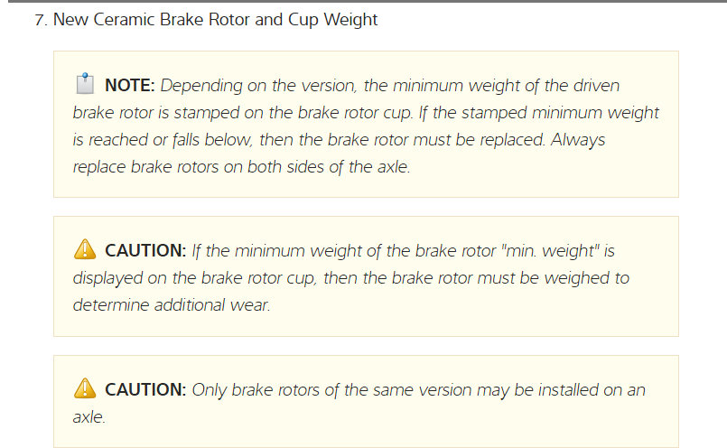

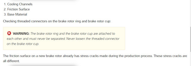

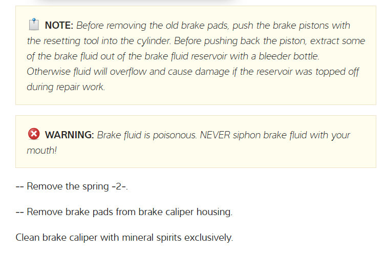

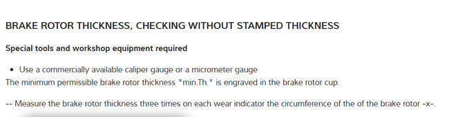

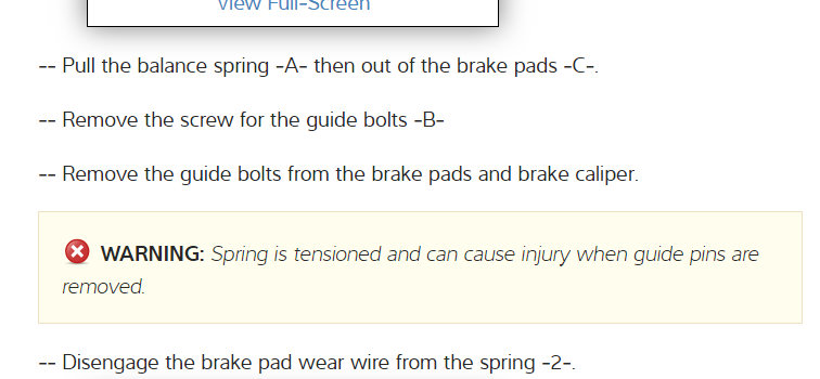

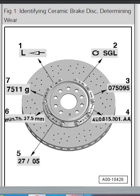

SCGRANTURISMO
  • 4,897 POSTS

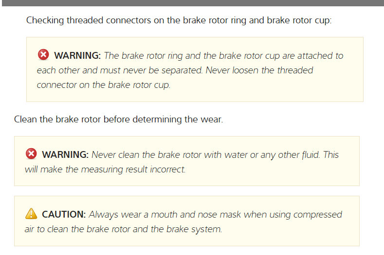

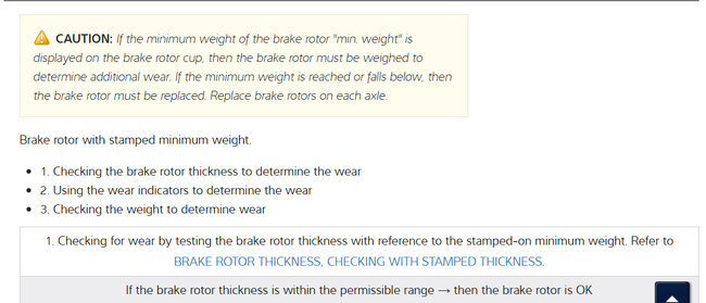

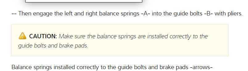

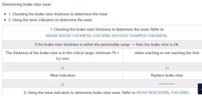

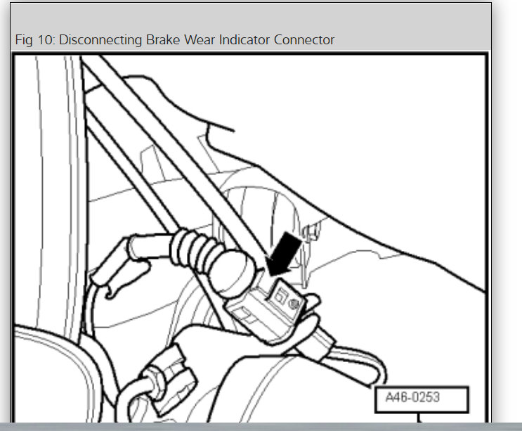

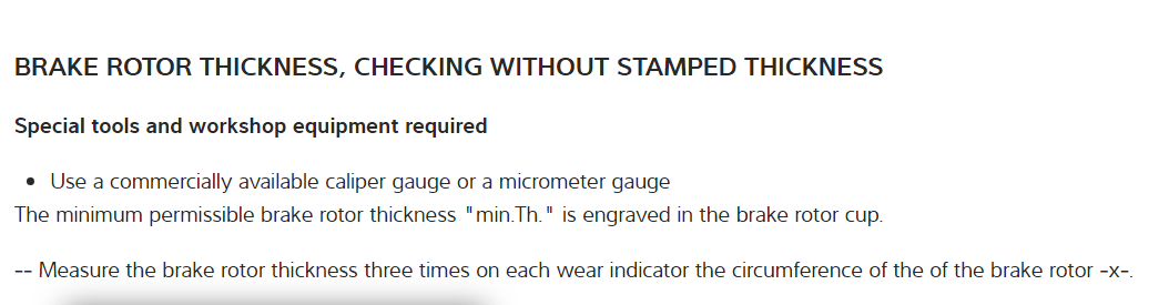

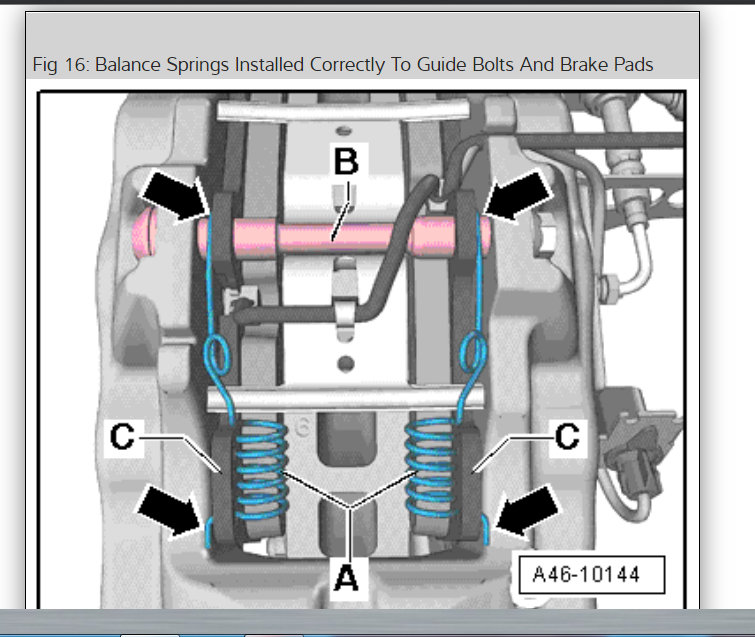

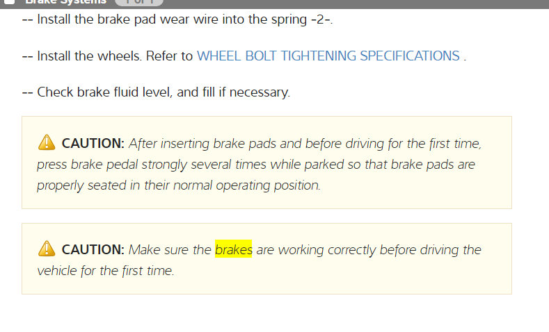

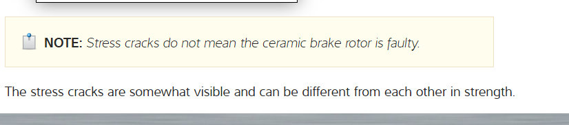

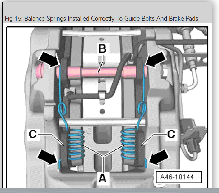

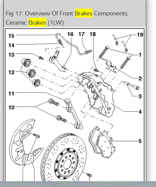

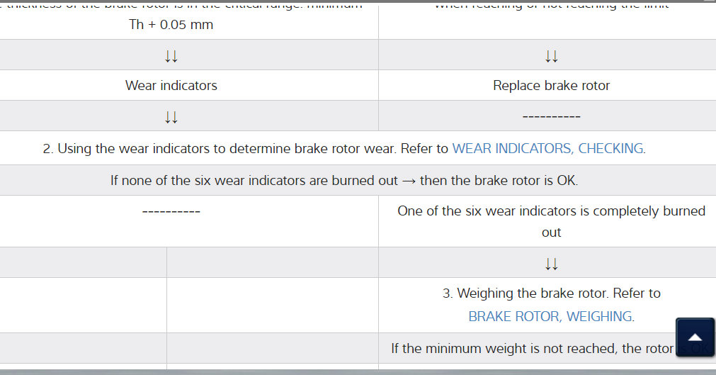

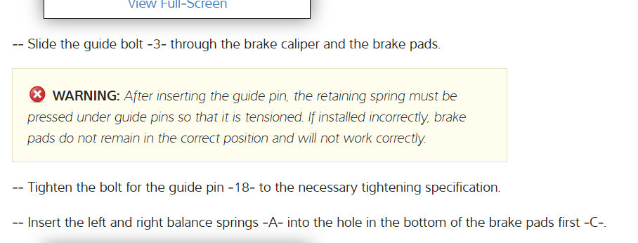

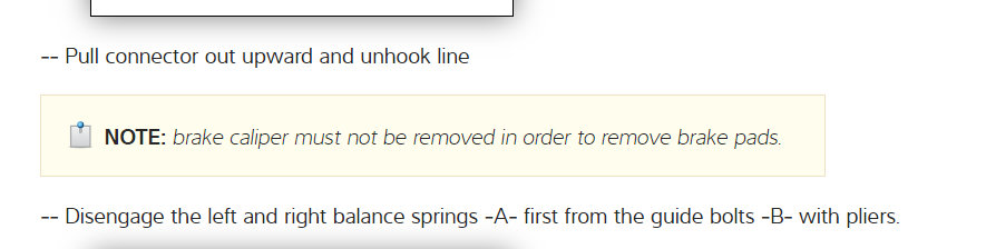

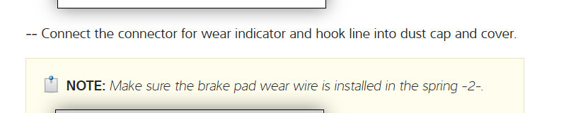

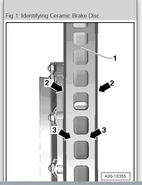

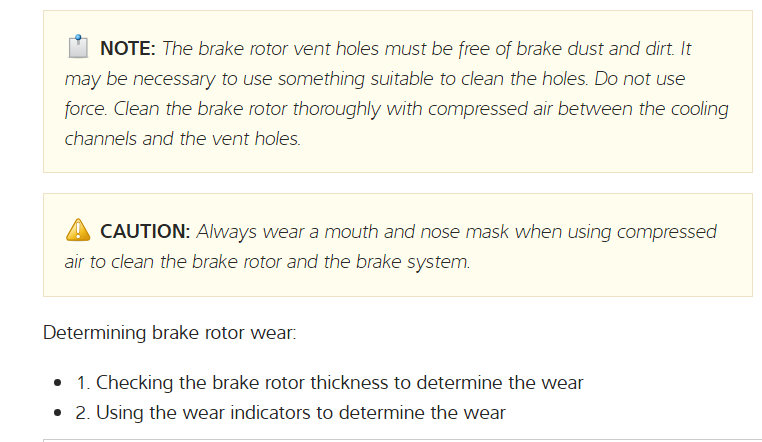

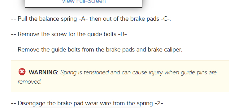

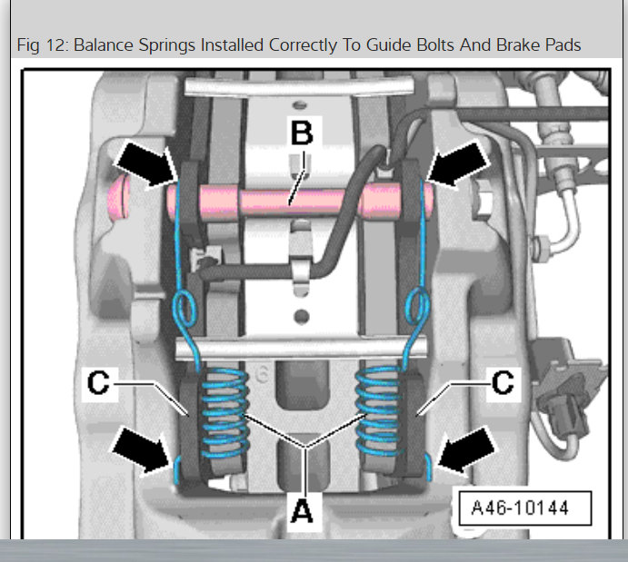

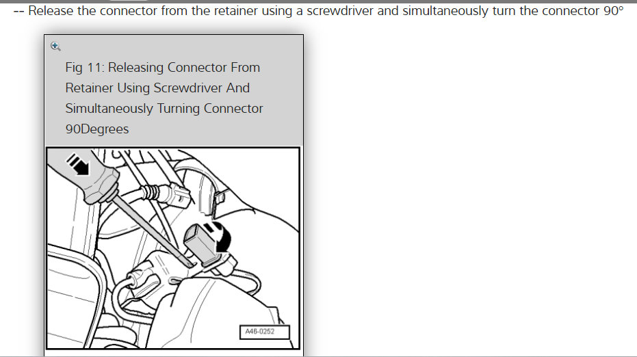

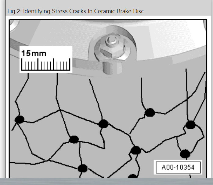

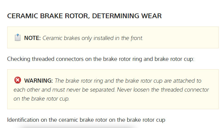

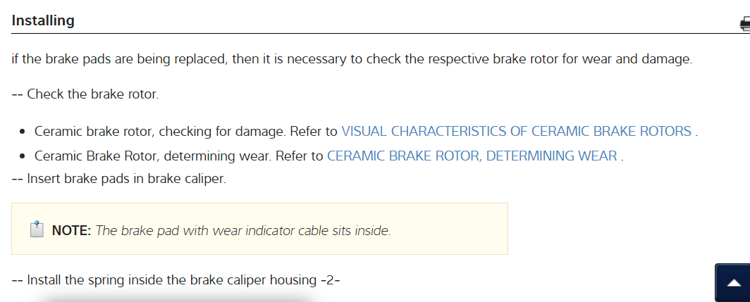

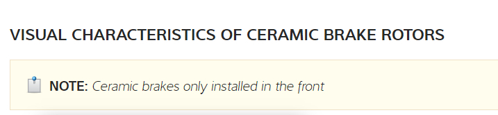

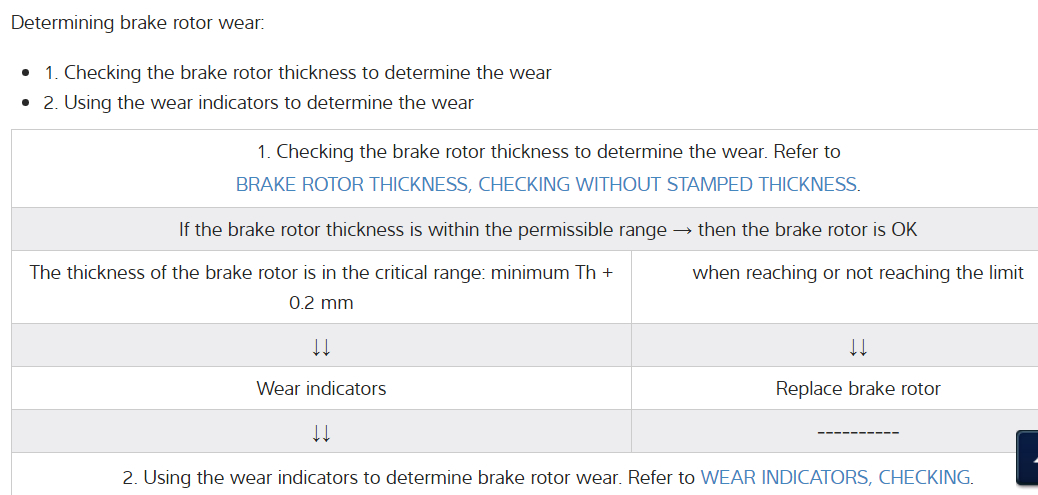

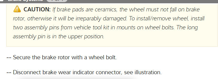

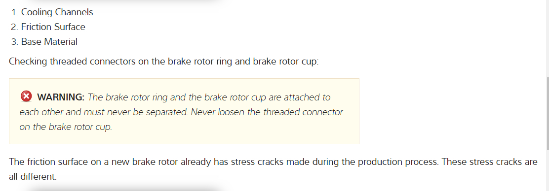

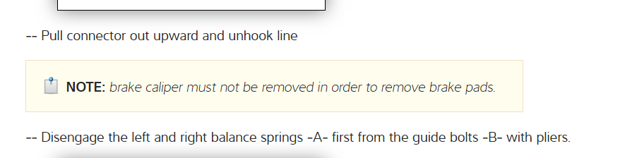

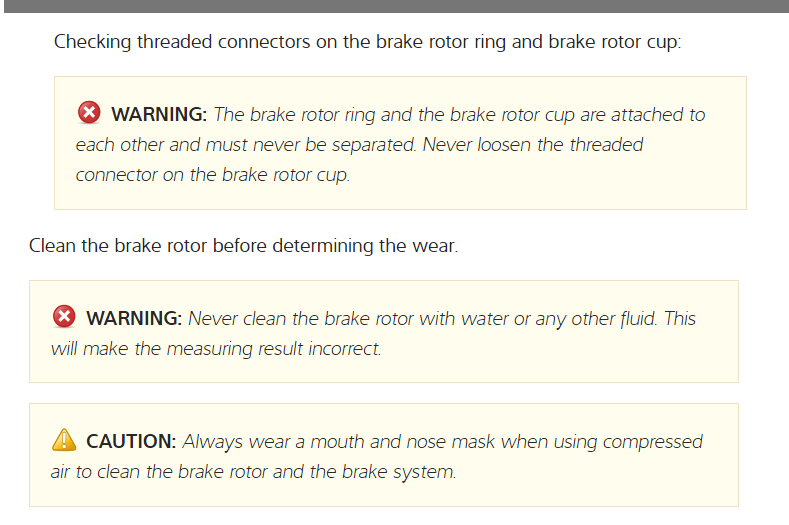

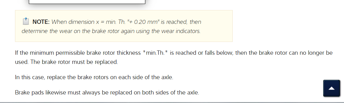

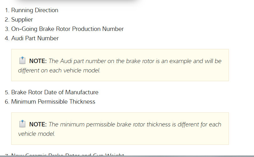

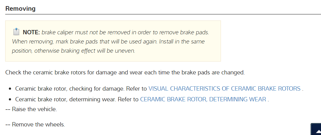

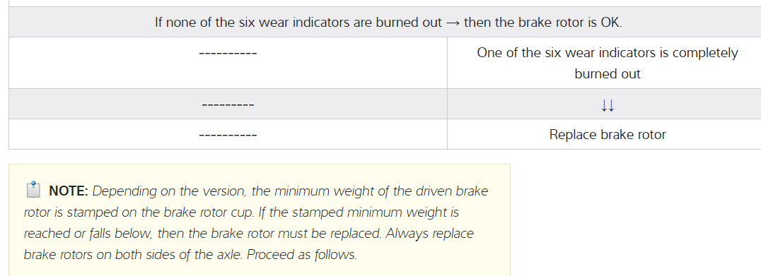

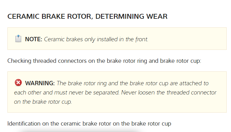

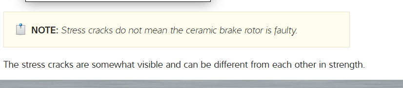

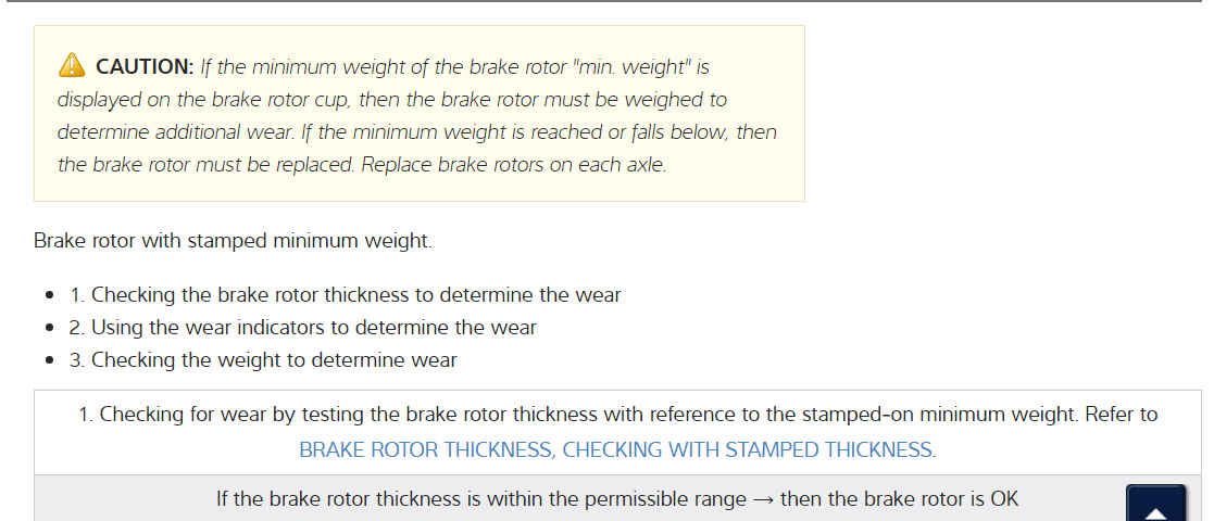

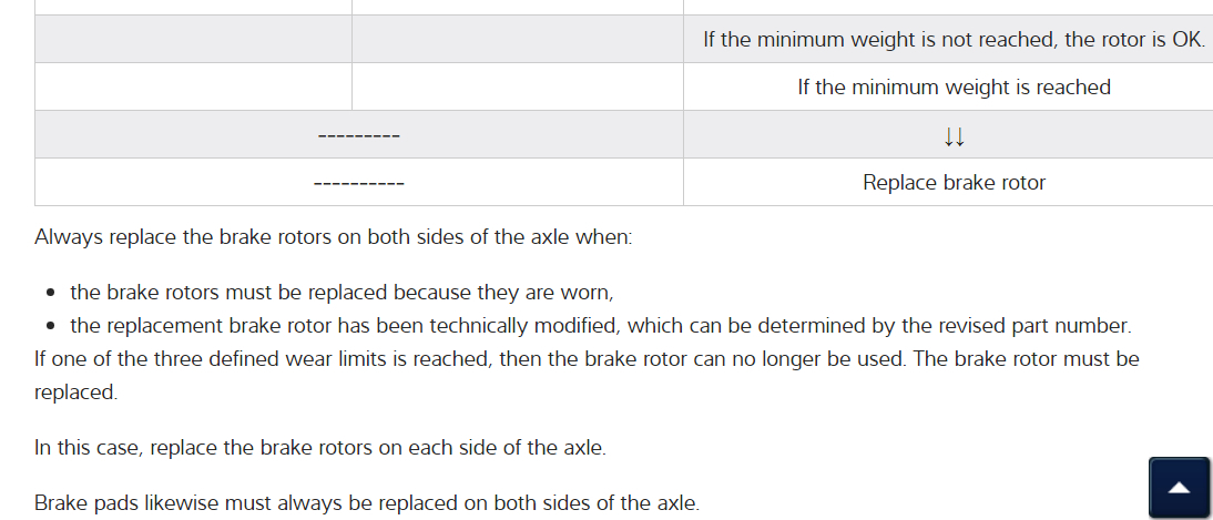

I have included the information that you requested in the diagrams down below. It not only contains the instructions for removal and installation of the brake pads,, it also has instructions for inspection and measuring the brake rotors. I have also included a link for you to go to down below:
Please go through these guides and get back to us with what you are able to find out please.
