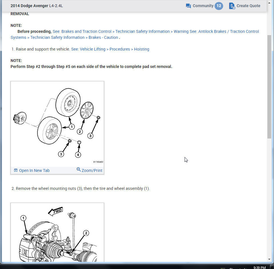

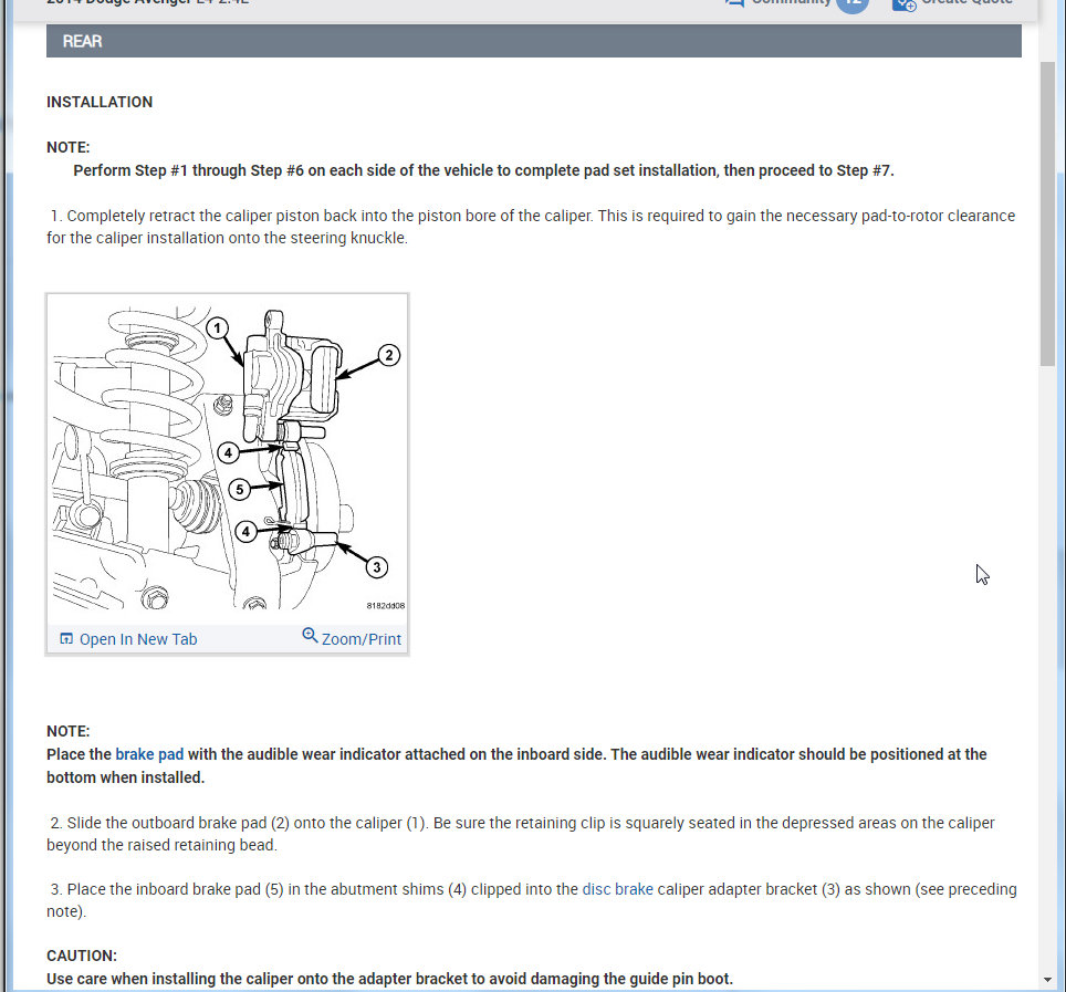

i am trying to find out what the original pads are made of that are on the car from factory? not sure if they are ceramic or semi metallic? car has 4 wheel disc brakes i want to replace pads with the same kind of pads from the factory (but not oem mopar)i want to use another top brand just need to know whats the best for this car and what pads came on it from factory! any help would be appreciated! thank you
Apr 27, 2016 at 6:23 AM

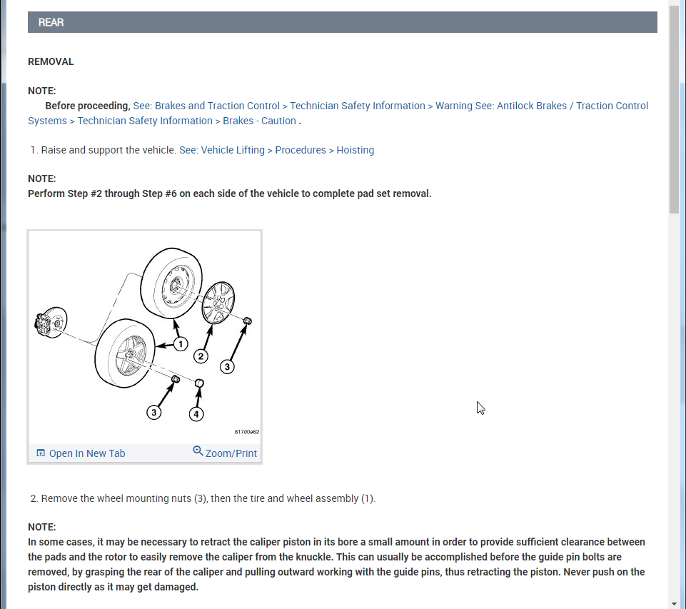

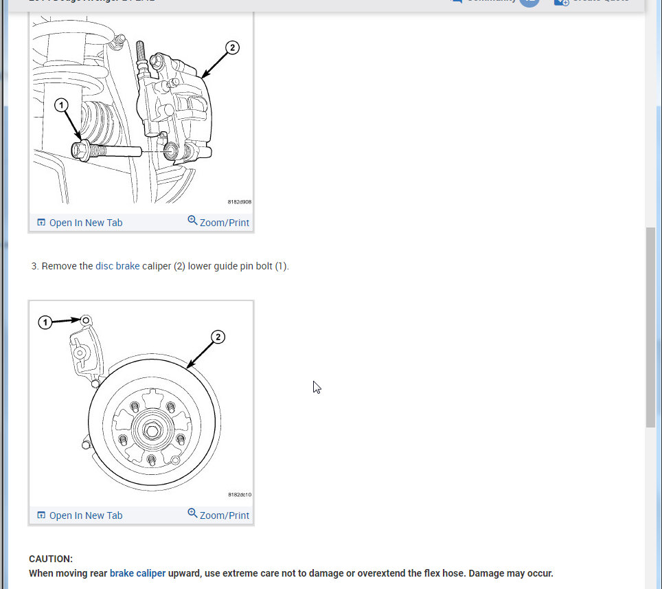

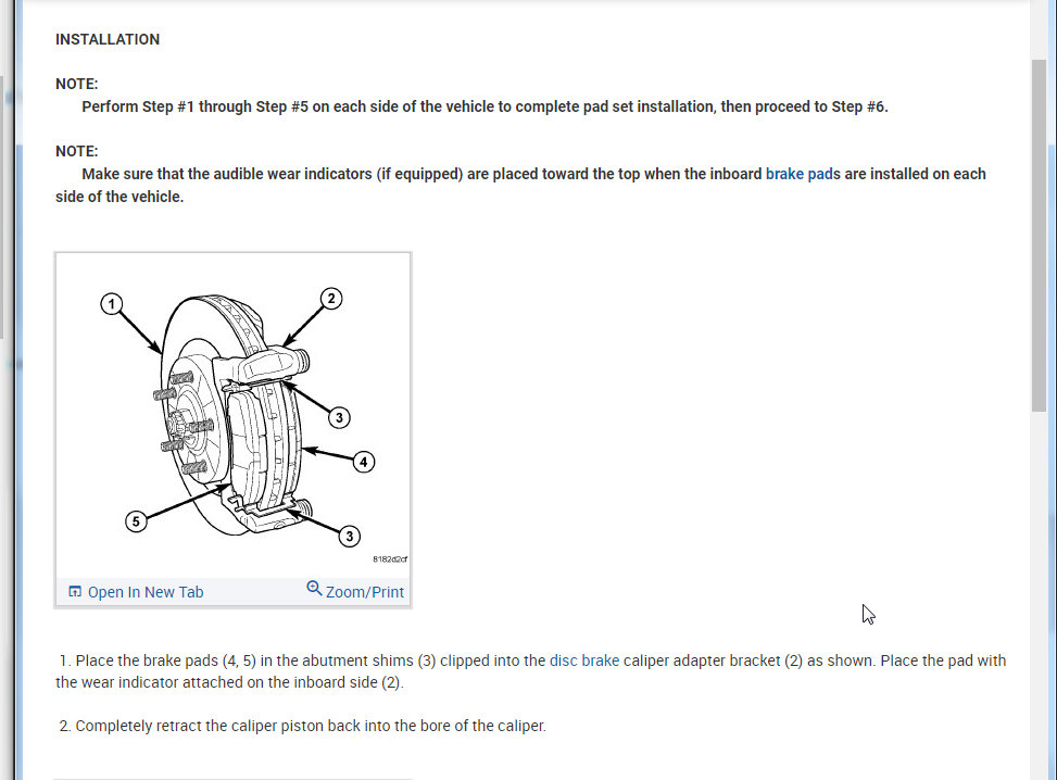

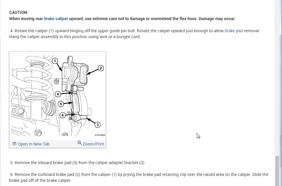

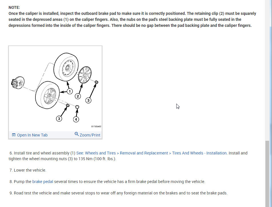

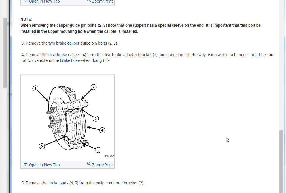

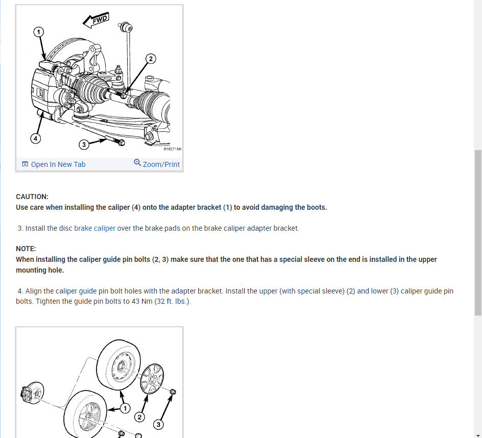

These vehicle come with semi metallic and here is a guide that will help with replacing the pads:
https://www.2carpros.com/articles/how-to-replace-rear-brake-pads-and-rotors
Also, below you will find the process from the manual on how to replace the pads on this vehicle.
Let's run through this material and let us know if there are questions. Thanks
