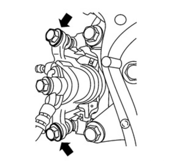

Remove the upper and lower sliding pin bolts. Refer to Exploded View.
NOTE: Note the sliding pin orientation during removal. The upper sliding pin contains a bushing.
Remove brake caliper from torque member. Leaving brake hose attached, reposition the brake caliper aside with wire.

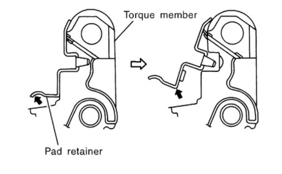

Remove the brake pad retainers from the torque member.
CAUTION:
When removing the brake pad retainers from the torque member, lift in the direction indicated by the arrow as shown so that it does not deform.
Replace brake pad retainers if damage exists.

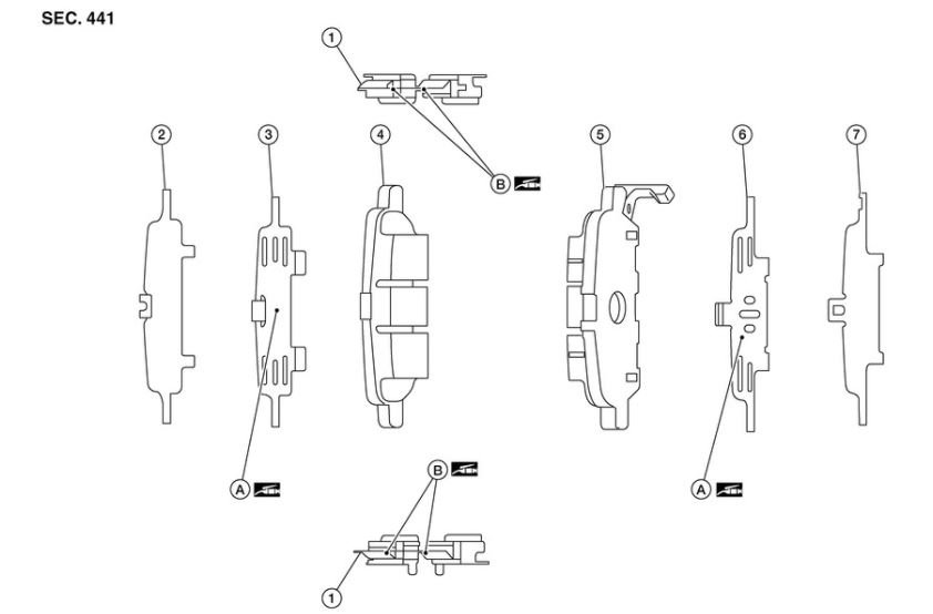

Apply Molykote AS-880N grease or equivalent between the outer brake pad, outer shim cover and outer shim and the inner shim and inner brake pad. Install outer shim, outer shim cover to outer brake pad, and inner shim, inner shim cover to inner brake pad.
CAUTION: Replace brake pad shims and covers if damage exists.
Apply Molykote 7439 grease or equivalent between brake pad retainers and brake pad ends. Install brake pad retainers and brake pads on torque member.
