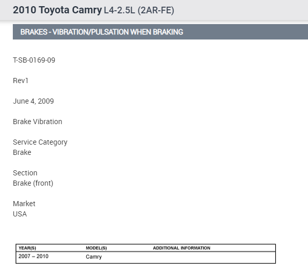

Brakes work fine but when just light pressure on pedal a clicking vibration and noise felt in pedal only.

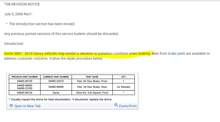

If you feel it in the pedal, chances are it is related to a warped brake rotor. Since you only notice it at the pedal, there is a good chance it is the rear brake pads/rotors.

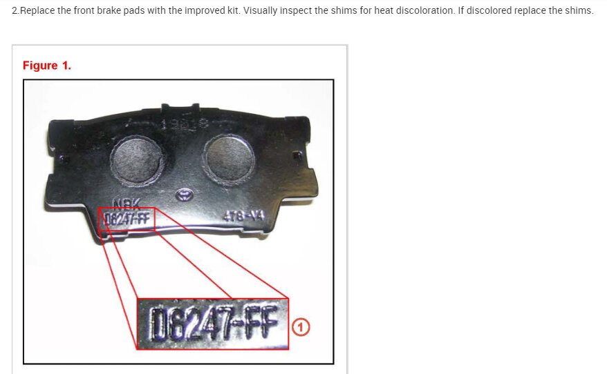

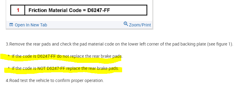

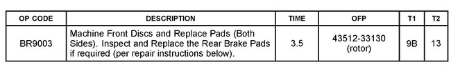

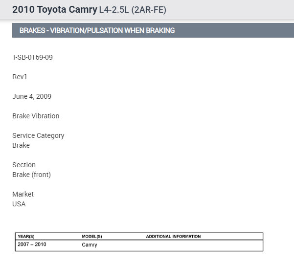

Interestingly, I found a technical service bulletin (TSB) related to brake pad issues. I attached it below for your review.
By chance, have the brakes been worked on recently? I realize the vehicle has 110K on it so the pads are not original, but the TSB could be relevant if the old design was used.
