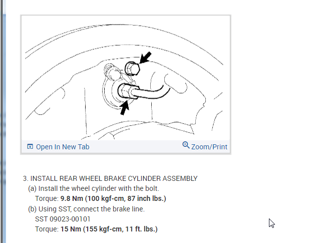

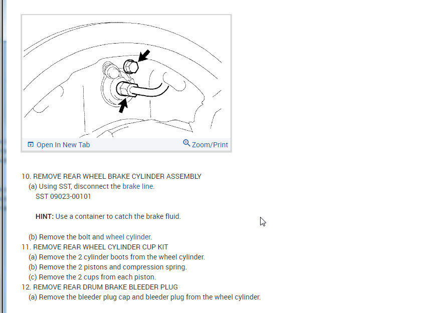

i replaced the rear shoes last week. now I seen the rear brake hose is leaking I need to change it out.

Here is a video that will help with replacing these hoses:
https://www.youtube.com/watch?v=xMS8Xy4Xz1U

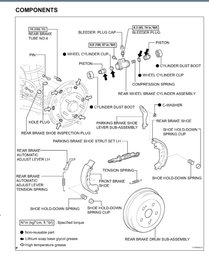

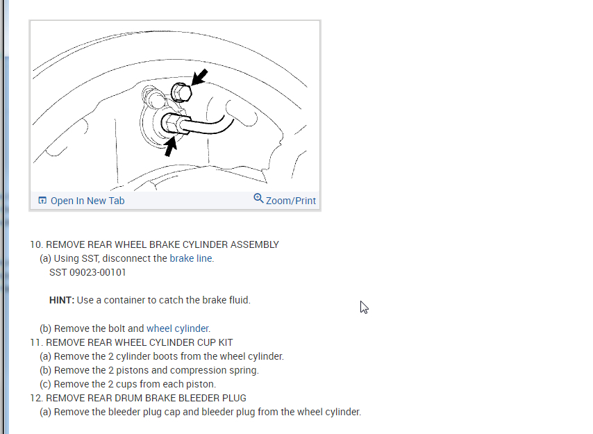

Below you will find the instructions from the manual on how to remove the line from the wheel cylinder and replace it.
Please let us know if you have other questions. Thanks
