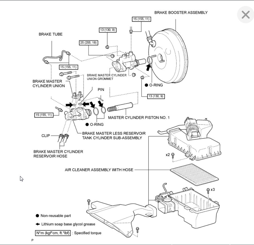

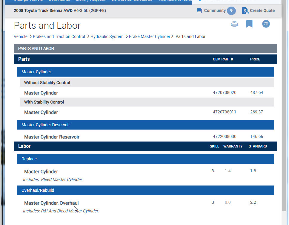

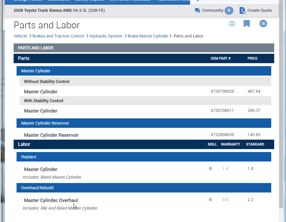

Based on your reply I was ready to pull Master Brake Cylinder from 2008 Toyota Sienna when I noticed that there appears to be two parts to the master cylinder. The portion between the front and the Brake Booster has a bleeder valve on top. I decided to bleed that first since air in the line could be causing a problem. After bleeding the brake pedal it did come up a bit, but not all the way to the top. I've decided to replace the master cylinder based on the observation that it could be leaking from the first to the second piston. When I go to any Toyota dealer website they show the front piece separately as the "Master Cylinder". On any dealers website parts diagram they show the second half attached to the brake booster. The parts technicians at the dealers confirm that it comes with the new booster. I've also checked on line and at Advance Auto and they all sell the front portion but do not show the back piece attached to booster as show on Toyota diagram. The online part warehouses sell the booster separately, but none show that second half. The technicians at Toyota parts say I need to purchase booster from them to get the middle part. Of course the booster from Toyota will cost between $800.00 and $1,000.00 depending on which dealer I order it from. Are you familiar with the Master Cylinder on the Sienna and the second piece behind it attached to booster? If so, is it part of master cylinder or booster? Any other suggestion where I can find the center portion or am I stuck going to dealer? Thanks again, Henry Burmeister.
Jan 4, 2021 at 8:24 AM

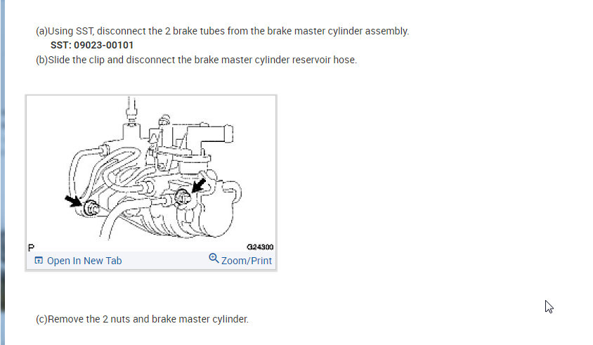

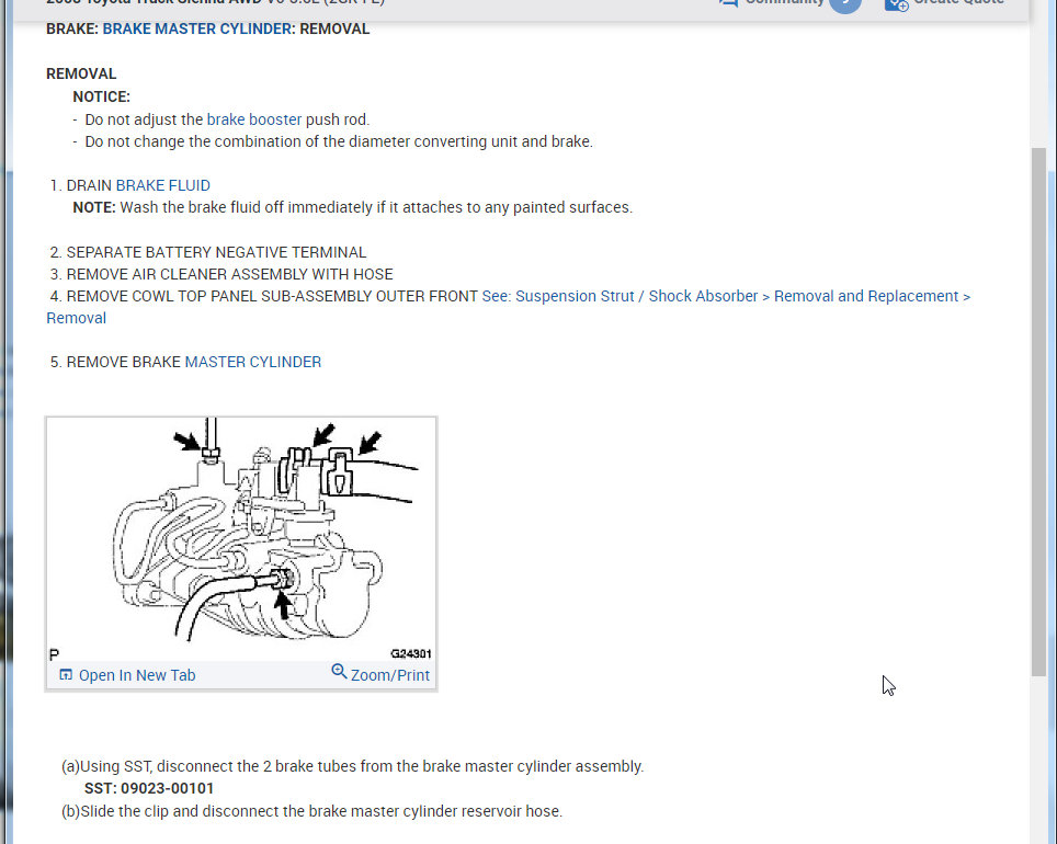

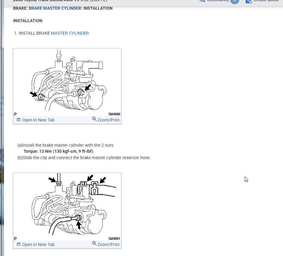

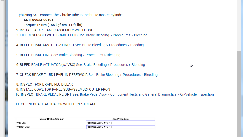

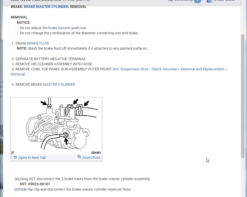

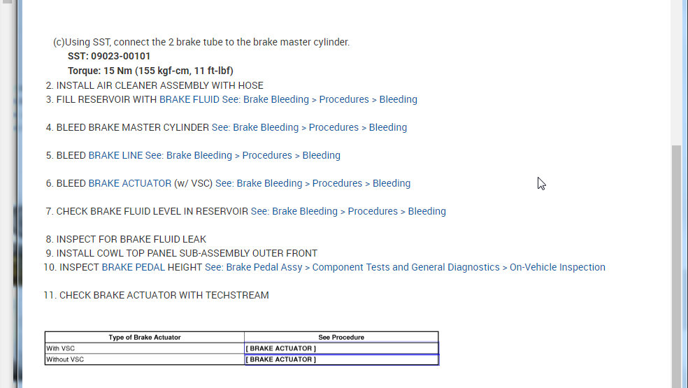

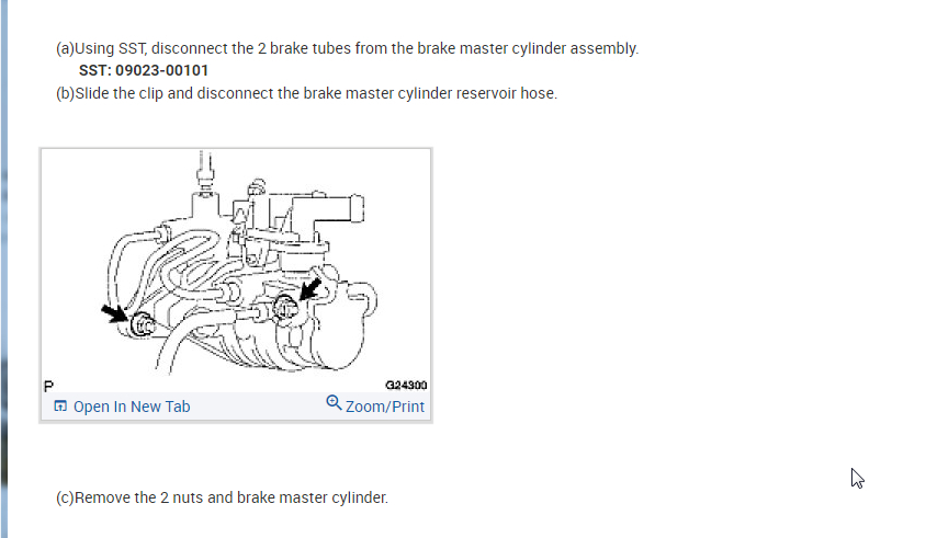

If your issue is that the brakes are dropping and it is the master cylinder then you do not need to replace the entire unit. You need to replace the master cylinder which is shown in the picture below. I show you can get these for less then a $100.00.
Here is a guide that will help with this issue:
https://www.2carpros.com/articles/brake-pedal-goes-to-the-floor
Below you will find the attached info for this. Let us know what questions you have. Thanks
