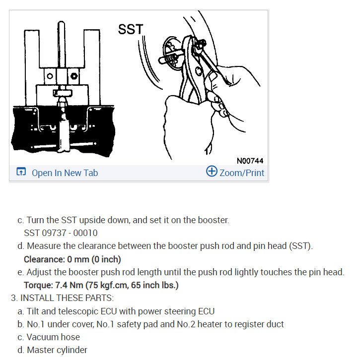

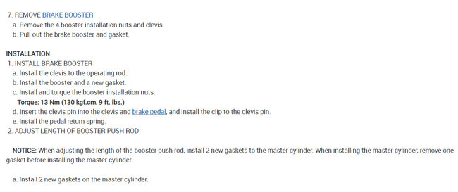

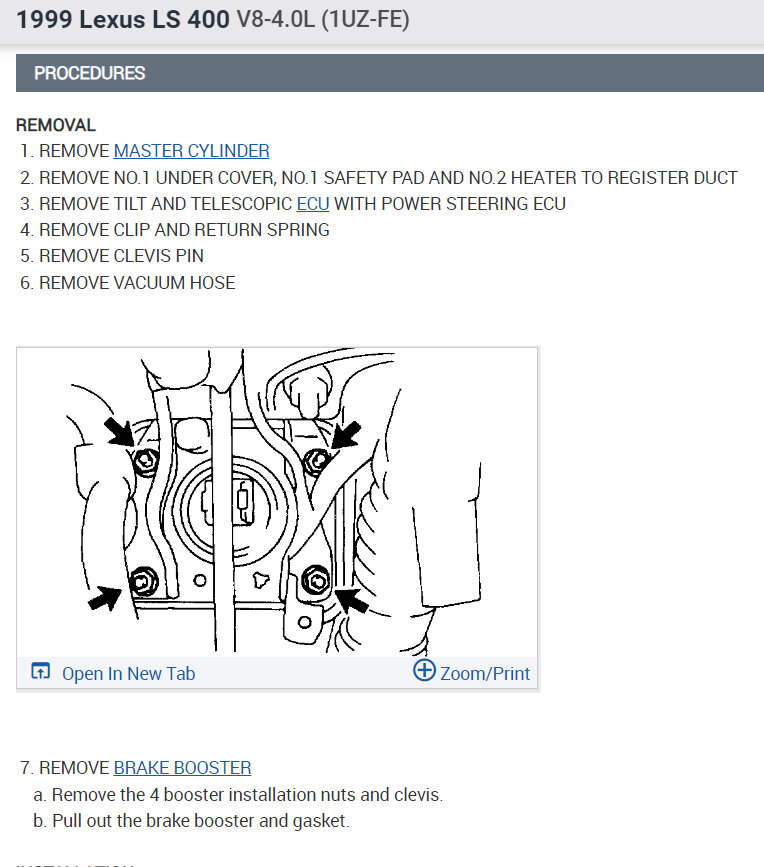

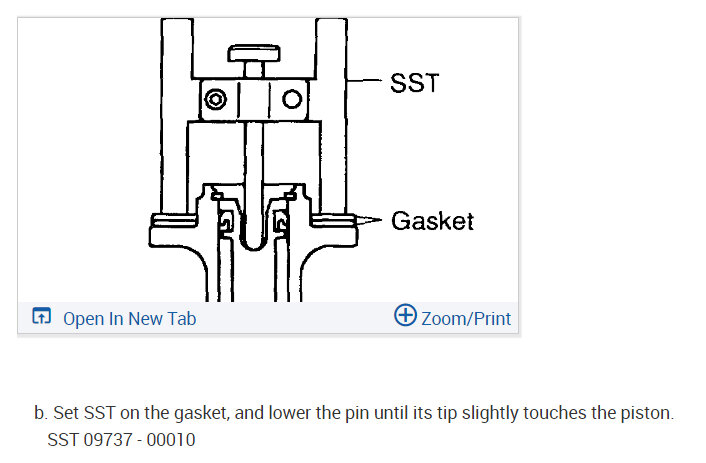

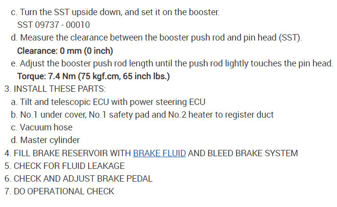

This sounds like the brake booster pushrod was not adjusted correctly which can hold the brake on, here is how to do the job and adjust the pushrod so it does not hold the brake on. Check out the images (below). Let us know what you find.
