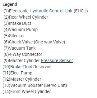

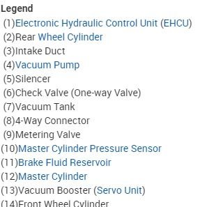

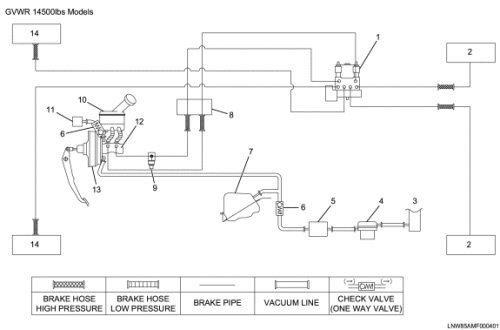

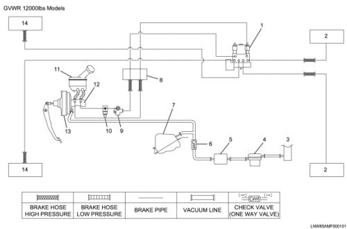

Brake lines run back to a distribution block that then runs to another strange assembly before then running back to rear wheels. is there a schematic for brake line routing and or a bleeding procedure?
Jun 6, 2019 at 8:01 AM
  • 110,248 POSTS
Welcome back:
The first four pictures attached show the brake line routing and legend of each component. There are two different ones based on the vehicle's GVWR.

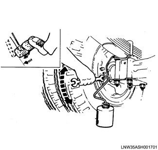

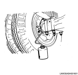

Next, here is the bleeding procedure for your vehicle. The remaining pictures correlate with the directions.

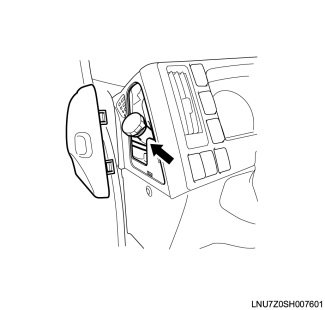

pic 5
2. Bleed in the sequence recommended previously.
3. Remove the bleeder screw valve cap.
4. With the proper size box end wrench over the bleeder screw, attach a hose over the screw and allow the end to hang in a glass jar containing enough brake fluid to cover the end of the hose.
pic 6
5. Pump the brake pedal two or three times and then hold down.
6. Open the bleeder screw about one-half turn and fully depress the brake pedal. Observe flow from the hose.
pic 7
7. Close the bleeder screw as soon as bubbles stop and the fluid flows in a solid stream. Release the brake pedal after closing the bleeder screw.
8. Repeat at the same bleeder until bubbles stop.
9. Repeat at the other bleeder screws in the proper sequence.
10. Replace the bleeder cap.
11. When the bleeding is complete on each wheel, check the level of brake fluid in the reservoir and replenish, as necessary.
