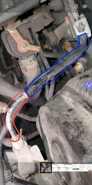

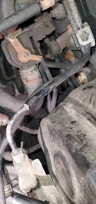

Attached are sample pictures from a different location, which happens to be by the master cylinder that illustrates what I'm referring to in reference to the difference in the tubing sizes, which is very noticeable. The part of the brake line circled in red is 3/16" and the one circled in blue is 1/4". So, what's the point of having two different tube sizes on the same brake line? It's very confusing.

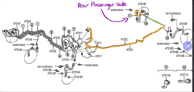

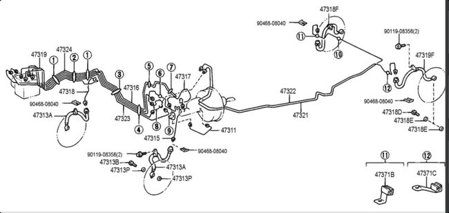

Attached are diagrams of the brake lines. The brake line highlighted in orange and green is actually the same line for the rear passenger side. The orange part is 1/4" and the green part is 3/16". The green part is where the leakage is, located right behind the gas tank. So, again, why are there two different tube sizes?

Great question. The reason for the two different size lines is to increase the braking force at the caliper.
So when you take a larger line to a smaller line and push fluid through it the pressure is larger coming out of the end of the line.
Think of a garden hose that you put your thumb over.
I think if you are going to splice in a replacement line then you need to replicate the step down in line size if this is where the leak is.
I would not suggest trying to do this yourself as it requires a specific machine to make this line. So if this is where your leak is, I would go to a salvage yard and get this entire brake line and then just cut off the same portion on that one that you need to replace on your vehicle.

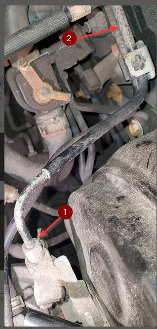

I attached the picture below of where I would cut it (#2) and then disconnect the joint at number 1. If you cut it at number 2 then you save yourself some bending.

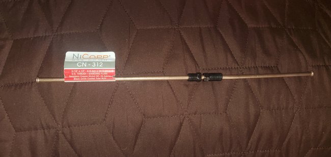

Furthermore, as an example, if we take a look at the attached Part # CNJ-312, which is a pre-flared Japanese brake line, both fittings are the same size. On the other hand, the attached Part # CN-312, which is a pre-flared domestic brake line, why does it have one fitting that is longer than the other one?

The one thing that I can think of that differentiates the pre-double flared domestic brake line from the Japanese one is that the fittings are in SAE for the domestic ones whereas the fittings are in metric for the Japanese ones. FYI, the pre-flared brake lines are flared at both ends. I have attached a picture. What I still don't understand is why does the domestic brake line (Part# CN-312) have fittings that are different lengths whereas the fittings for the Japanese brake line are the same length.

As for the different lengths of the fittings on this replacement line, they are different just because there are some that require the longer threads, so they provide that on one end. Keep in mind, these are universal, so they need to try and fit as many different vehicles as possible.
If you don't require the longer threads, then it is fine to use them any way. They seal the same way but if you only have two of the shorter fittings then you will have leaks because it is not going to bottom out on the female end.
