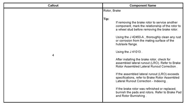

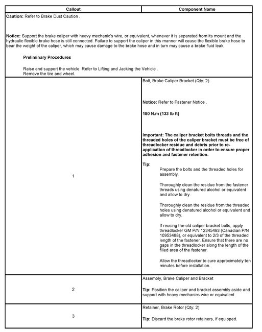

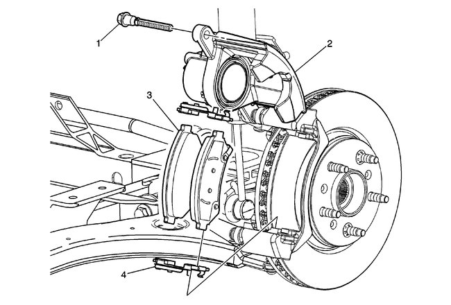

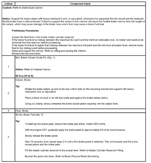

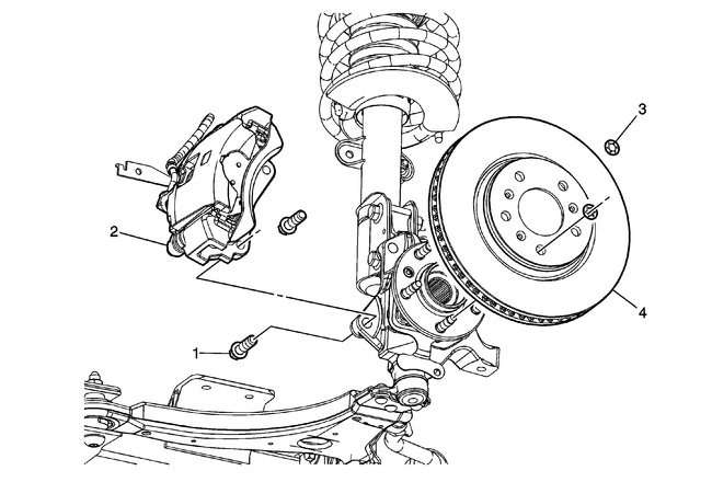

Here are the directions specific to your vehicle. The attached pics correlate with the directions. Check out the diagrams (Below). Please let us know what happens.
