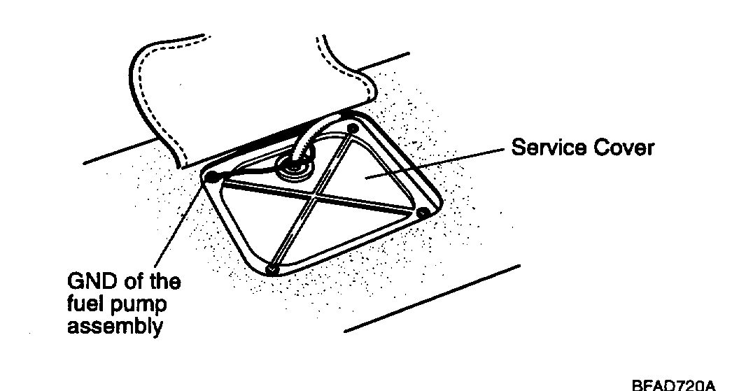

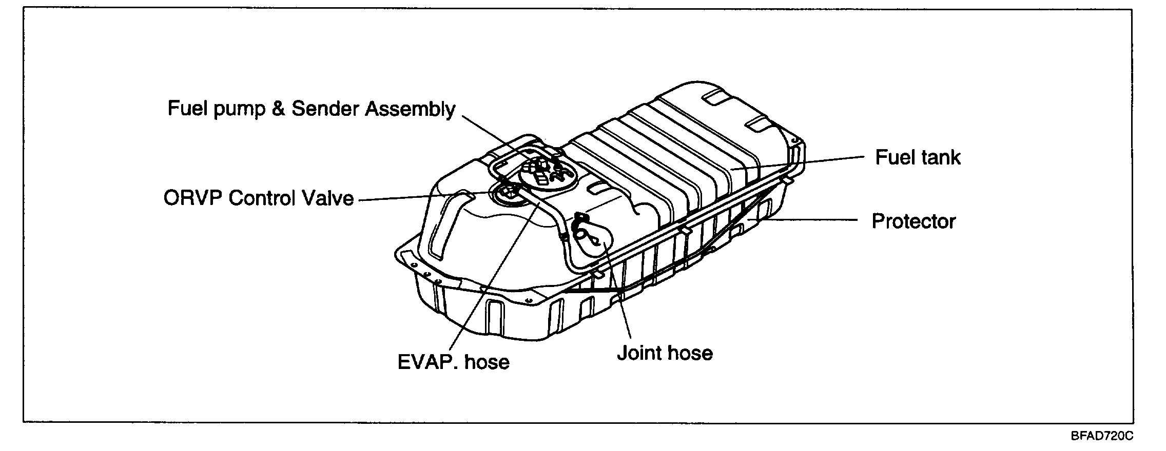

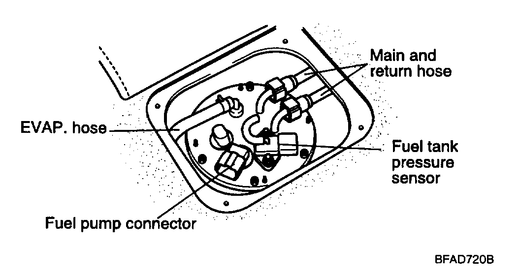

Do I have to drop the gas tank to get to the fuel pump?
Dec 23, 2018 at 1:01 PM
  • 110,194 POSTS
You have a tap door here is how to replace the pump.

4. Remove the rear seat.
5. Remove the service cover under center floor carpet.
6. Disconnect the fuel pump electrical connector, the EVAP hose, the main and return hose.
WARNING: When disconnecting fuel hose quick connectors, use shop towels to absorb fuel, protecting equipment and personnel.
7. Disconnect the breather hose.
8. Disconnect the joint hose.
9. Unfasten the fuel tank-fixing bolts.
10. Remove the fuel tank.
