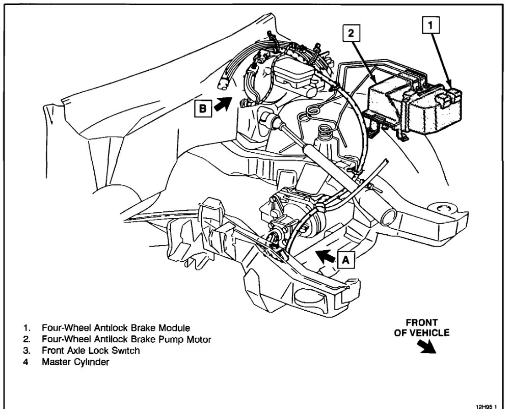

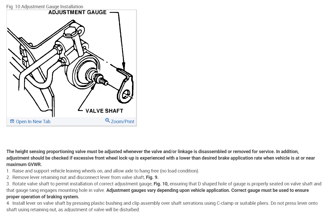

I need the diagram for the front brake lines for the vehicle listed above s10.
Sep 9, 2023 at 1:07 AM
  • 55,770 POSTS
They don't give diagrams like that, but I did find some that might help you. Check out the images (below). Let us know what happens and please upload pictures or videos of the problem so we can see what's going on.
