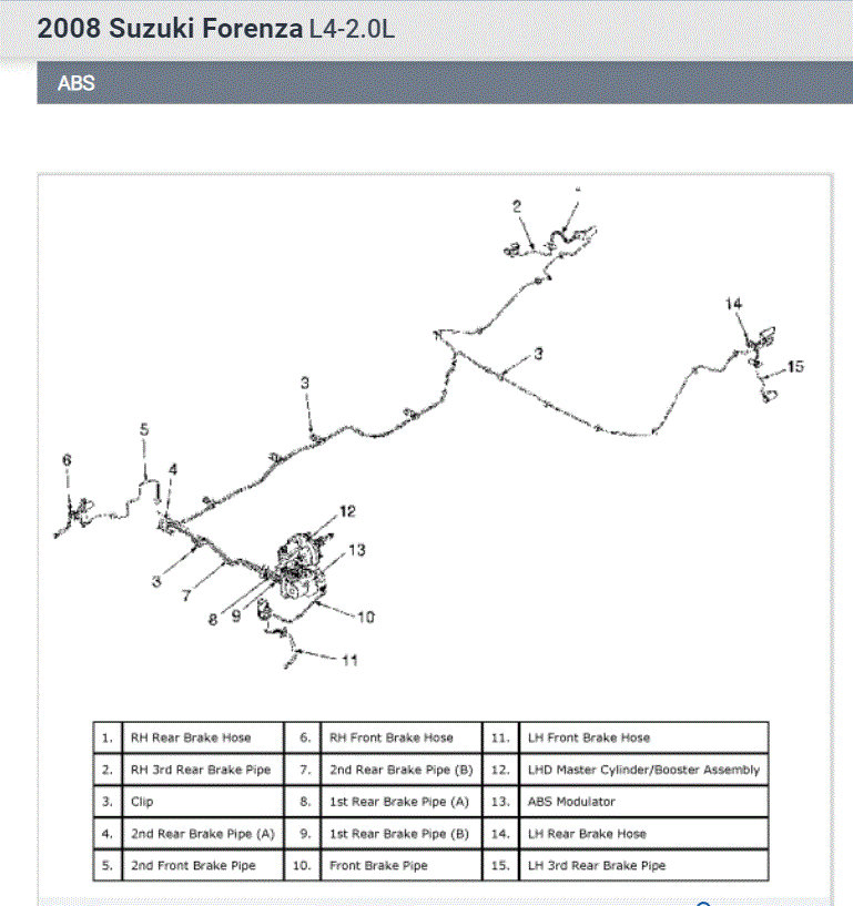

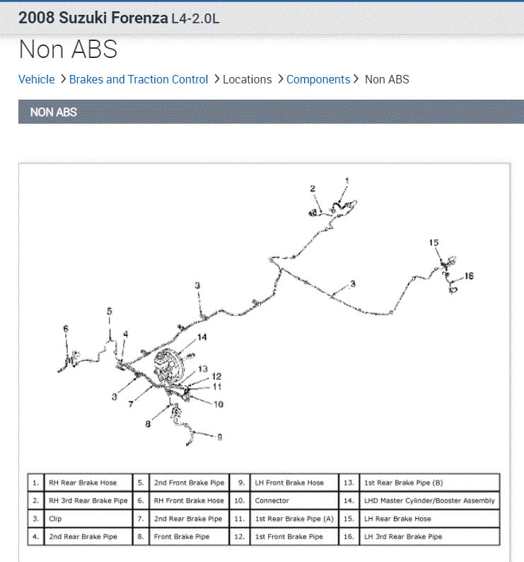

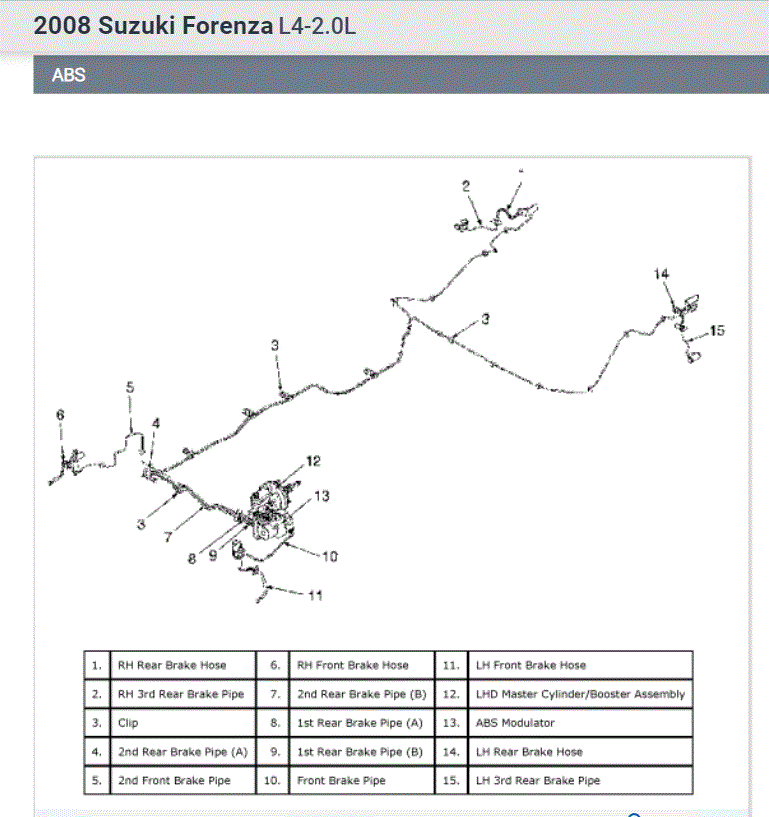

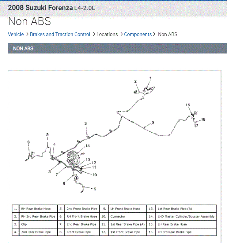

In 2008, the Forenza came without ABS and with ABS. It was optional. As far as brake line size, normally a repair manual won't provide that info. However, I will try my best to find it for you.
Take a look at the two pics below. They show the hoses for both systems. Let me know which line needs to be replaced and if it is a rubber or steel line.
