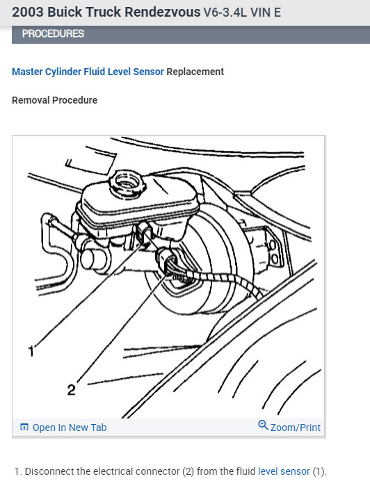

Replaced the brake line going to the rear of car cannot get low brake fluid light and dinging to go off dash.
Jan 16, 2022 at 3:58 AM
SQM
  • 6,383 POSTS

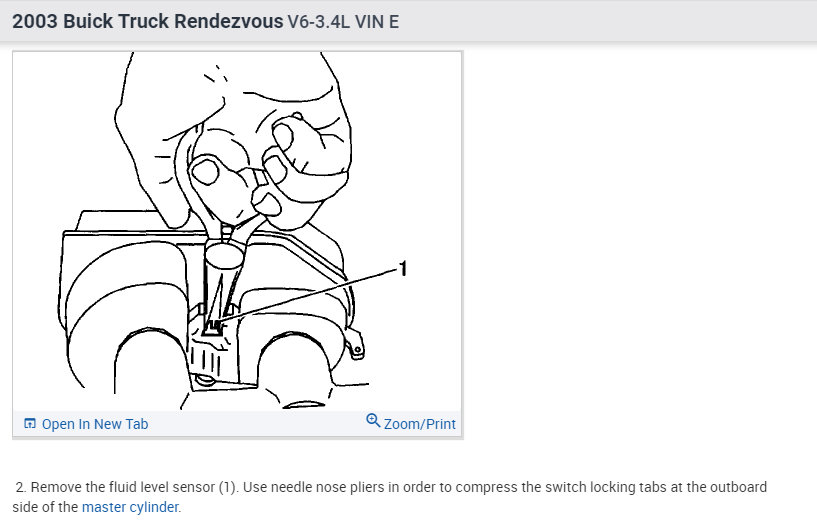

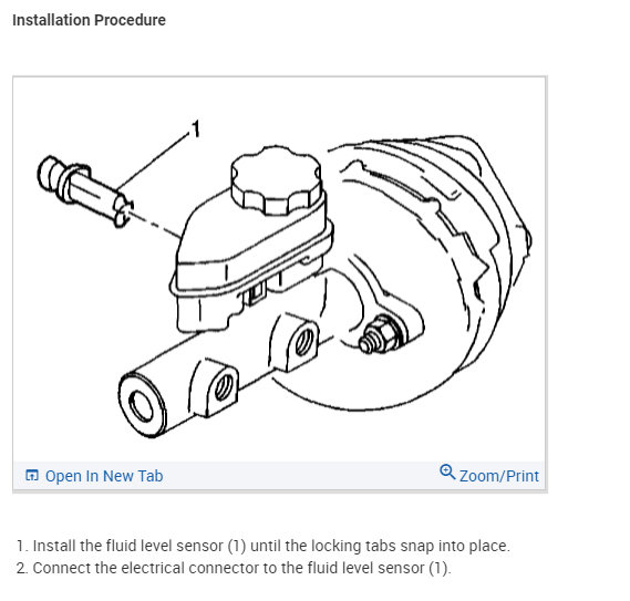

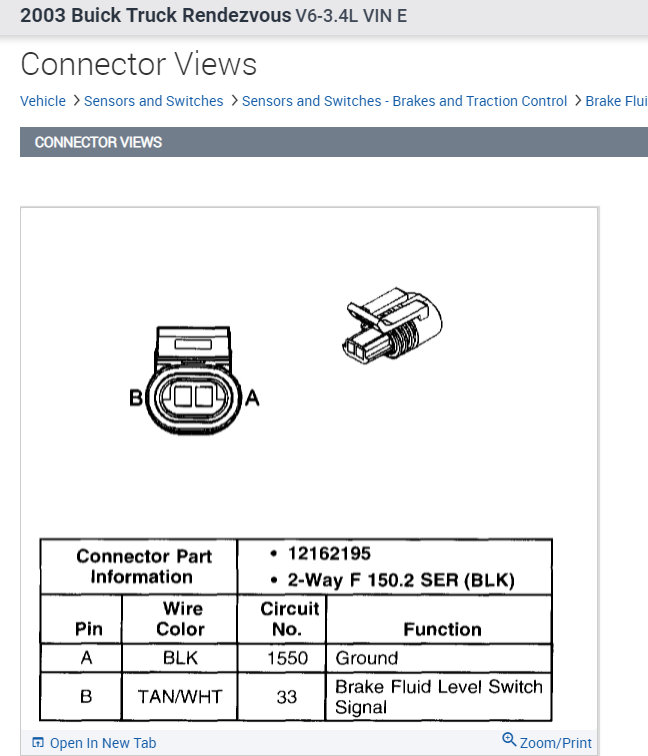

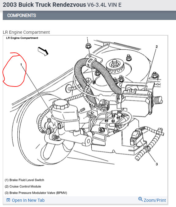

On the side of the master cylinder there is a brake fluid level sensor. When the fluid is low that sensor sends a low fluid message.
If the fluid is at the correct level and you are getting that warning light, it could be due to a faulty sensor.
You also want to make sure that the connector is secured to the sensor and does not have any corrosion.
