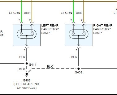

I recently changed the fuses, put in bulbs and changed the brake terminal above the brake pad control. there still is no change to this. Both of my lights work. there is no reverse lights or brake lights. blinkers are not blinking fast either. please help with

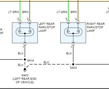

First, make sure there is power both to the switch and out of the switch when you depress the brake pedal. If there is, I need you to check ground. I attached a schematic of the brake lights. Note that both sides have the same ground. However, the third brake light has a different one. If the third brake light works and the tail lights don't, I suspect the ground.

Take a look at this and let me know about the ground. Additionally, you mentioned that the signals are not flashing fast. Do the rear ones work?
