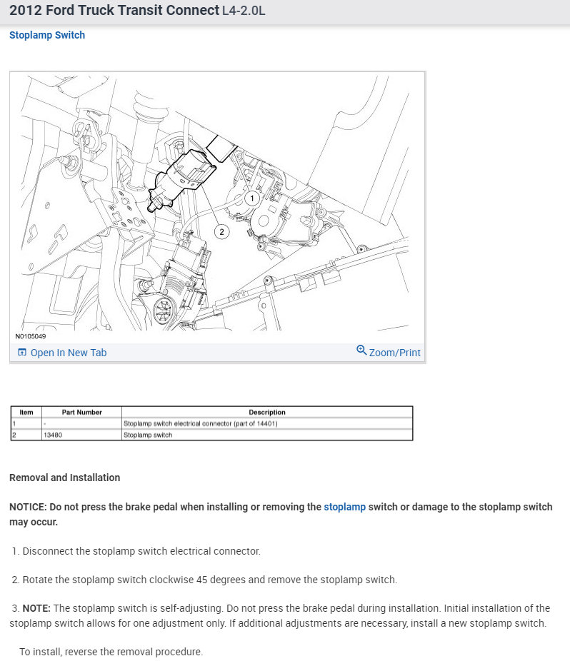

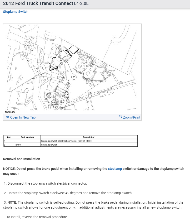

This could be due to a shorted out brake light switch.
The brake light switch is located under the brake pedal. When the pedal is pressed the switch gets activated and all the brake lights come on.
It is possible that the switch is stuck in the 'on' position.
Checking the brake light switch is a good first step.
I have attached diagrams below for your reference.

New brake light switch checked no short going to shifter. Now I don’t have brake lights. Power going to brake light switch and shifter signal and running light work bulbs are all new and fuses are good.
Feb 6, 2022 at 5:16 AM
SEAN MASON
  • 5 POSTS
After all this no power is going to the brake light switch when the key is off. With the key on I have brake lights. So, after running wire’s down looking it all up on Alldata it turns out to be directional switch under steering wheel run the brake lights through the signal light. Repaired, thank God.
