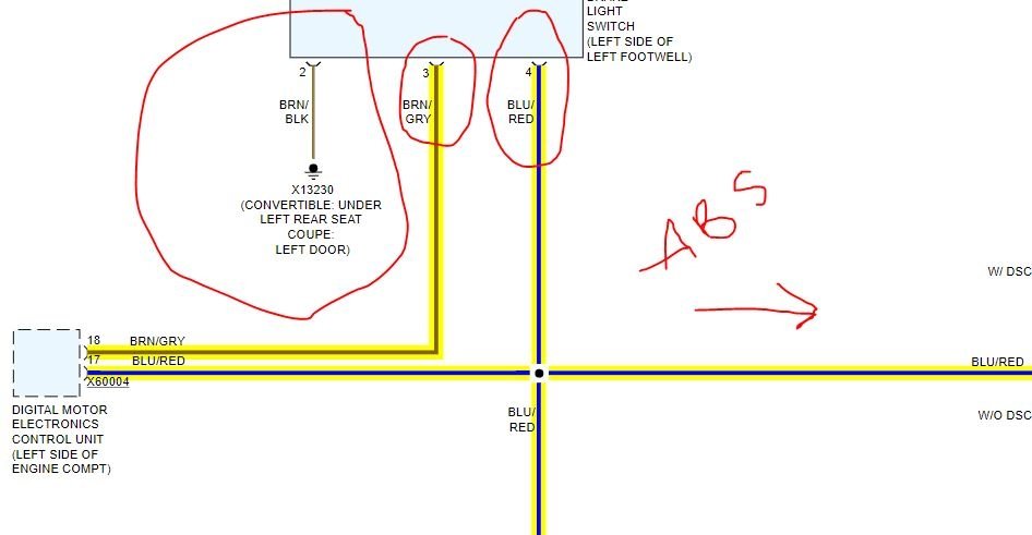

This almost doesn't make sense because the circuit is closed when you press the brake allowing power to travel. With that, the only thing that comes to mind is if you have the ground and power send reversed somehow and it's allowing the continuous flow of power until the circuit is closed. Now that I said it, that doesn't make sense. lol

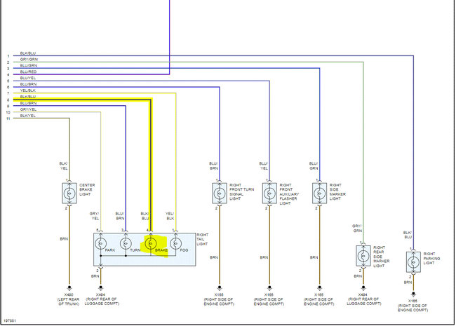

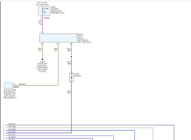

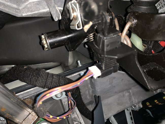

Lets start with this. I attached two pics. The first one shows the wiring at the switch. The power is supplied to the switch and is sent through the switch when the circuit is closed to a few places. One is the general module which redistributes power to the brake lights, the other is the ABS unit. See pic 1
Picture 2 shows power from the switch to the general module and then how it's distributed to the tail lights. I have arrows pointing in the directions of power flow.
Take a look at the attached pics and let me know if specifically, one of the wires was switched at the switch. Note that the first pic shows wire color and pin number in the plug.

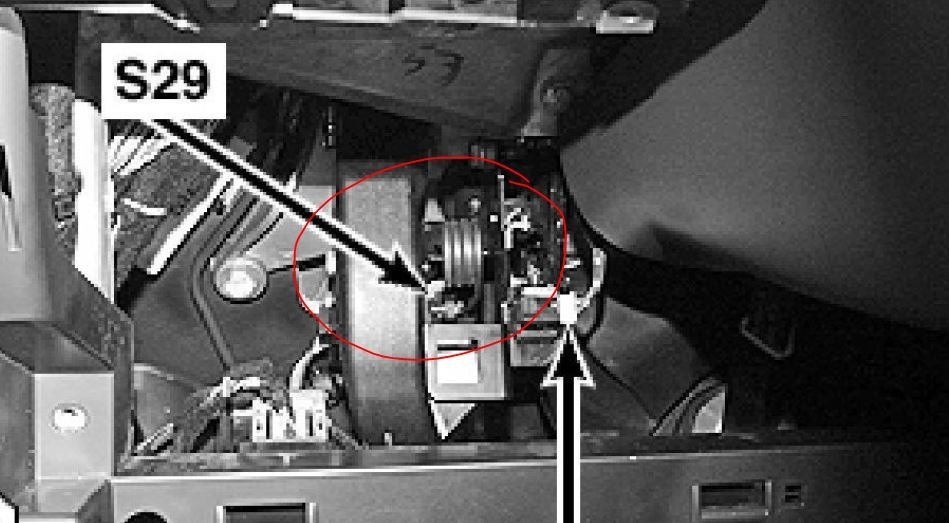

Also, the last pic is of the switch. Could you have reversed how the switch attaches causing it to work in reverse?
Let me know what you find.

First off I want to thank you for taking the time to try to assist me. My brake light switch has 4 wires that come out of it. I replaced the switch with a “standard” brand and was direct plug and play. I am not going to lie I am having a hard time following your photos and making complete sense with them, largely because I am not electrically inclined. I have attached some photos to show how I connected the wires and I am not sure what to try next.

Is there any way the plug may have been put on in reverse? Also, if you can, upload the pics you have. Something is reversed, either in the mechanics portion or something that changed polarity (meaning the power is running in the opposite direction).
I have to be honest, no matter how I look at this problem, it doesn't make sense. The switch itself is either closed or open, meaning power either can or can't go through it. Regardless of the polarity (flow of power) if the switch is open, power can't go through it.
With that in mind, I think you got a bad switch. There is always power to the brake light switch. However, for the power to continue to the lights, the switch has to be closed (meaning it has to complete the circuit) so power can continue regardless of direction. In this case, you have power all the time until the switch is closed. I think something is bad in the switch itself. That is just a theory at this point, but if the part is under warranty, I would remove it and have it replaced with a new one to see if that changes things. The only other thing that makes any sense to me is if it was somehow wired wrong.

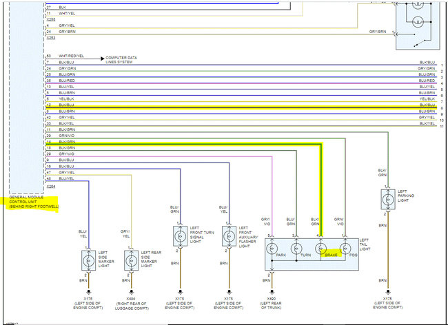

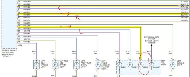

This could be indicating a faulty General Control Module. The two wires (one on each side) need to have 12v. The left wire is black/green and the right is black/blue. Those are the wires for the brake lights. The purple wire is for the left side only and controls a fog light in that light assembly.

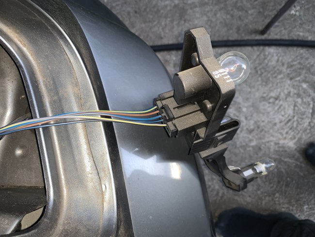

What I need you to do is check for power out at the control module. It is located on the right side of the vehicle, behind the kick panel.

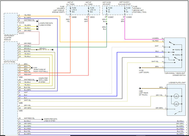

I attached four pictures below. This is the entire wiring schematic for the exterior lighting system. I had to cut the two pics in half to make them readable, so that's why there are four. I did overlap them so you can follow from one to the next. Additionally, I highlighted the wires in question. When you go to the module, check to see if 12v is there. If it isn't, chances are the module is bad.
Since you have 12v to the fog lamp, that tells me the control module is receiving the correct amount of power. So, you could have corrosion at the connection, a poor connection due to connector pin damage, or the module may have failed internally.
