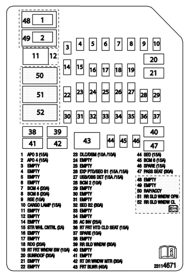

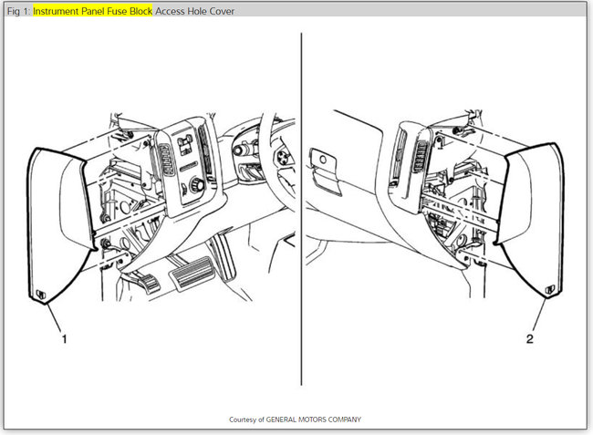

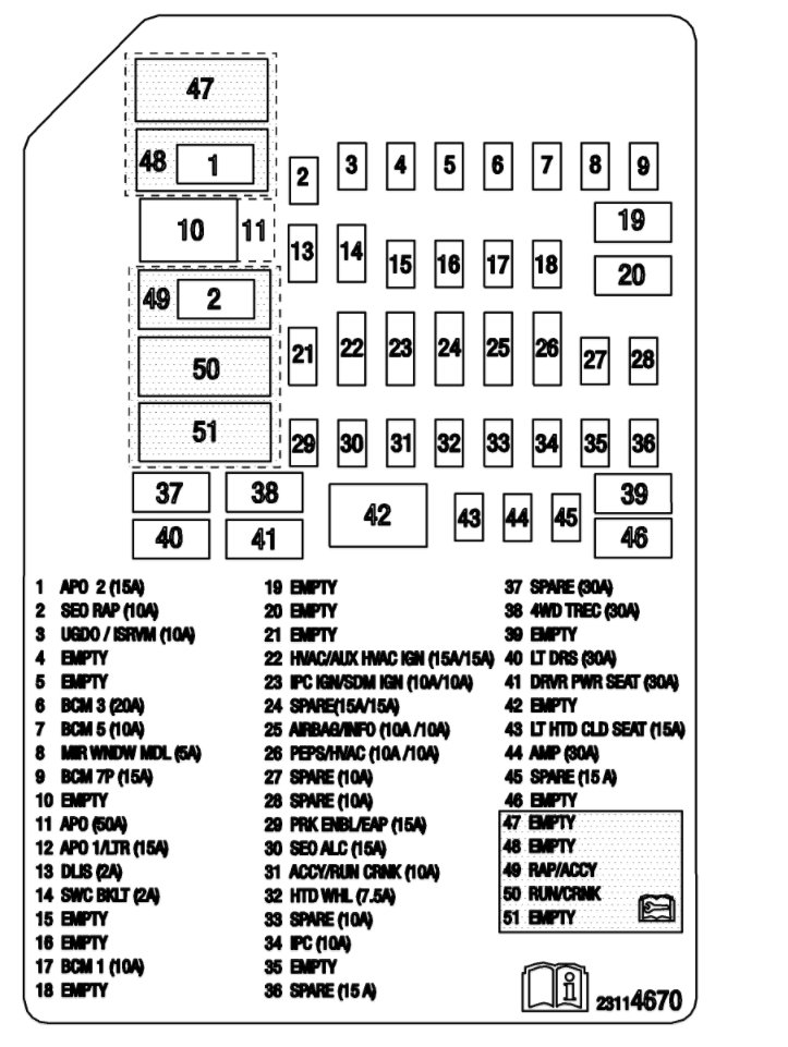

Rats can cause issues with wiring, that's for sure. Can you look under the truck to see if there is any obvious damage? Let's start by checking the fuses # BCM 4 BCM 6 BCM 7 on the right side of the dash fuse panel. This guide can help, and I have included the fuse locations as well. If the fuses and wiring harnesses are okay the BCM could be going out but to be sure let's do a CAN scan which is easy to do, this guide and video will show you how. They have CAN scanners for about $40.00 now on Amazon.

So, I checked the fuses with the key on and found the LH side #33(spare) has no power on either side of fuse and on the RH side #10(cargo) has no power either side of the fuse. Otherwise, all other basic fuses on these panels have power on both sides.
Jun 27, 2022 at 6:07 AM
  • 55,649 POSTS
Yep, that is normal. The power is supplied by the BCM through the fuse then onto the lights. I would do a CAN scan to confirm the failure. You can use the scanner for other car repairs as well.
