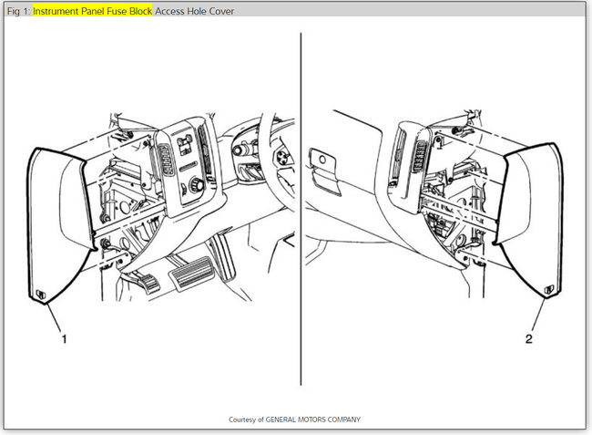

I went out to my truck one night and the two taillight assembly brake lights were on, and they won't go off unless both battery grounds are unplugged. The third one comes on when the brake is applied. I noticed a deceased rat by my truck before this. Did he chew another hot wire that is touching those hot wires? Flasher module? Help. Please and thank you.
Jun 26, 2022 at 6:10 AM
  • 55,224 POSTS

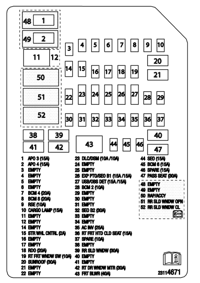

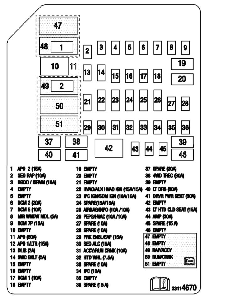

Rats can cause issues with wiring, that's for sure. Can you look under the truck to see if there is any obvious damage? Let's start by checking the fuses # BCM 4 BCM 6 BCM 7 on the right side of the dash fuse panel. This guide can help, and I have included the fuse locations as well. If the fuses and wiring harnesses are okay the BCM could be going out but to be sure let's do a CAN scan which is easy to do, this guide and video will show you how. They have CAN scanners for about $40.00 now on Amazon.

So, I checked the fuses with the key on and found the LH side #33(spare) has no power on either side of fuse and on the RH side #10(cargo) has no power either side of the fuse. Otherwise, all other basic fuses on these panels have power on both sides.
Jun 27, 2022 at 6:07 AM
  • 55,224 POSTS
Yep, that is normal. The power is supplied by the BCM through the fuse then onto the lights. I would do a CAN scan to confirm the failure. You can use the scanner for other car repairs as well.
