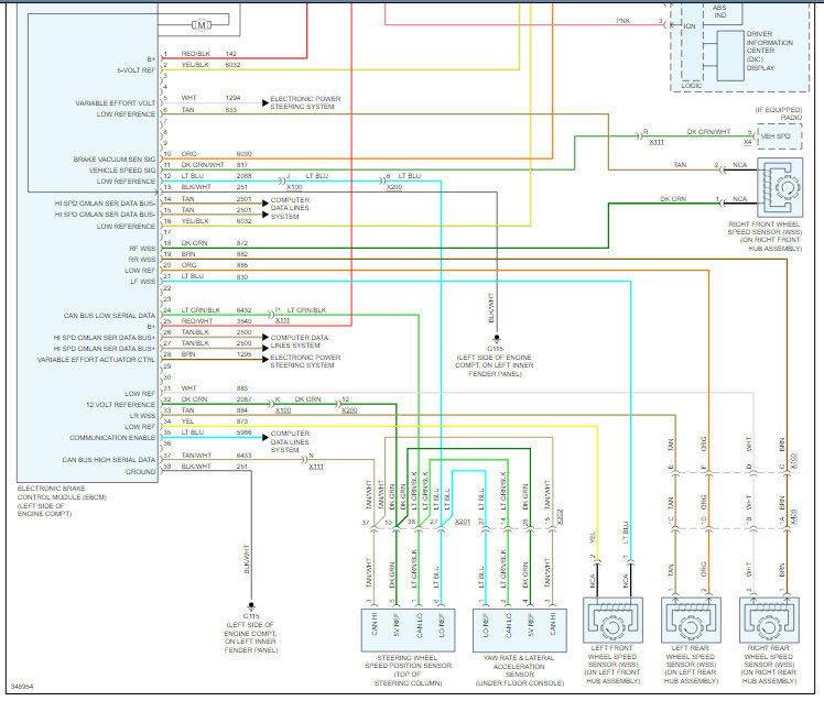

Also three service stabilitrac light comes on. I've replaced the brake switch, checked the fluid, and checked the bulbs. I am at a loss on what to do next.

There's no check engine light. It's just the traction control light and it says service stabilitrac traction control disabled. I tried to pull a code and there's not one that pops up. The brake switch I replaced. Does that switch need to be programmed at all?

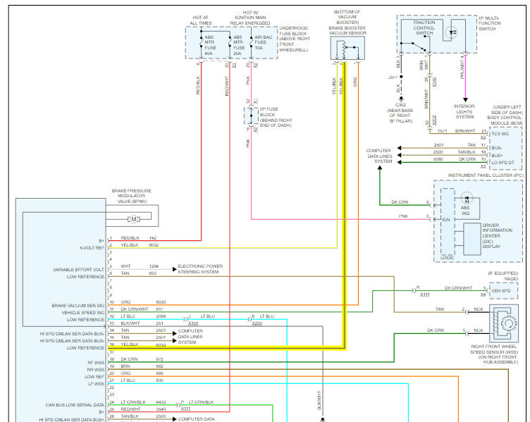

Since the brake lights are staying on it will definitely register a fault in the stabilitrac system.Brake light switches are not programmable.You will have to use a GM Tech 2 or equivalent scan tool to retrieve data/faults. I've attached below the brake system wiring diagrams if you want to inspect wiring for shorts/looseness/corrosion.I split the page in 2 pictures to appear larger.Hope this helps and thanks again for using 2CarPros.

If I can jump in. The brake switch does not require to be reprogrammed but when you pulled codes did you use a scan tool that can communicate with the ABS module? If not, then there will be no codes. As Danny stated, with this light there should be a code that goes along with it so let's just make sure that tool can talk to your ABS and go from there. Thanks
