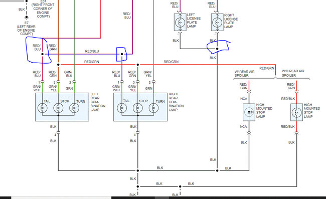

This is going to take a few tries. If you look at the attached pic below, I circled the wires that are near the high mount brake light which will have constant power when the headlamps are turned on.
Let me know if the 3rd brake light comes on with both the headlamps and the parking lamps. Next, for that light to come on with the headlights, there has to be a short to power in one of the tail light/parking lights wiring. Follow the red/green wire back from the light itself and see if you can find anywhere it is damaged and shorted. The red/green wire to the third brake light isn't too long. It will tie into the brake light wiring in the rear of the vehicle.
Let me know what you find.

Yes, the 3rd light stays on with parking and headlights and I actually just double checked and follow the wiring from brake lights socket to 3rd light and everything seems fine with the wires. It is very weird because I think the ground cable was half broken and I had the problem with the one brake light but it broke completely and then the 3rd like problem came up. now that is replaced I am not sure was it happening a short a ground problem, so confused.

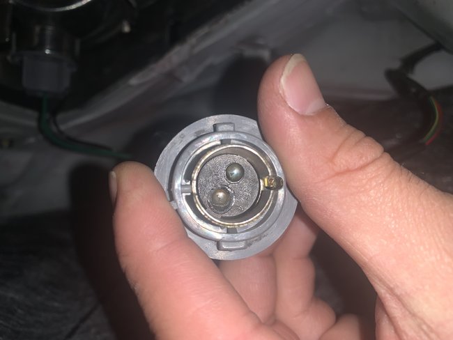

it has to be a short or something because the tail lights are less bright than they usually are, but if wiring is fine what else can cause this short? I’m also replacing this socket tomorrow it seems to make contact but just looks a little like melted. i don’t know if the can cause this I did attach a picture of it.
Nov 19, 2020 at 6:33 PM
  • 110,194 POSTS

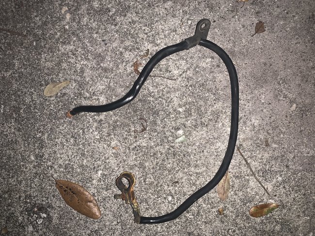

I see the pin on the left looks like it is lower. What ground wire was bad? If you have a bad ground, it is possible that power is back feeding through the third brake light and turning it on. Also, a weak ground will cause the lights to be dimmer than normal.

battery ground wire I replaced with a 4 gauge one, but looking at the original one it has like 2 parts like it screws to the chassis twice. the one I got just one time at the end not sure if that makes a difference. Lights are a lot dimmer and yes most likely a ground problem, just not sure what ground wire I should be looking at now.

The cable you have looks like the connector went to the body and the opposite end without the connector likely went to the engine. Where did you attach the new one?
Nov 19, 2020 at 7:39 PM
MANUEL12344
  • 7 POSTS
yes, the original one was attached to the body and the other end which it broke was attached to engine or transmission. the new one I attach it to engine or transmission not the body.
