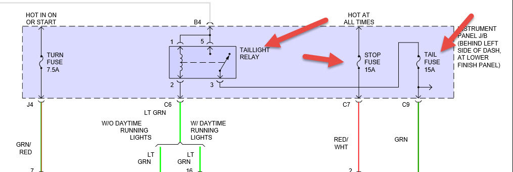

came to replace to brake light not working. I tried replacement bulb but blew within two minutes. then discovered that both tail lights and rear door brake light were out. I checked 10 amp fuse, but it was fine. now I cannot use car without tail lights. any ideas?

we have no information on a starlet model as it's not in US, but what i am sending is from a Corolla Somay be similar. check fuses and taillight relay. for brakes see if power goes in and out from multi function switch and also check for a shorted wire as it blows the fuse.
