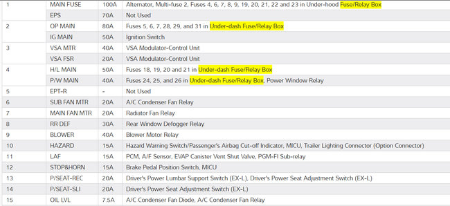

All three brake lights are not working. Fuse and bulbs appear to be good. Changed brake switch but that did not solve the problem.
What next?
Aug 18, 2018 at 9:20 AM
  • 55,746 POSTS

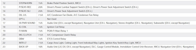

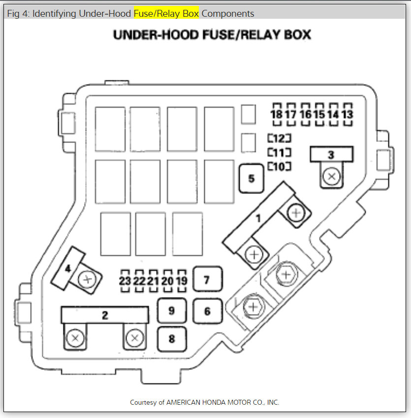

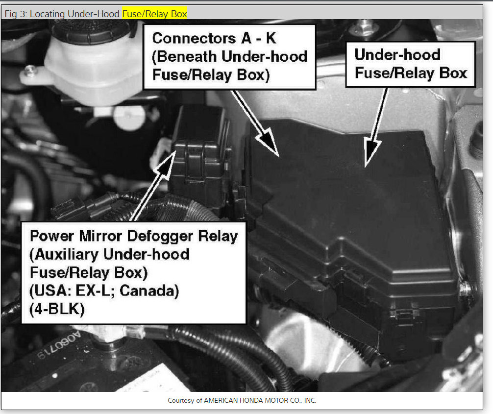

I would start by making sure there is power at fuse #19 and #10. Here is a guide and the fuse locations to get us started:
Check out the diagrams (below). Please let us know what you find.
