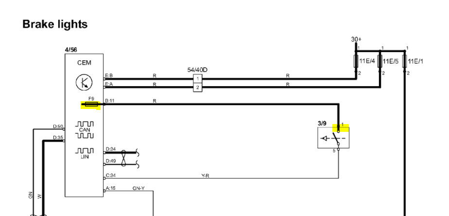

Hello, I'm having a problem car stuck in park . brake lights not working. Replaced brake switch and bulbs still no results. Any info would be helpful.

It sounds like that you are either missing the 12V supply to the brake light switch or there is a possible wiring fault.
First check fuse 9, 5A, at fuse box in passenger compartment. I have included a link below.
https://www.autogenius.info/volvo-xc90-mk1-first-generation-2006-fuse-box-diagram/
If this fuse is in order then check the connector at the brake light switch.
Pin 1, red wire , is supplied 12V from the fuse box to the switch. This can be done by either using a test light or a multimeter. How to use these please see below.
and
Using the below illustration of the wiring diagram you can also test the 2 wires from the brake light switch going back to the fuse box. The red wire supplies 12V from pin 11 at connector B to brake light switch pin 1 and the signal from the brake light switch comes from pin 5 at switch, yellow/red wire, to pin 34 at connector C. How to test a wire please see below.
Please let us know how you get along.
