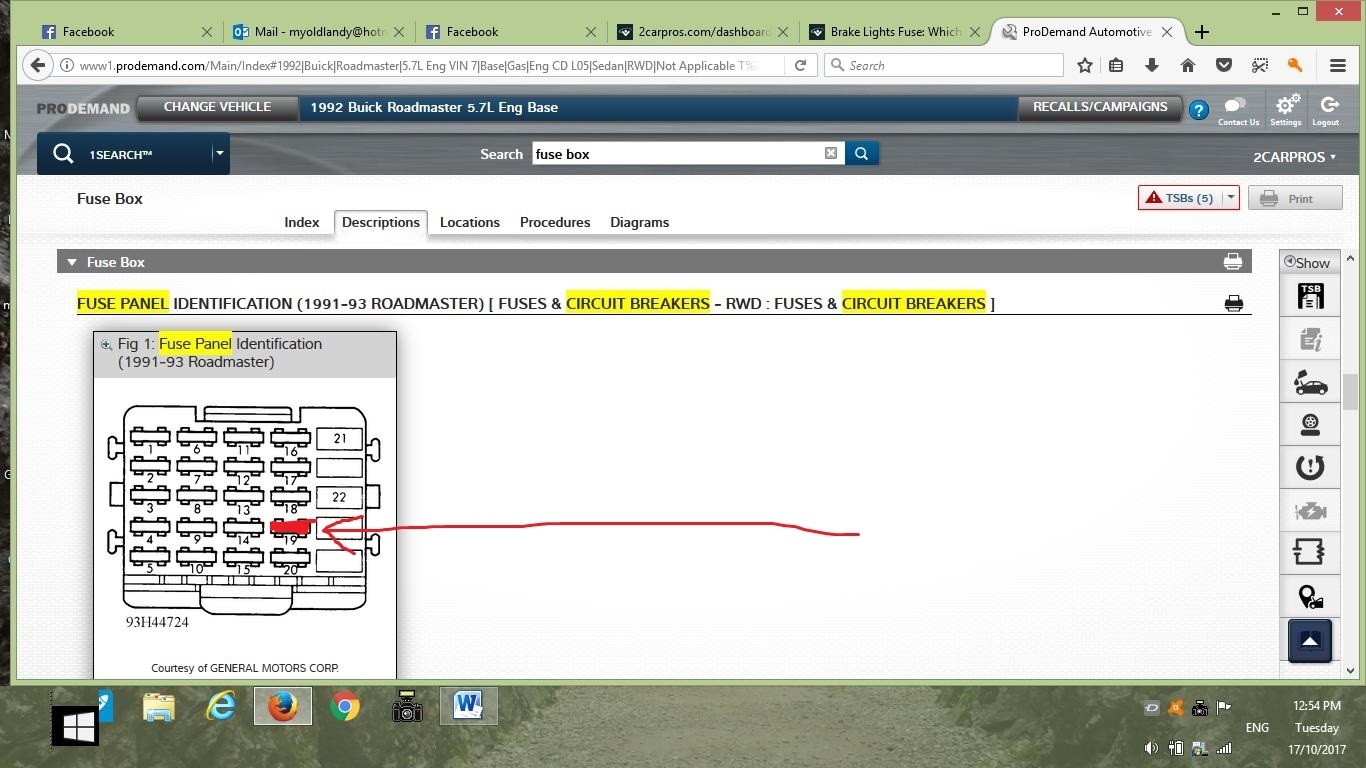

Which fuse is for the brake lights?

fuse 19 as shown in picture.
