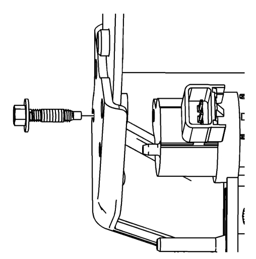

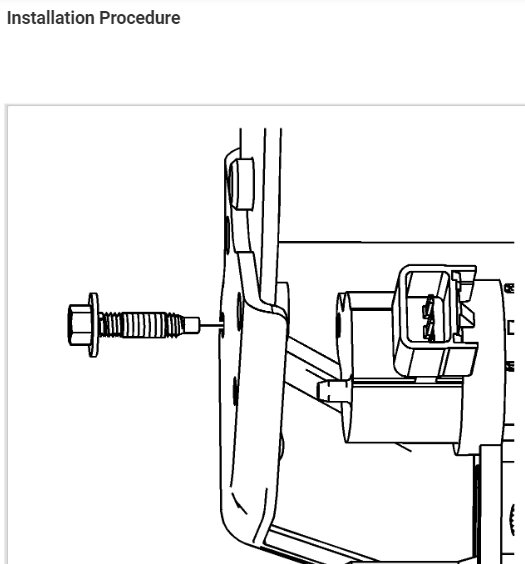

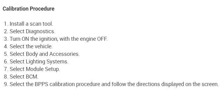

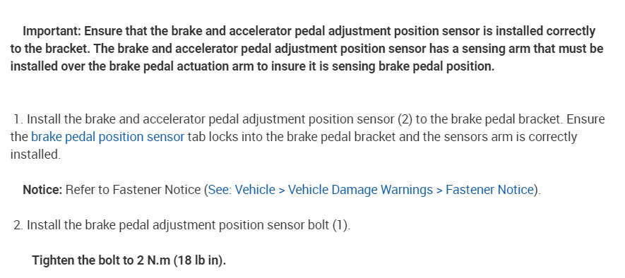

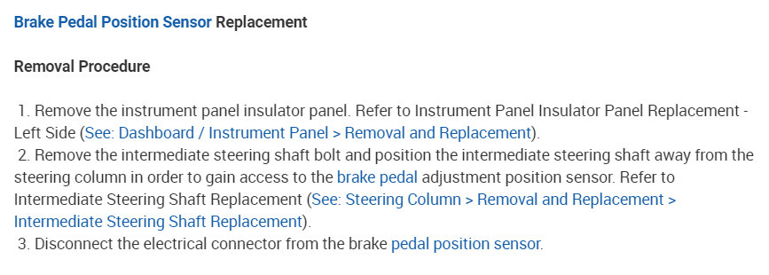

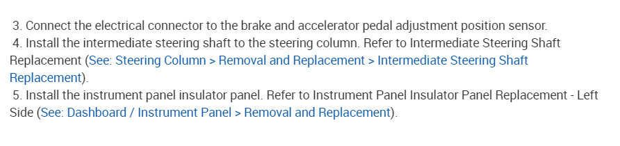

My turn light work but my brake lights don't work. can anyone help?
May 27, 2020 at 3:09 AM
DANNY L
  • 5,648 POSTS
Hello, I'm Danny.

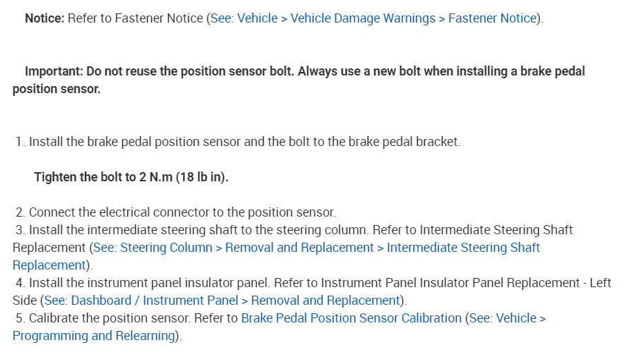

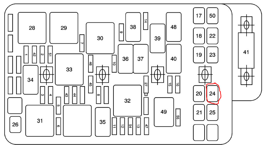

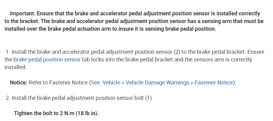

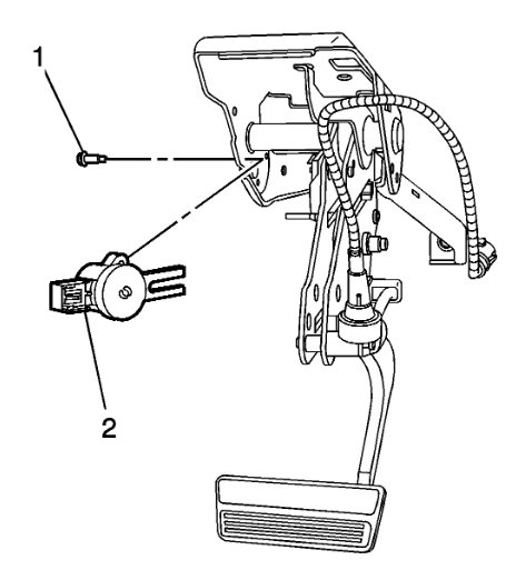

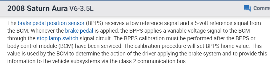

First thing to check should be fuse #24 in the under hood fuse box next the the cars battery. The other thing that might be causing the problem is the brake pedal position switch which is mounted to the brake pedal assembly . I've attached picture steps below on how to test and there locations.Hope this helps and thanks for using 2CarPros.
