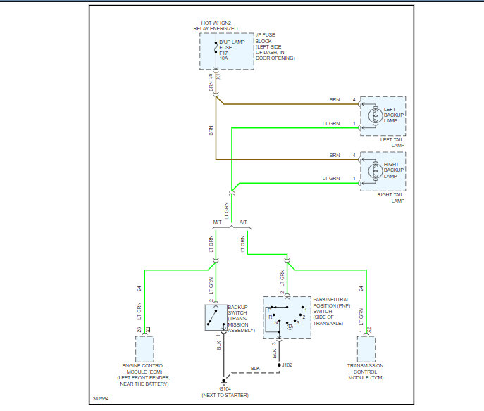

Checked the fuse, wasn’t burnt . Changed it anyways. Lights also aren’t burnt out, but the dome light doesn’t work and the reverse/back-up lights do not come on when put into reverse.

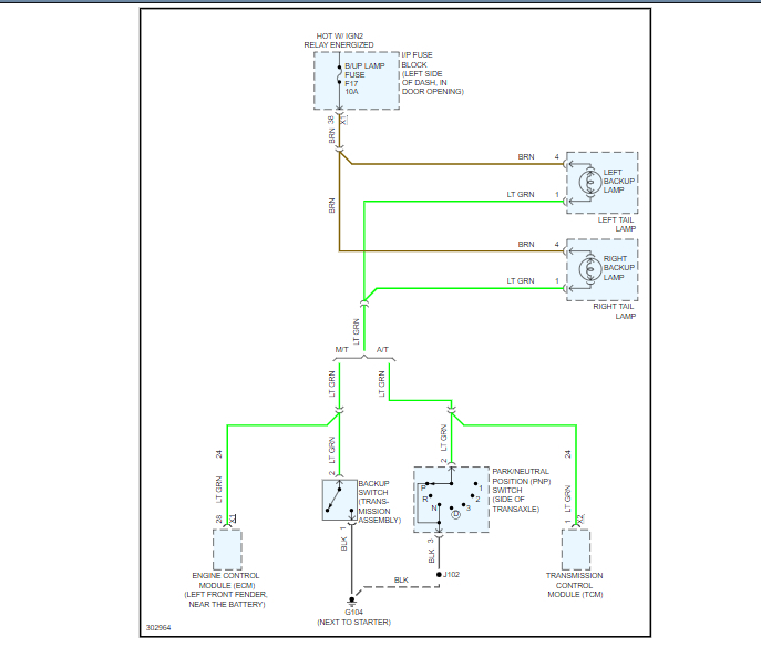

Sorry, brake lights work fine, as well as blinkers and running lights. Only the reverse lights do not come on.

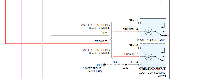

The light inside by the sunroof switch doesn’t work either. But the sunroof does work

Got it.
You will need to get either a test light or volt meter to do some voltage checks.

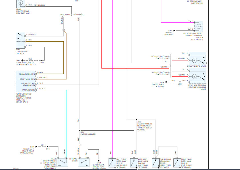

I attached wiring diagrams for you to view and when you get something to test with, we can continue to find the failure.
