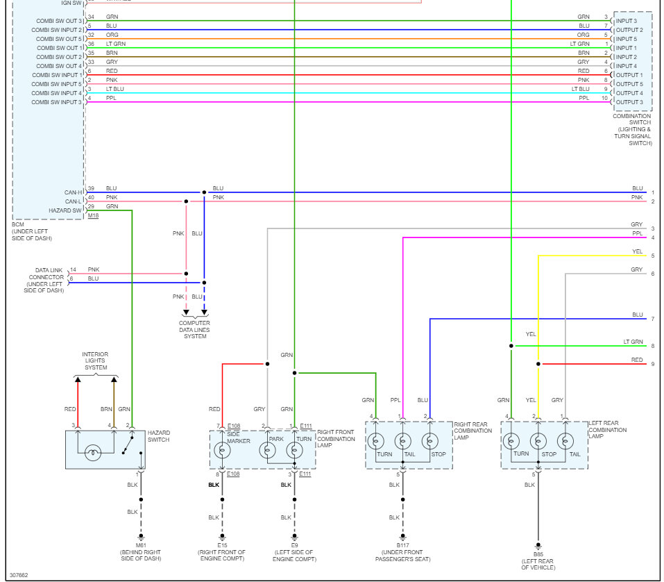

I’ve recently changed the brake lights on my vehicle; the issue is that they work as hazards, but not actual brake lights. There’s continuity on all the breakers the socket itself, and my battery is running at a bit low. Low enough to take a few seconds to start, but fine otherwise. Is there any other diagnostic criteria that I’m missing?

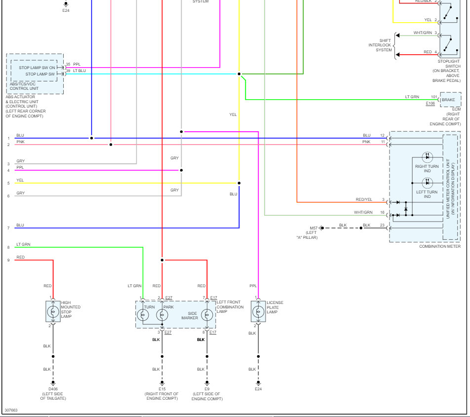

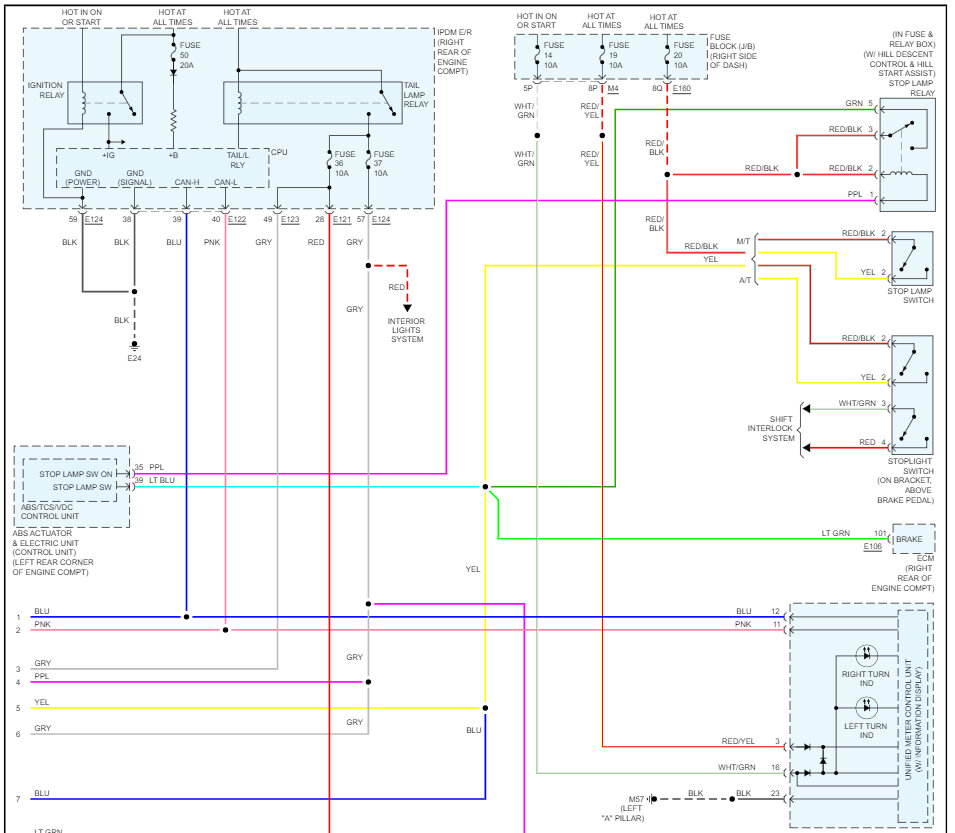

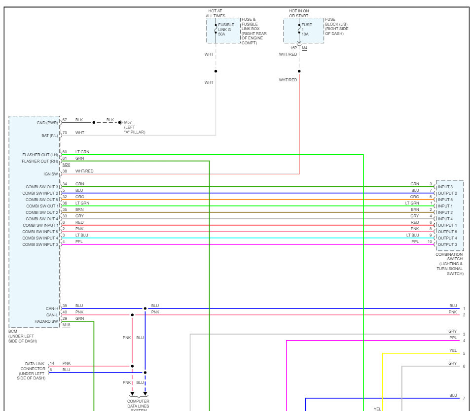

Do you have power at the fuse # 20 on the right side of the fuse panel?
This guide can help:

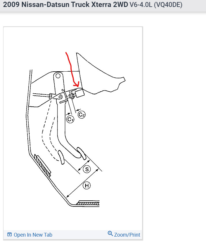

If so, please test through the brake light switch, here is the location in the images below, also please go over this guide as well:
https://www.2carpros.com/articles/brake-lights-not-working
Here are the brake light wiring diagrams so you can see how the system works. Check out the images (below). Please let us know what happens.

I haven’t tested the brake switch, and I believe that may be where the problem lies. Worst case scenario I will be replacing it as soon as possible.

So, after replacing the old switch, the brake lights still aren’t working. I tested continuity on the connection to the switch and found that the connectors top female ports do not have continuity. Does this mean I need to change out the wire harness?

On the brake light switch do you have power at the red/blk wire?
Test with the key on.

With the key on and the brake pedal depressed do you have power at the yellow wire from the brake light switch?

Yes, I tested both fuse and cable with the key set to on. There is tone on both.
