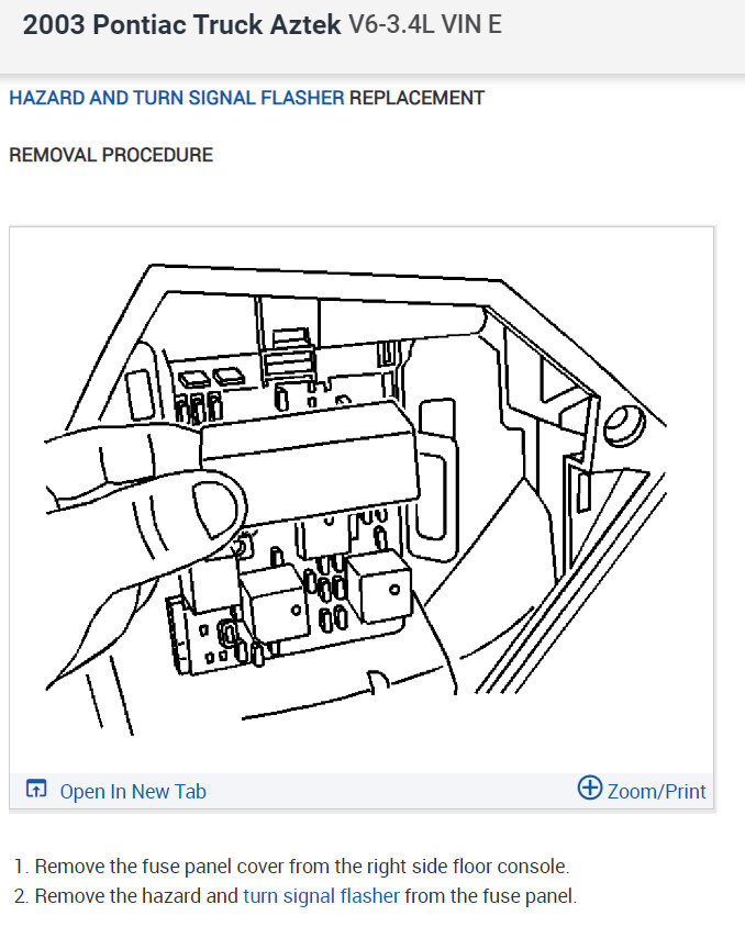

i have a 2003 pontiac aztek the blinkers and brake lights dont work i have checked the fuses and bulbs they are good what could the issue be please help

the hazard switch which is the turn signal flasher is the problem, here is the location so you can change it out to fix the problem. Check out the images (below). Please let us know what happens.
