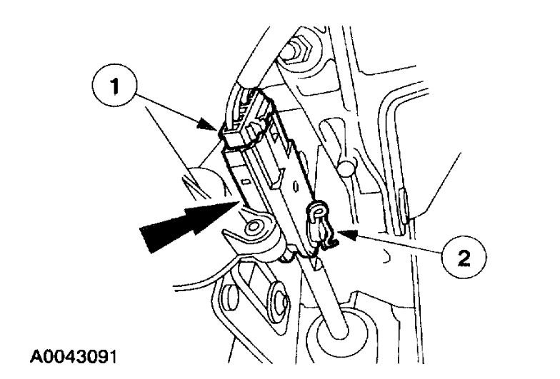

SUV is the Eddie Bauer edition. When I apply pressure to the brake pedal brake lights come on sometimes.
May 18, 2020 at 9:45 PM
Good morning,

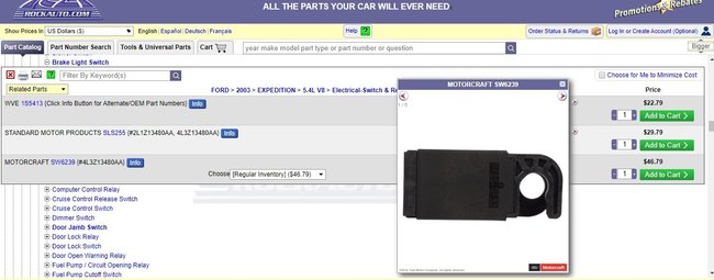

Most of the time it is the actual stop light switch that is the issue.
I attached the part and the procedure for replacing it as well.
BRAKE PEDAL POSITION (BPP) SWITCH
REMOVAL
1. Disconnect the battery ground cable.
2. Remove the BPP switch.
1 Disconnect the electrical connector.
2 Remove the self-locking pin and the BPP switch.
INSTALLATION
1. To install, reverse the removal procedure.
