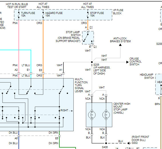

I attached the wire diagram for the lights.
Check the fuse for power on both side. then check for power to the switch. One side should be hot. Then push the pedal and the other side should be hot as well.
The output feeds both the third light as well as the back lights.

Make sure the white wire at the turn signal switch has power with the brake pedal depressed.
Yes, the turn signal switch may be the issue.

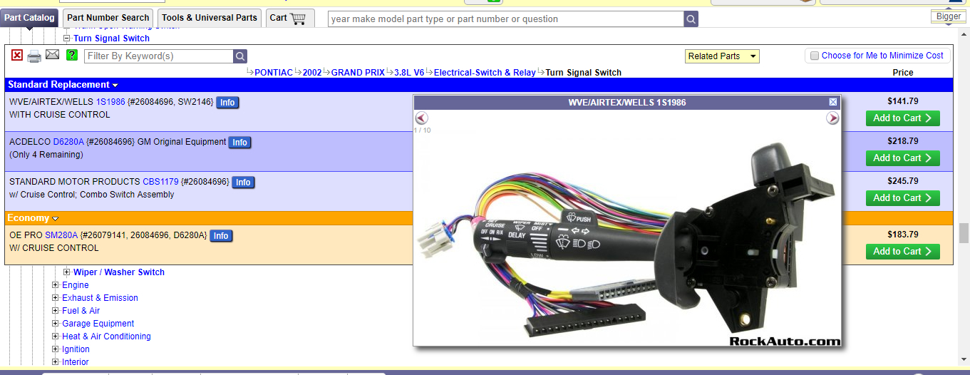

I attached a part diagram from rock auto. The switch is about $150.00.

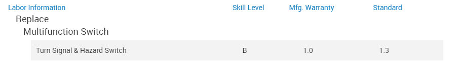

The labor is only 1.3 hours. That is about $125.00.
You need another shop as they are taking advantage of you big time.
