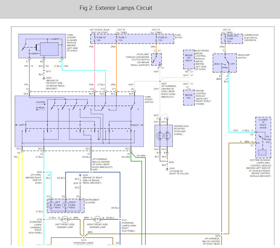

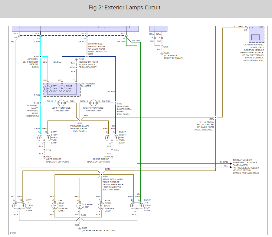

My brake lights do not work and my turn signal also do not work. All lights are fine all fuses are good, flashers do work.
Aug 24, 2018 at 1:31 PM
  • 55,309 POSTS
We are losing power somewhere which I think is the turn signal switch. Here is a guide to help you test for power and the wiring diagrams to help see how the system works:
Test for power though the switch. Check out the diagrams (below). Please let us know what happens.
