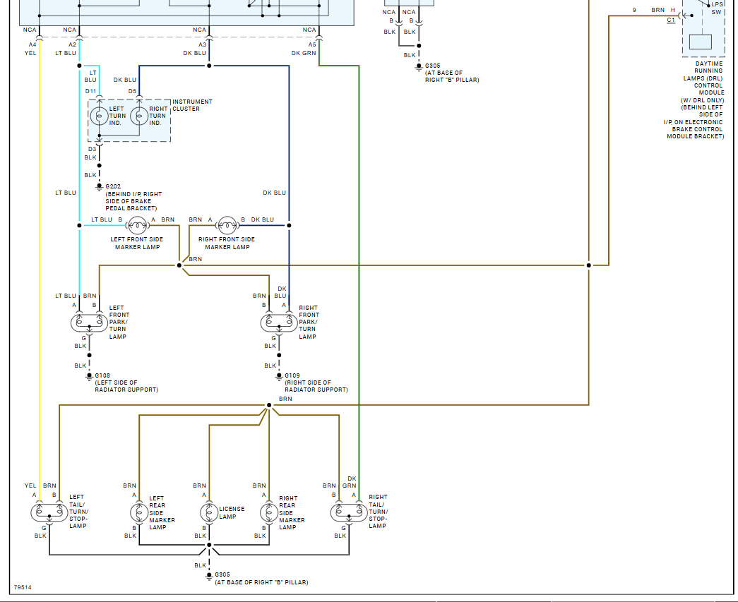

Brake light in rear window works fine. No brake lights on rear of vehicle. Running lights and turn signals all work fine.
Mar 18, 2025 at 2:20 AM
  • 55,673 POSTS
I would check the bulbs first; one can go out and then the other down the road. Here is a guide to help with the problem so you can go over it:
https://www.2carpros.com/articles/brake-lights-not-working

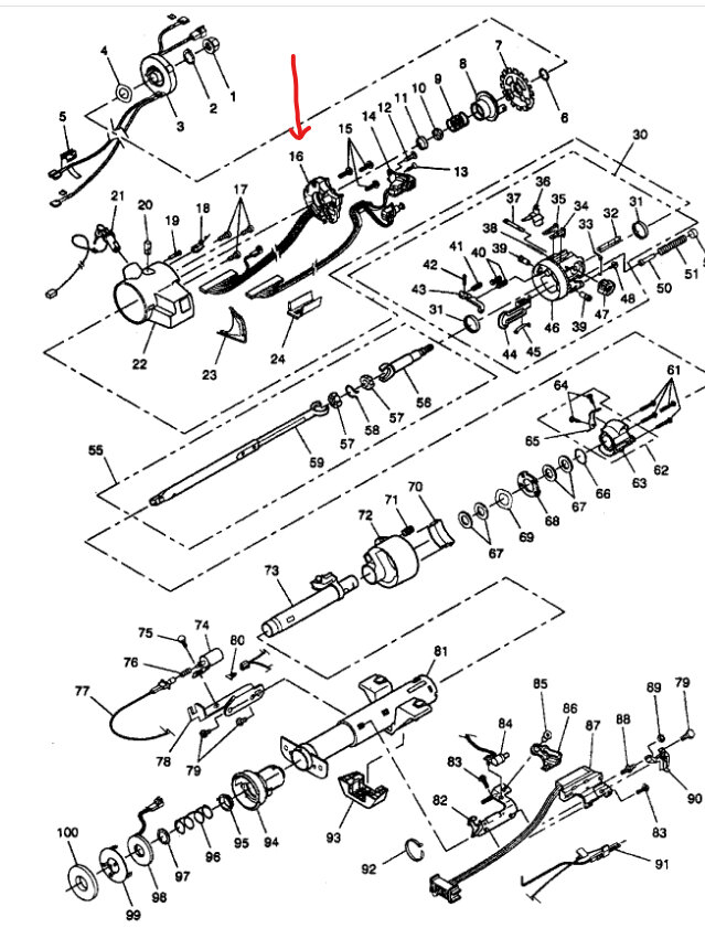

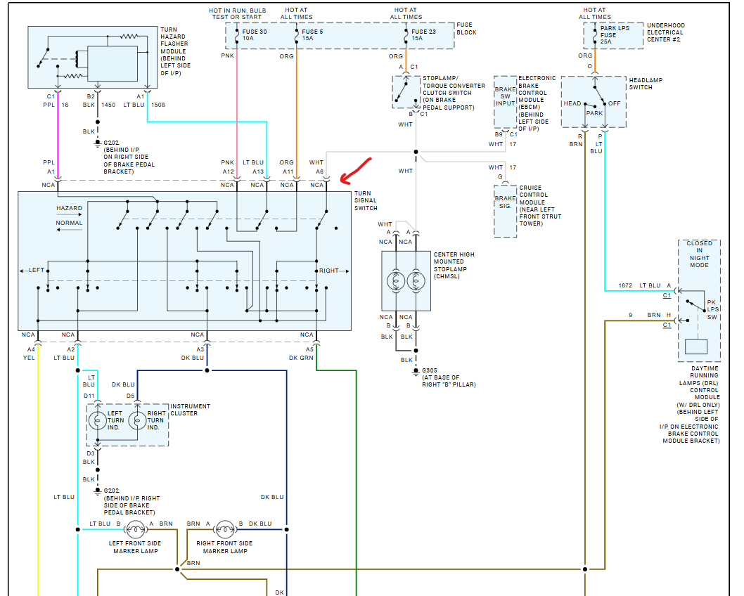

If the center brake light works, then the only other item that can fail is the turn signal switch. Here is a wiring diagram for the system so you can see how it works. Also, I have included how to change the switch out. Check out the images (below). Let us know how it goes.

Changed multi-function switch, brake lights work fine. New problem. Drove car to get gas. When I started to accelerate, I heard a sound like fan blades hitting something. Car slowly picked up speed and will not shift unless you let off the gas. Changed filter and fluid with no change.
