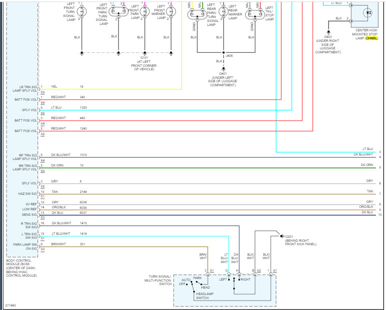

I'm looking at the wiring schematics and it only shows two rear brake lights and one center high-mount brake light. Where are you seeing two?
The brake lamp bulb is a dual-element bulb. One element is a parking lamp and the other is for the brakes.

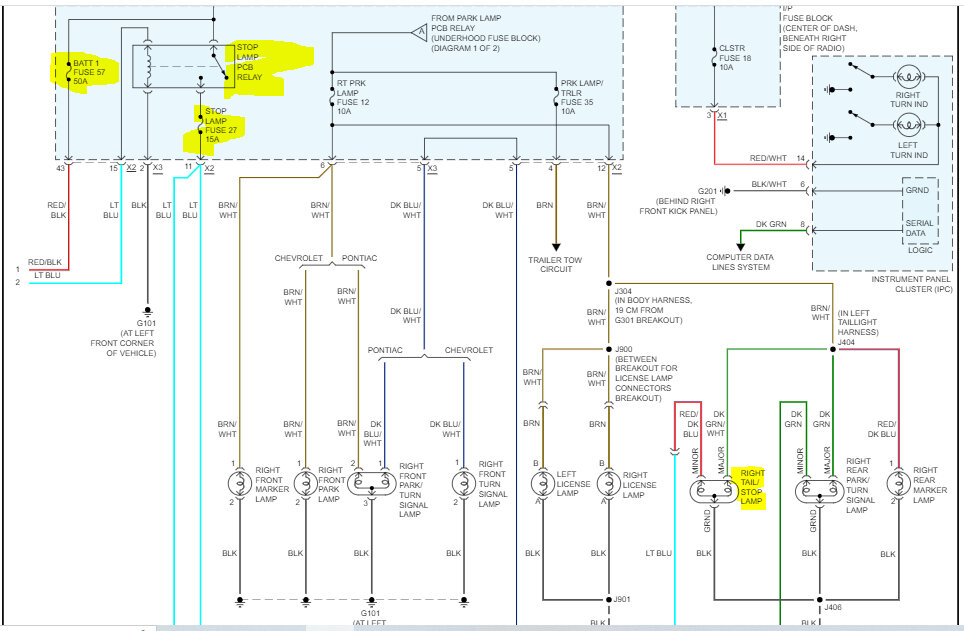

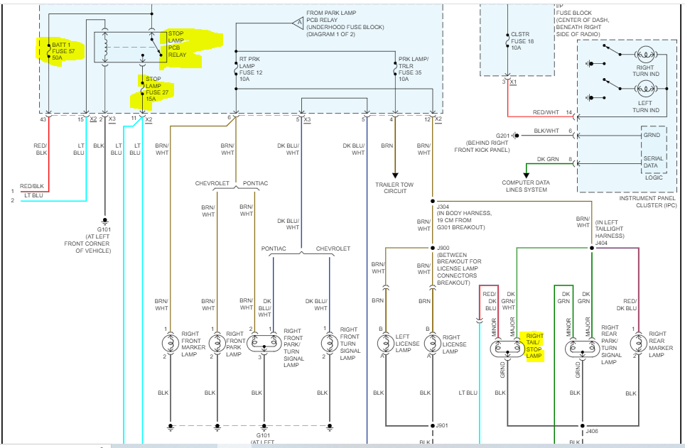

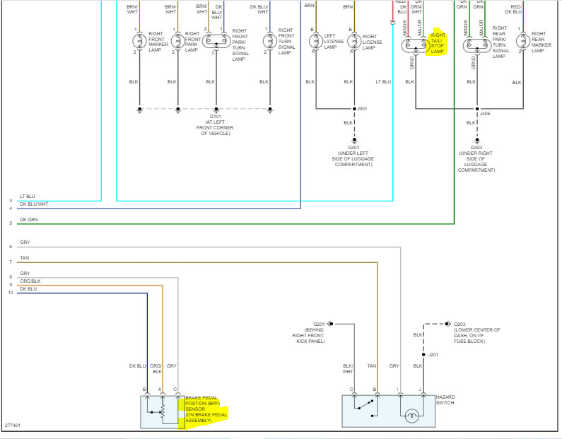

Let me know. I attached the wiring schematic below, so you have a reference. I highlighted the relevant controls.
joe

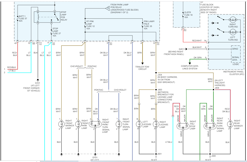

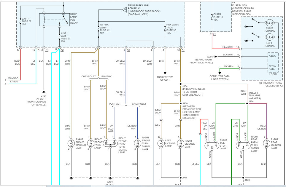

See pics below. Note: I had to cut each of the two pages in half to make them readable. I did overlap them so you can follow from one to the next.
