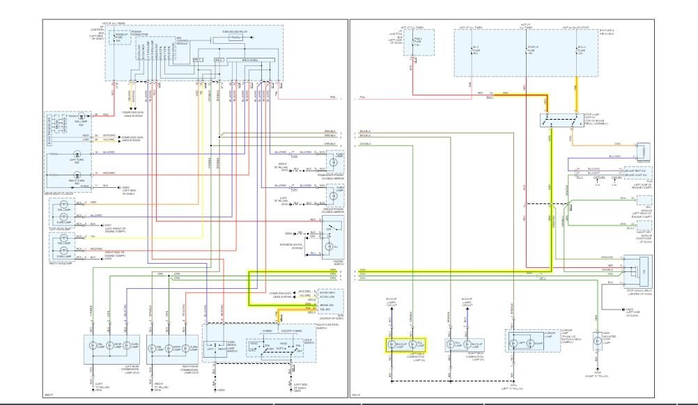

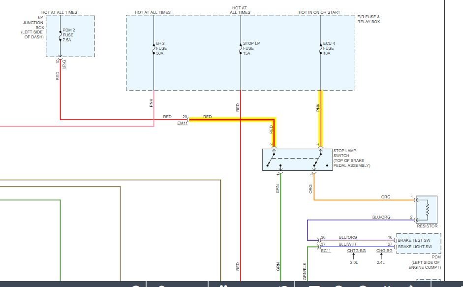

I have replaced the bulbs, the wiring harness and the brake light switch underneath the pedal. All three lights are out and I am thinking that it has to be a fuse. I was going to check but I'm not aware of which fuse it would be since the guide does not blatantly say brake fuse. Can any one help please I don't know which fuse to tackle?
Mar 19, 2019 at 9:15 AM
Good afternoon,
I attached a wire diagram for you to view. Verify both fuses have power on both sides. Also, check for power to the switch with a voltmeter or test light.
