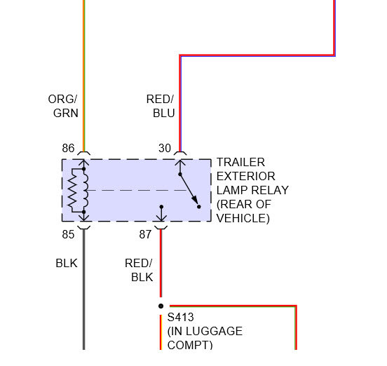

Park lights are staying on. I put in a new brake switch part and the lights are still staying on unless I unplug battery. The brake lights do not work when I am stopping. I am a lady and nothing is working.
Jul 5, 2016 at 6:52 AM
HMAC300
  • 48,601 POSTS
check the item in trunk in picture its a relay it may be sticking. see picture.
