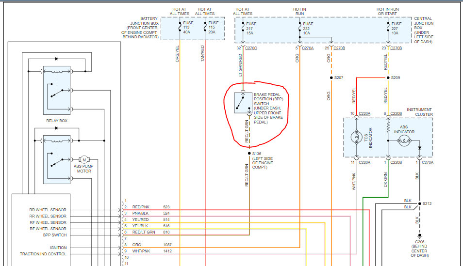

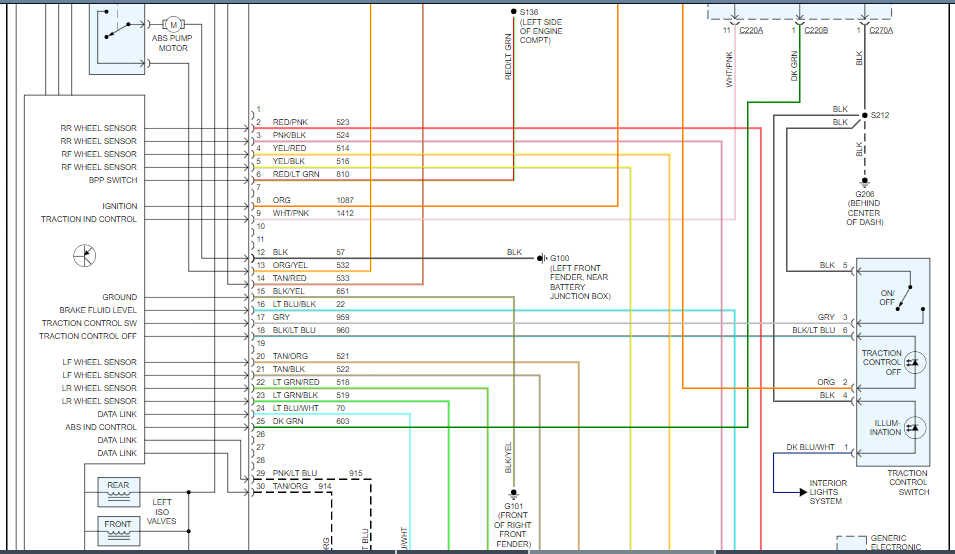

My brake light switch plug pigtail somehow wrapped itself around my steering shaft. The pigtail broke off at a location that I cannot find. If I can find the opposite end I can splice them back together. Any advice is appreciated greatly.. thank you for your time.

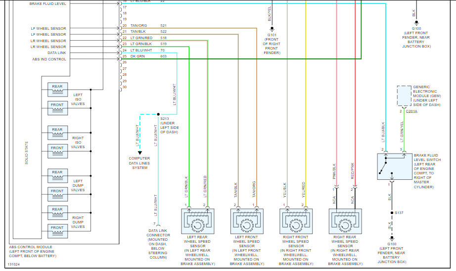

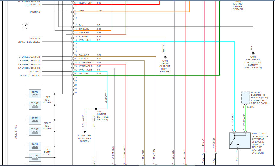

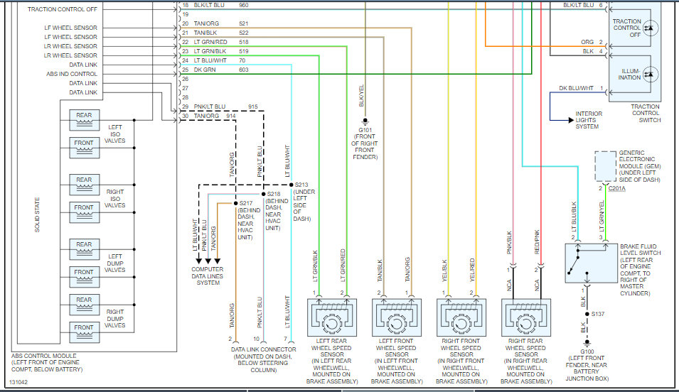

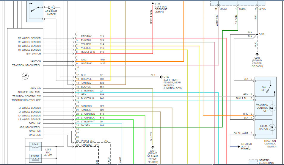

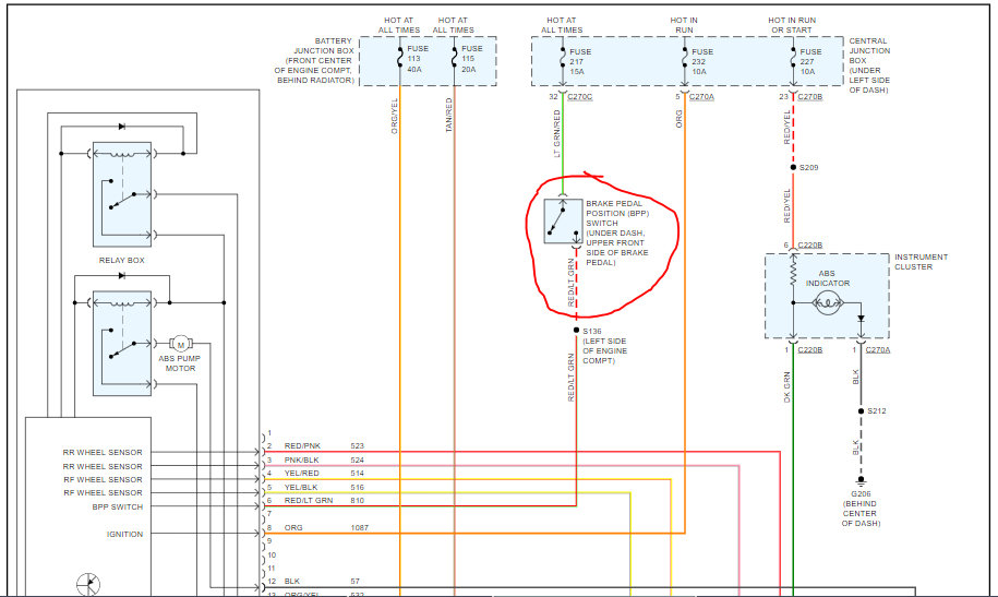

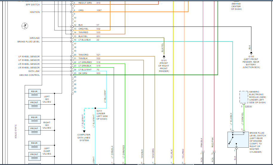

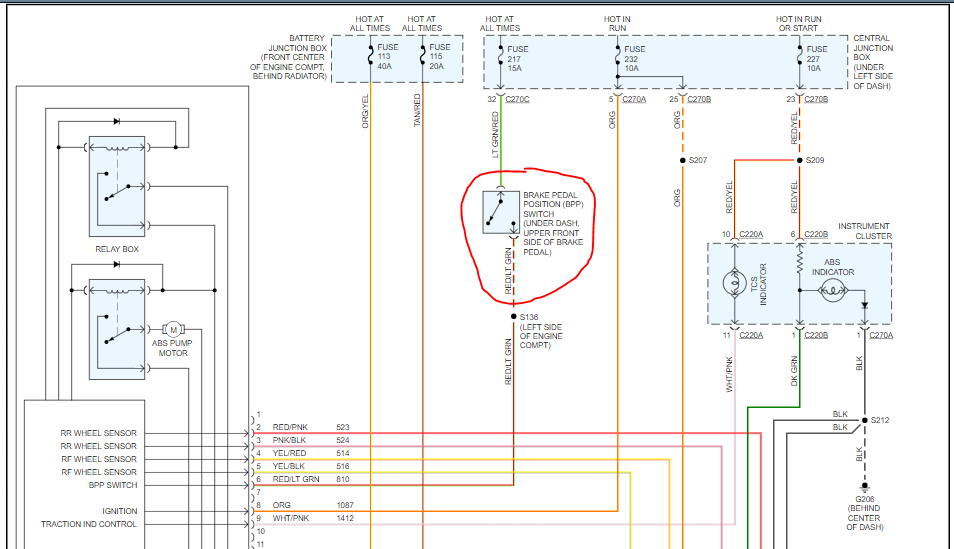

I've attached brake light switch diagrams below for you to trace the wiring. Here is a tutorial showing how to test vehicle wiring:
I've cut both pictures into 3 pieces each so you can view larger. The first 3 pictures are for a Taurus with traction control and the last 3 are for without traction control. I've also circled the brake light switch in red. Hope this helps and thanks for using 2CarPros.
