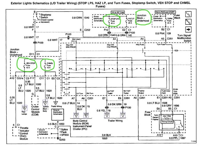

My brake lights quit working. Replaced the brake light switch, didn’t help. Checked the connector and wasn’t getting power.

If it isn't getting power there is a 20 amp Stop Lamp fuse in the under hood fuse box, Use a test light and see if it is blown. It powers both the CHMSL and the lower brake lamps. A quick test would be to turn on the hazard lamps, they are powered through a different fuse. If they work normally then it could be the fuse or the wiring under the box, which is a common failure item as they corrode easily.

All the fuses are good except Stop LP. And the hazard lights are working

OK you had power on one side of the fuse? If yes then replace the fuse and see if the lights now work. If you don't have power on at least one side of the fuse then there is a problem inside the fuse box.
