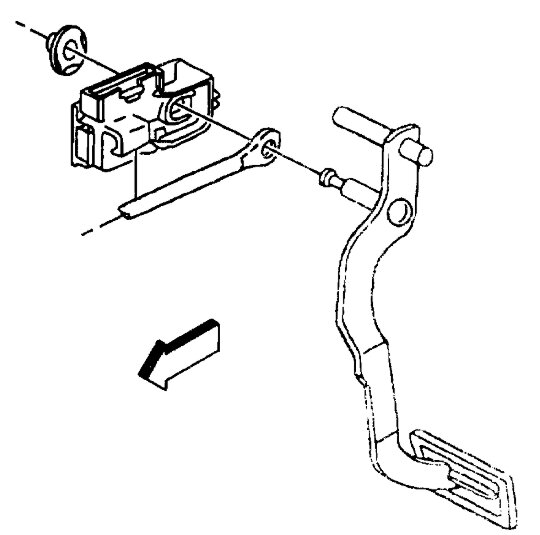

No brake lights
Aug 2, 2025 at 9:53 PM
  • 55,112 POSTS
The brake light switch is located near the top of the brake pedal arm. Here is an image of the switch. I would check the MAXI fuse#2 30 amp in the fuse panel under the hood. Also, there is a stop lamp control relay in the same fuse panel I would swap out.
This guide can help as well
https://www.2carpros.com/articles/brake-lights-not-working
