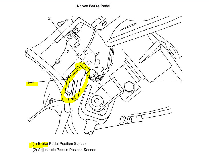

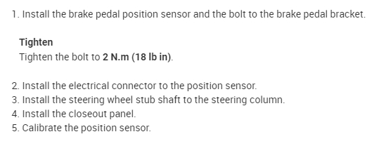

Could you please point out where the brake light switch is at on brake pedal. A diagram pointing to it would be helpful.

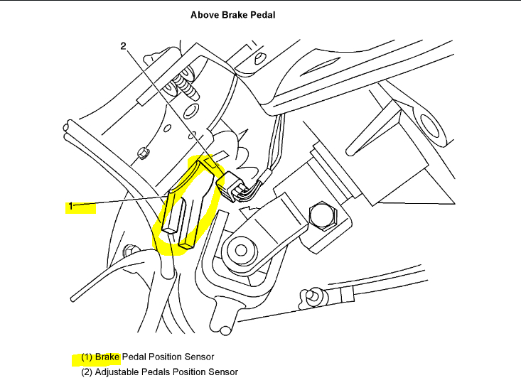

It's located at the top of the brake pedal assembly. If you look at pic 1, it shows the switch. I highlighted it for you.

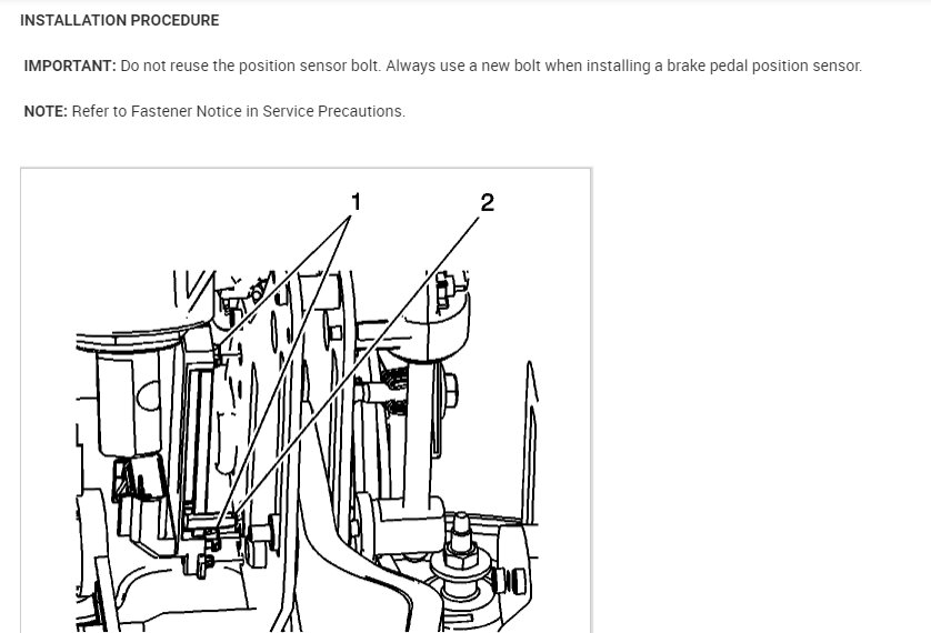

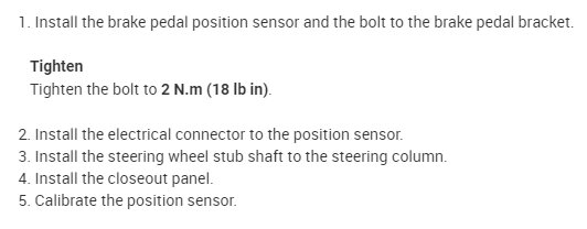

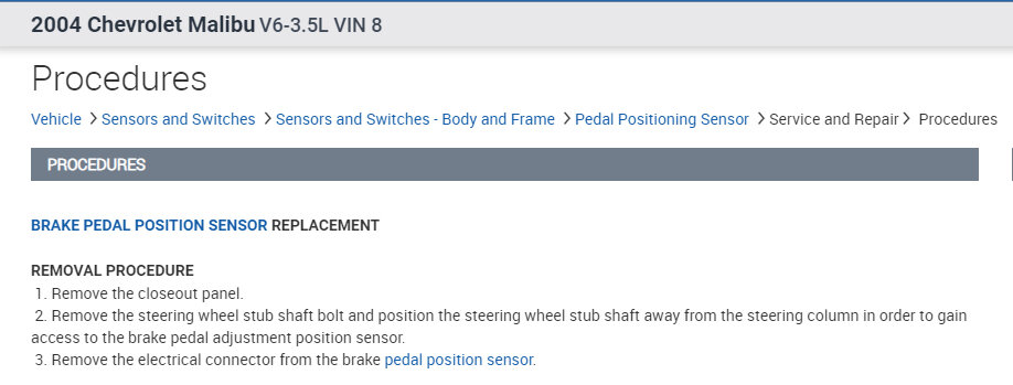

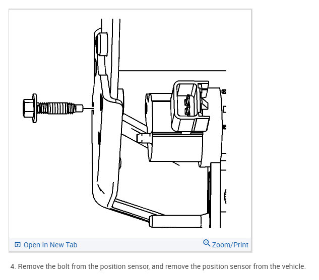

The remaining pics are for the removal and replacement. Take a look through the directions and let me know if you have questions.
