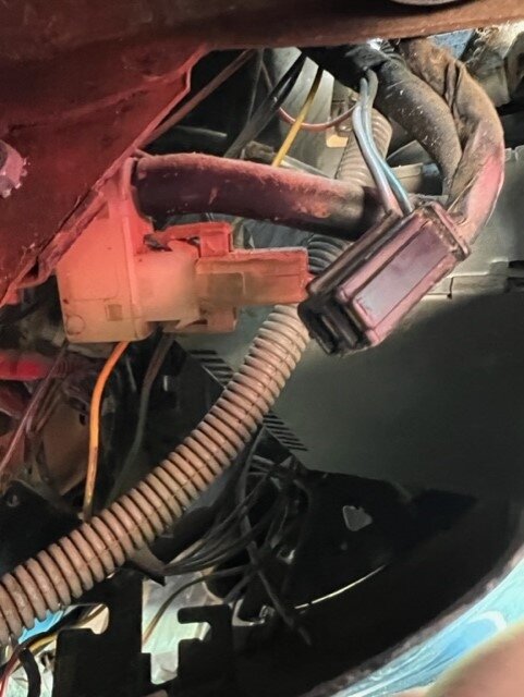

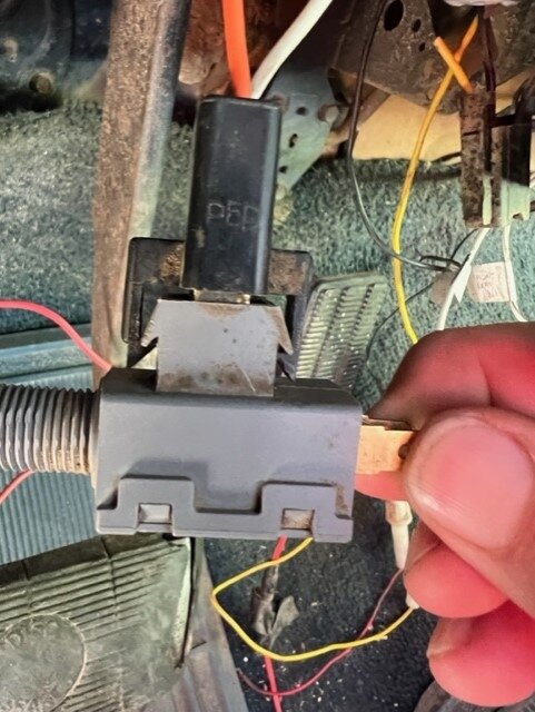

I recently purchased the truck, and the brake lights haven't worked.
I've purchased several new switches that can't seem to get the light to work.
- Power is going to the brake switch.
- Fuse is good and tested both sides of the fuse so it's not the circuit board.
- Replaced bulbs in both outlets.
- I am receiving power to the back end as hazards and parking lights come on.
- No power to socket when brake is applied.

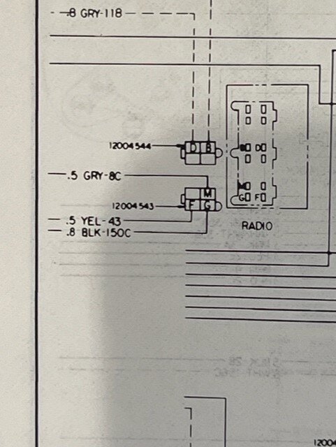

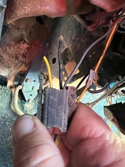

In your third pic, what connector is that? It has two cut wires. The black is likely a ground. The yellow may be related to the brake lamps, but I need some more information.

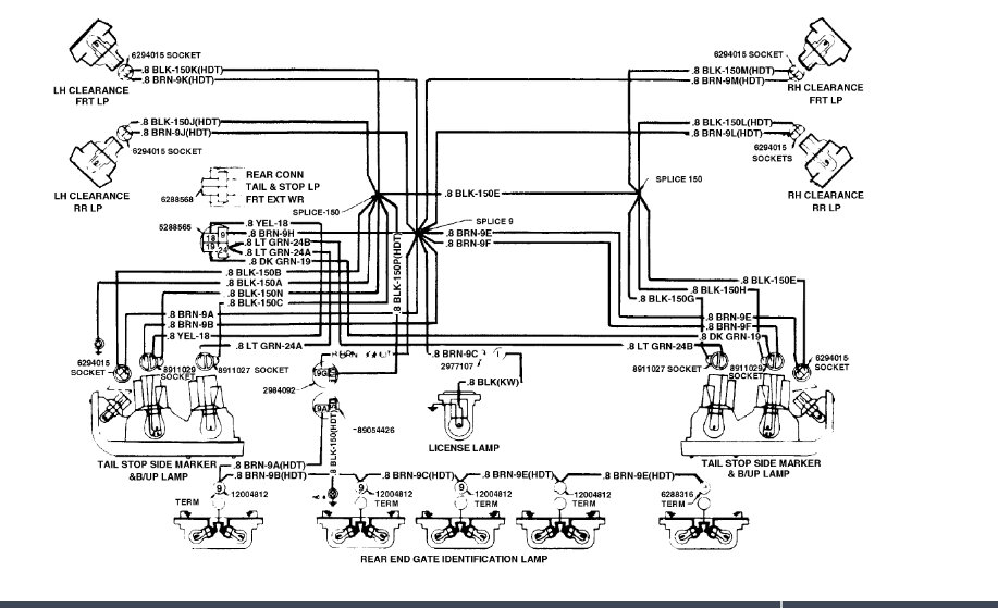

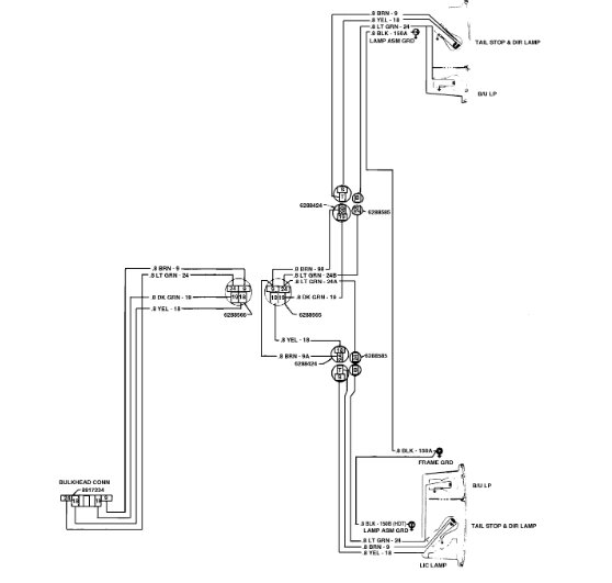

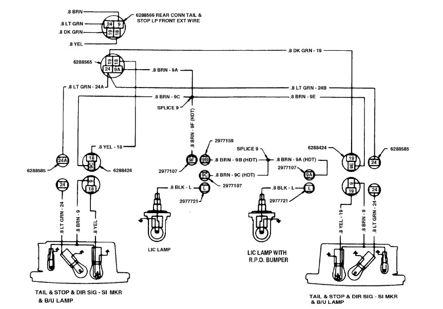

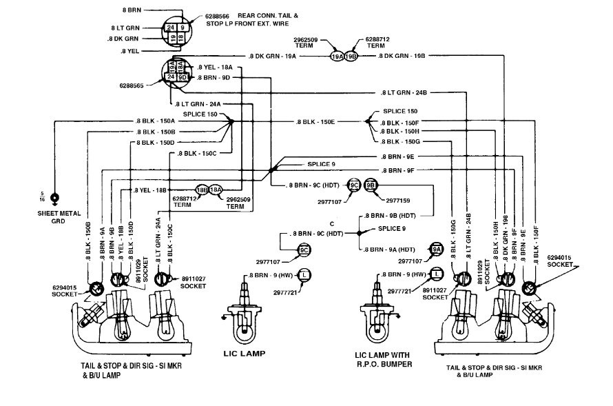

If you look below, I attached several wiring schematics all related to the rear lighting. Note that each one is different based on the body style (crew cab, regular cab, step-side, and so on). I need to know which one you have.
Take a look at them and let me know which you are dealing with. Interestingly, the pic with the cut wires appears to have another black wire along with an orange wire. Orange doesn't show up on any of the schematics.
Also, is there power out from the brake light switch?
See pics below. Pic 1 - Crew Cab Rear Lighting
Pic 2 - Fleetside Rear Lighting
Pic 3 - Stepside Rear Lighting
Pic 4 - Wideside Exterior Lighting

The truck is a fleetside. I was thinking the photo above with the three wires was for the radio. I attached an image below, which i pull from my1982 light duty service manual. But if you think that's it happy to try.
Sep 29, 2023 at 12:33 AM
  • 110,248 POSTS
Pic 3 above is for the exterior lighting and the fleet side. Were you able to locate the connector in the rear of the vehicle? Is there power present there?
Also, you are likely correct about the cut wires. The connector looks a little off for it, but anything is possible.

The new information today is that I have a Cruise Control Release Switch. So, the brake switch I need is one for cruise control which I have. The cruise control release switch button seems to be moving in and out but might need to be replaced.

My mistake is not the parking brake, taillights and hazards. now I can't get power to the brake light when I press on the brake.
Oct 1, 2023 at 12:51 AM
HOGANJONES
  • 16 POSTS
Joe,
Thanks for your help, I was able to get the taillights working "Brake lights". the previous owner spliced a trailer light to the taillights. I removed all of it now we're in business.
