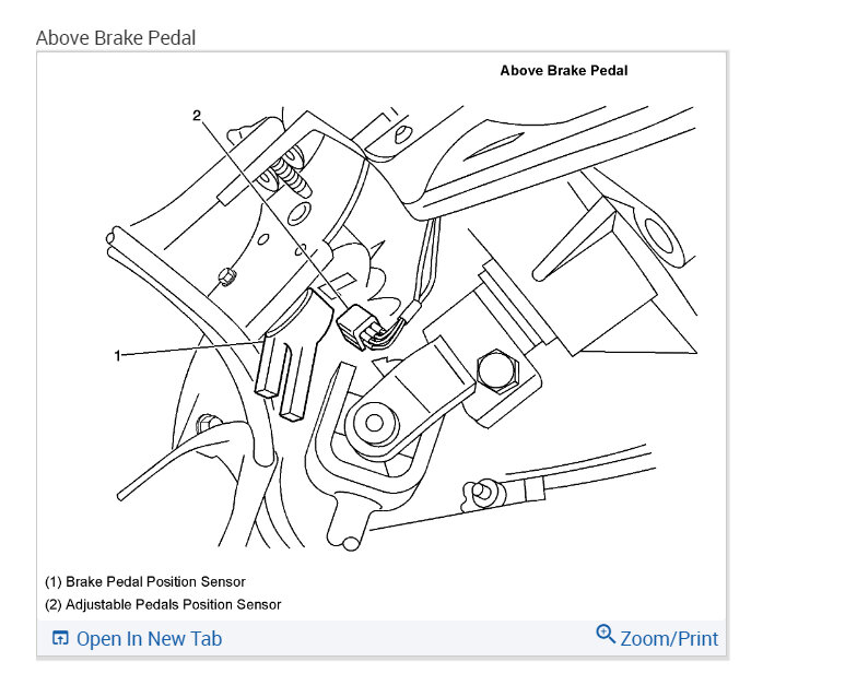

Sometimes my car won't come out of park after starting it. I shut it off and wait about 15 minutes then it will come out of park. They tell me it's the brake light switch. A diagram showing me where it is at would be helpful. Not just saying top of brake pedal. Thank you for your time.

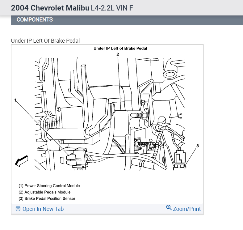

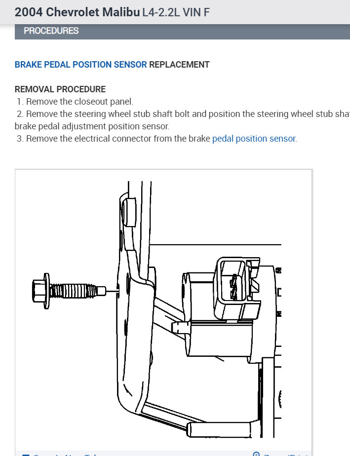

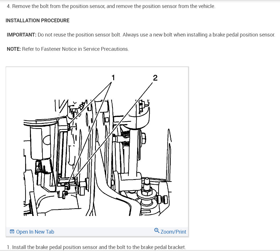

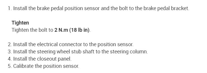

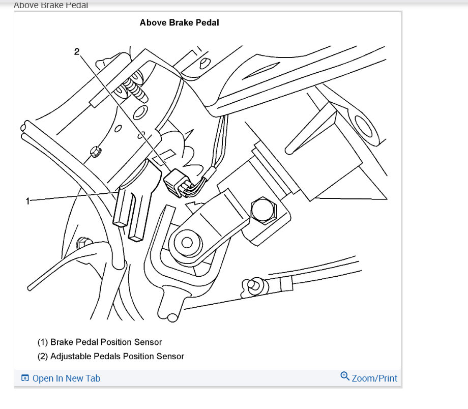

That does help, here is the location of the switch and how to change it out in the images below.
