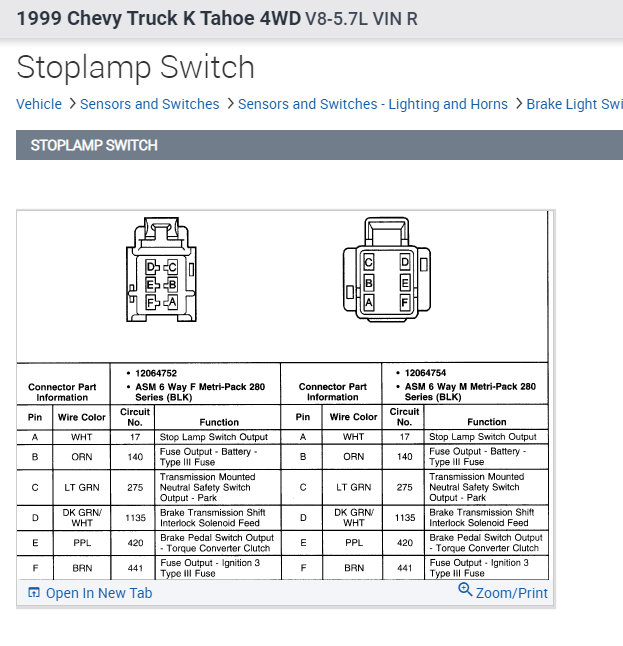

I can't find out where the six-pin connector connects to on the brake light switch.

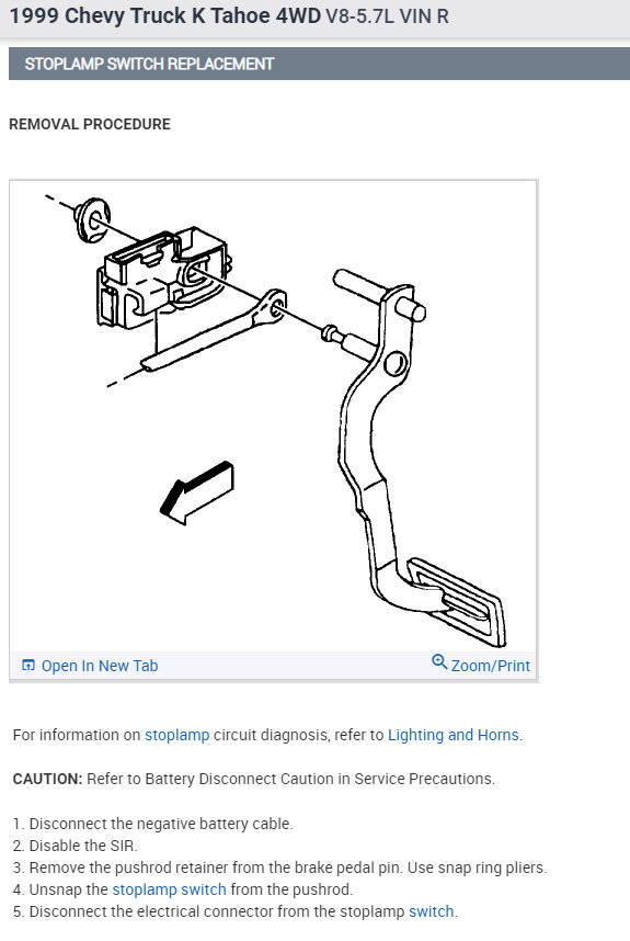

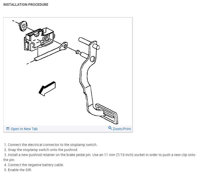

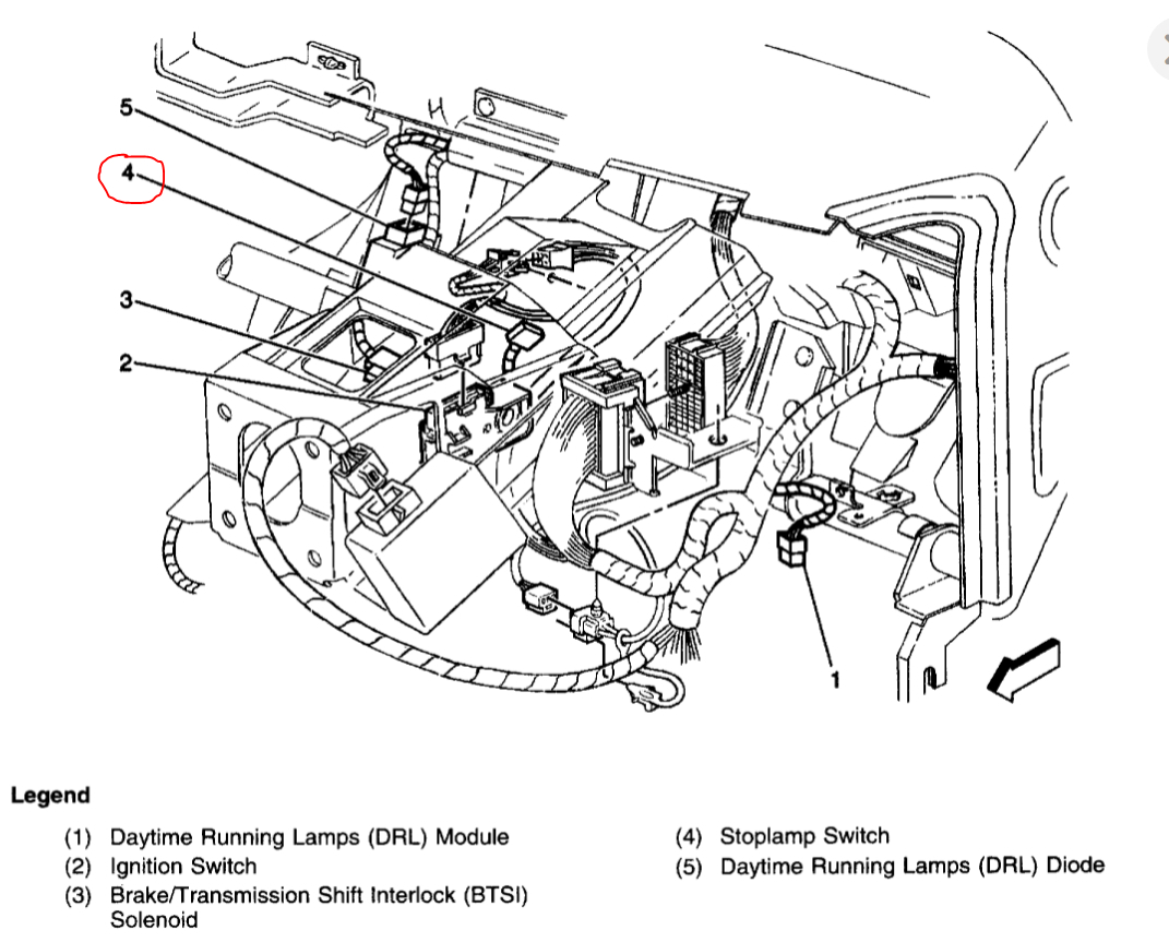

So, are you having hard time finding the actual pigtail that connects to the brake light switch or the harness is ripped out and cannot locate where it will go?
I have attached some diagrams showing the harness location.
Let me know if this is what you are looking for.
