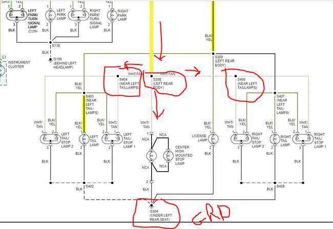

If the third brake light is working and the bulbs are good, you need to check a couple things. If you look at the schematic I attached, you will see the brake light wiring. I have arrows showing where the power comes from and where it is going. Note that the third brake light gets power from the same wire as the tail lights, so if they aren't working, either you have a bad splice in the wiring (which I circled their locations), or a bad ground for the side lights.
Here is what I need you to do. Note the power supply for all brake lights is a white wire with a tan tracer. I need you to locate that wire on each side and check if there is power to it. If this happened all at once, I suspect the first splice is the issue or the ground. But we need to check for power at the lights and work backwards to see if we can determine where power is lost.
Additionally, if you find when using a test light or volt meter there is power, you will have supplied a new ground. In this case, check the black wire for continuity to ground.
Sorry about the sloppy writing on the schematic GRD is the ground. I can't write with a mouse pad. LOL

You are very welcome. Let me know what you find. Also, does my reasoning make sense to you? If the third works, there has to be a break down between the two where they splice or where they ground.

Yes, you are correct. Basically when you attach the negative side of the test lead to a grounded component, you created a new ground. So, do exactly what you said to check for power to the white/tan wire. Make sure the when checking for power that someone has his/her foot on the brake pedal.

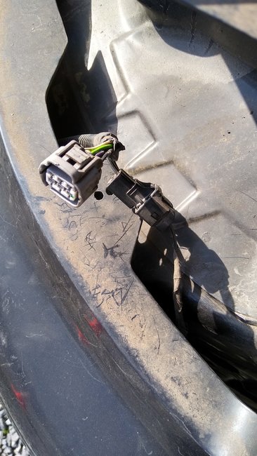

Hi, found 11.5v at white/tan.
Grounded to a bolt.
High winds today! Pic of left side.
Apr 10, 2020 at 7:18 AM

11.5v at both white/tan.

Is that when you provide the ground via your test light or multi meter? If it is, did you check for continuity to ground via the black wires? If you have a good ground, then the problem will be the socket itself. If there is no ground, then we need to check that.

Let me know what you find. Also, you don't need to remove the rear seat unless we find an issue with ground. Take the multi meter and place on an ohms setting. When you do that, it is checking for resistance. If you tough the multi meter terminals together, it should show 0. To check continuity, set the meter as mentioned and simply place one terminal on the black wire and the other on a known ground on the vehicle like you did with the test light. If there is continuity to ground, you will get a very low reading on the MM. All you are doing is checking that power goes through that black wire and you can read it through the bolt on the body. Your MM will have an internal battery for checking Ohms.
Let me know what you find. If there is no continuity and it is hard to remove the seat, we'll make new grounds, one for each light. Not a big deal, but I would rather not have to go that route.
