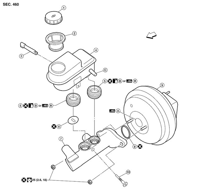

The brake panel light and the slippery light stays on when driving.
Nov 2, 2018 at 11:07 AM
  • 110,244 POSTS

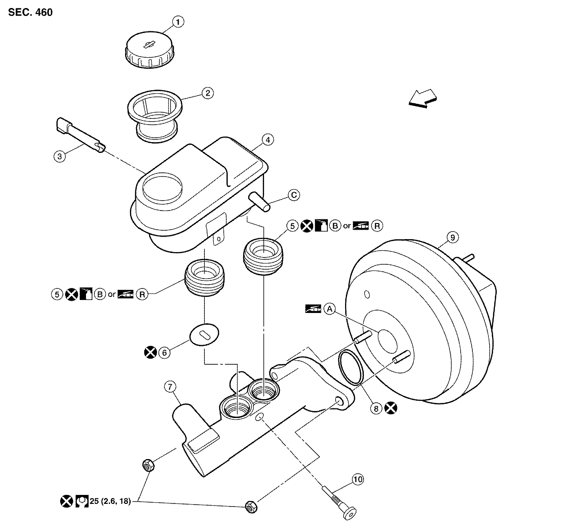

The first thing I need you to do is confirm that the brake fluid is not low. If it is, refill it. Once it is low enough, the brake light and ABS/traction control light will come on. The brake master cylinder is under the hood and mounted to the firewall on the driver's side. I attached an exploded view of what the part looks like. There is a white plastic reservoir with brake fluid in it. Make sure the fluid level is above the minimum line. Also, read the top of the brake fluid cap to determine if it requires DOT3 or DOT4 brake fluid. Only use what is recommended.
Do that and let me know what you find. Also, if this is not the issue, let me know.
Nov 2, 2018 at 12:21 PM
CZELLNER
Joe this been going on for a month now, but yes the brake fluid is filled properly, but the lights stay on. What could be the problem now? My guess is the master cylinder gone bad. I have to refill brake fluid weekly.
Nov 2, 2018 at 10:46 PM
  • 110,244 POSTS
Hi again,
You did not mention refilling the fluid on a regular basis. That could be the result of a few different things. First, park the vehicle and pump the brakes several times. Check under the vehicle and behind the wheels to see if there are any wet spots, which would indicate a leak. Areas to check would include brake calipers, rubber brake hoses attached to calipers, and although it is unlikely at this point, steel brake lines.
Next, open the hood and inspect all around the master cylinder. If no leaks are present, then there is a chance the master cylinder is the problem. Often times, they will leak from the rear of the master cylinder and the fluid will go into the brake booster.

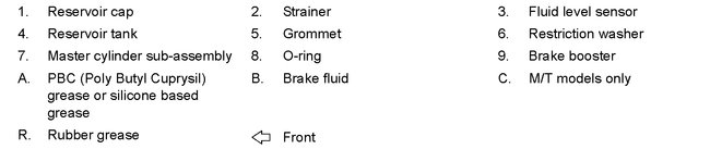

Also, inspect the master cylinder plastic reservoir where it mounts the master cylinder as well as the level sensor. If you look at picture 1, you will see sensor location.
If you determine that is what is happening, here are the directions for replacing the master cylinder.

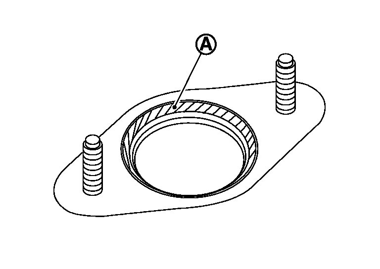

- Apply silicone grease to the brake booster at position (A) as shown, be sure the O-ring is in proper position when installing the master cylinder assembly to the brake booster.
